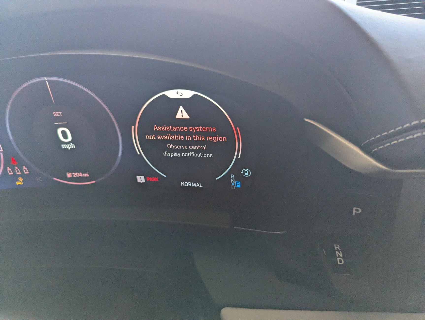

Mine is doing the same. The car thinks it's 2 miles off from where it actually is. I even drove it around a little and the map shifts with it (i.e. stays 2 miles off). I tried the nav and it thought I was different roads than I was on, tried to tell me to turn where there wasn't a road, etc. GPS detects movement correctly, but the software isn't translating that to the correct map location. Even the app is showing the car in a different location than it is (a good way to tell if it's still messed up).
Many settings in the car that rely on location data are grayed out. And the speed limit indicator is missing.
The Assistance Systems Error seems to be just a symptom (missing correct road data so it's making itself unavailable to use). The cause seems to be the location services being messed up. This message pops up just for a few seconds before the Assistance Systems Error that stays. The car seems to think it's in the wrong region.
