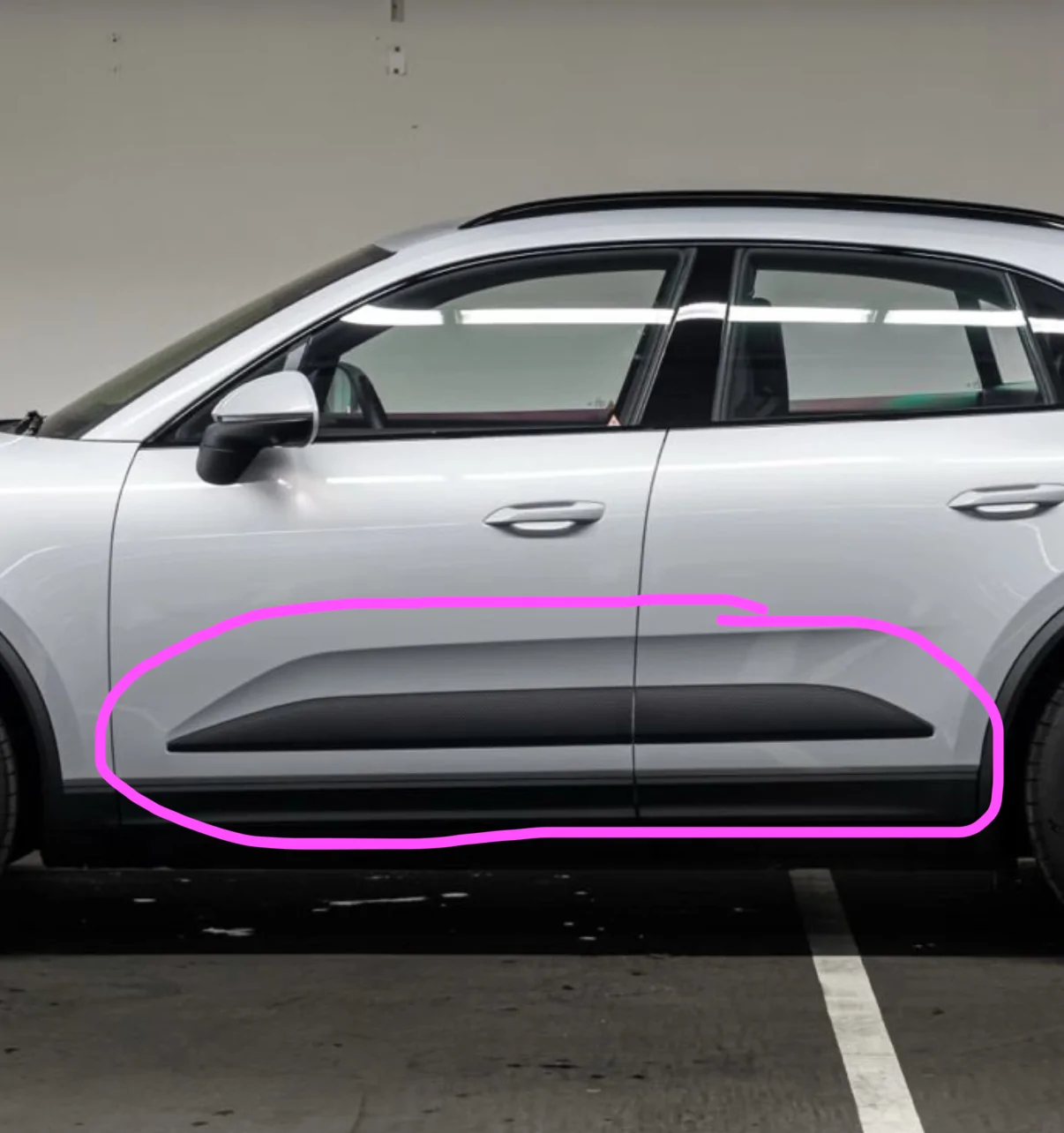

I ordered my Macan as a demo from the dealer and for that reason I wasn't able to choose the side blades in the exterior color. The blades on my Macan (see attached picture) are the basic plastic side blades (with the 'bumps' on it) and, what I think, unable to paint. Also I'm considering to replace / paint the wheelarches in exterior color.
Did someone already did these mod(s) and what is a good site to finds partnumbers? For example, for BMW I always use realoem.com.

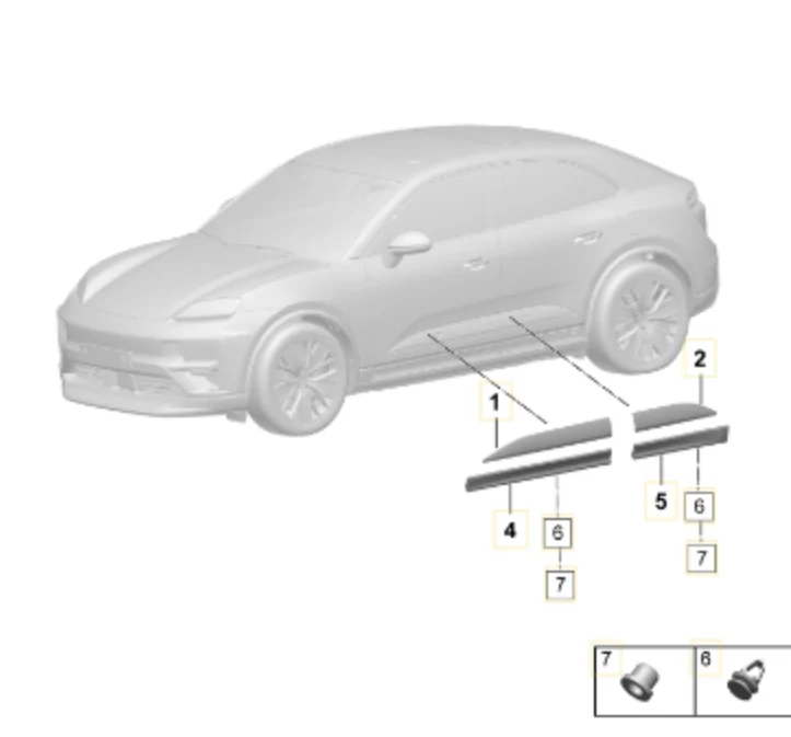

Those parts are not painted, they are just primed - you not then finish them in black gloss or your exterior paint color.
Blende grundiertfront left (1)95C837899HYG2X
Blende grundiertfront right (1)95C837900HYG2X
Blende grundiertrear left (2)95C839899HYG2X
Blende grundiertrear right (2)95C839900HYG2X
Those parts can be delivered on short notice. It is recommended to order the adhesive tape along: V04015800A.

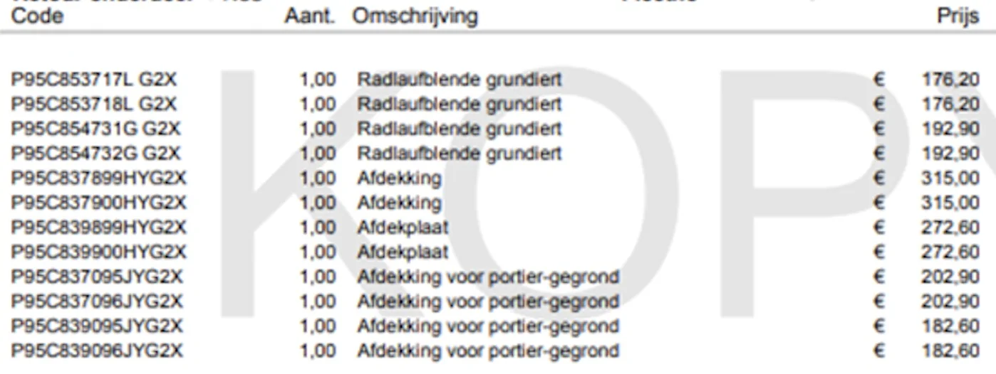

Got some info from the dealer here (Netherlands) for all the parts to get the car completely in body color!
Electric Macan EV Retrofits; side blades, interior and logo's! Scherm­afbeelding 2025-08-29 om 11.16.23
1. The first 4 lines are the wheel arches (FL, FR, RL and RR).
2. Line 5 until 8 are the panels on the doors (FL, FR, RL and RR) as @xkrblr already wrote.
3. Line 9 until 12 are the lower parts under the doors.
I can get 15% discount on the parts at the dealer, but I'm searching online for better prices! If someone has a good supplier (in Europe), please let me know :)

I did the side blades a month ago - there is nothing special about it; except you really need the tape to install it.

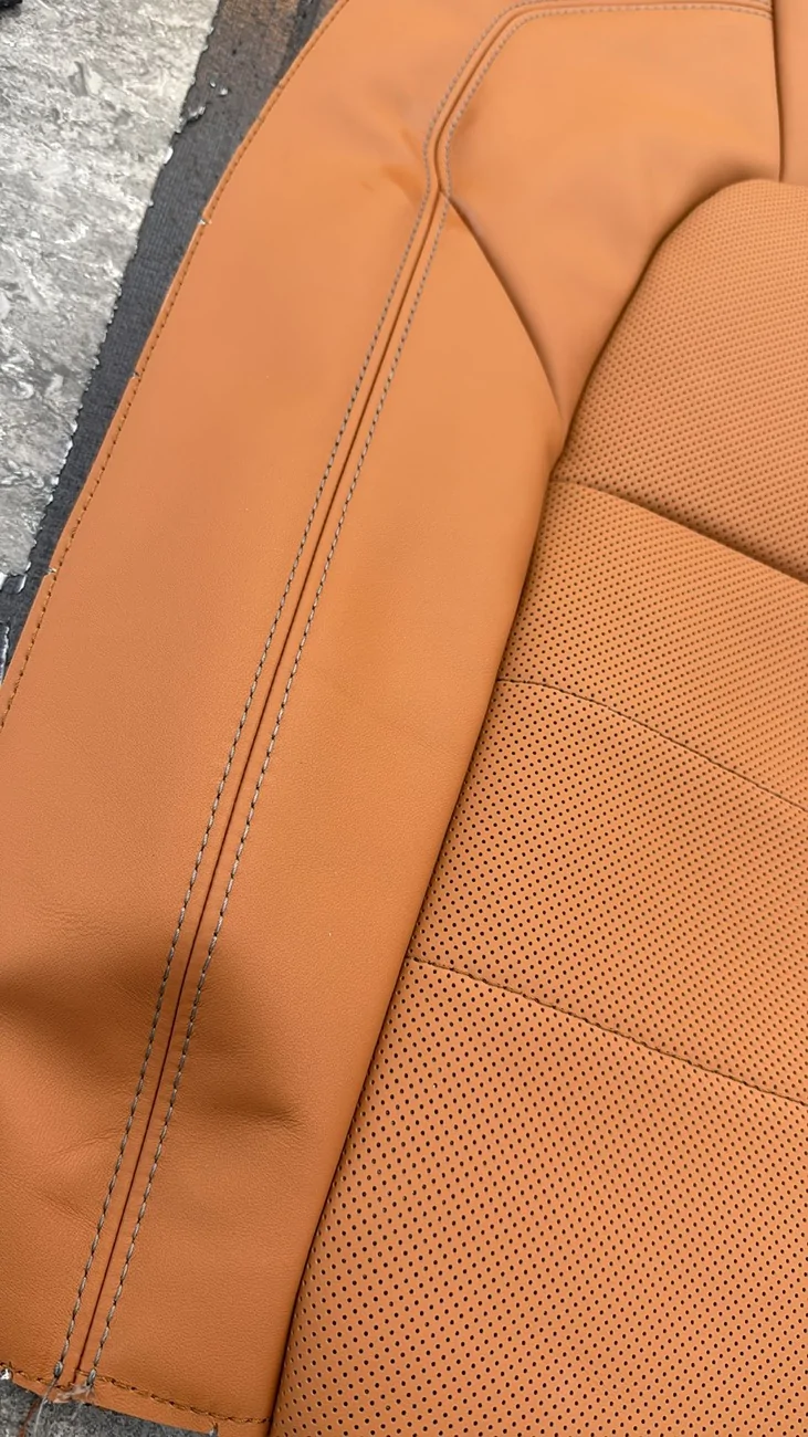

Apologies for my delayed response! I have decided to start with the door strips and perhaps later the edges near the wheel arches.
However, the interior will be thoroughly redone! The vehicle is currently at an upholsterer who is installing an Exclusive interior. In terms of color and style, it will be similar to this Cayenne: https://www.coolsbekledingen.nl/automotive/alle-modellen-cayenne/porsche-cayenne-turbo-s/.
I have the extensive black leather package, and my dashboard will remain as it is. The center console will be done, though. Expecting the car back in 2 weeks!
