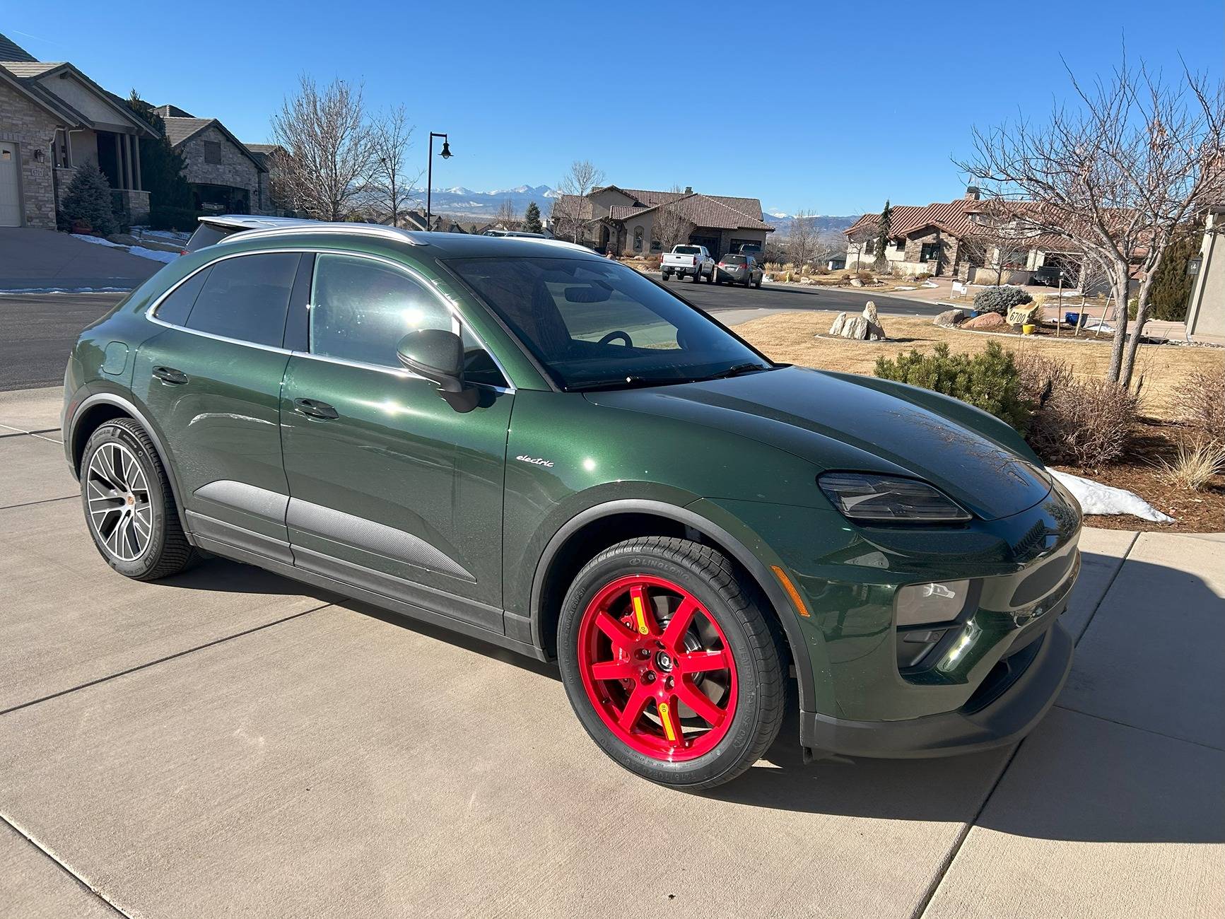

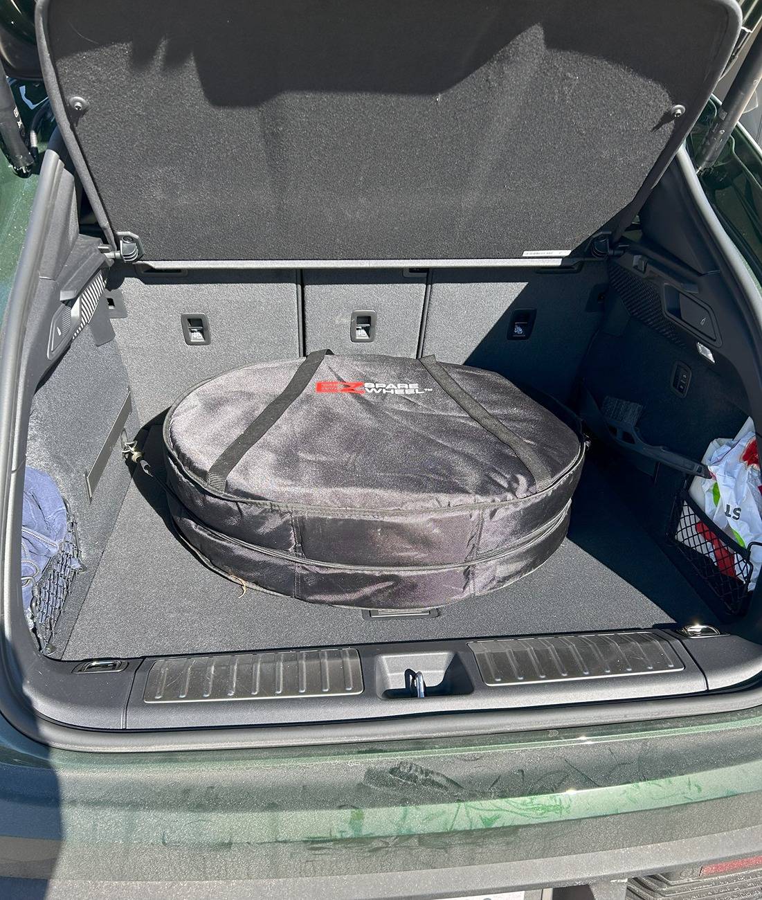

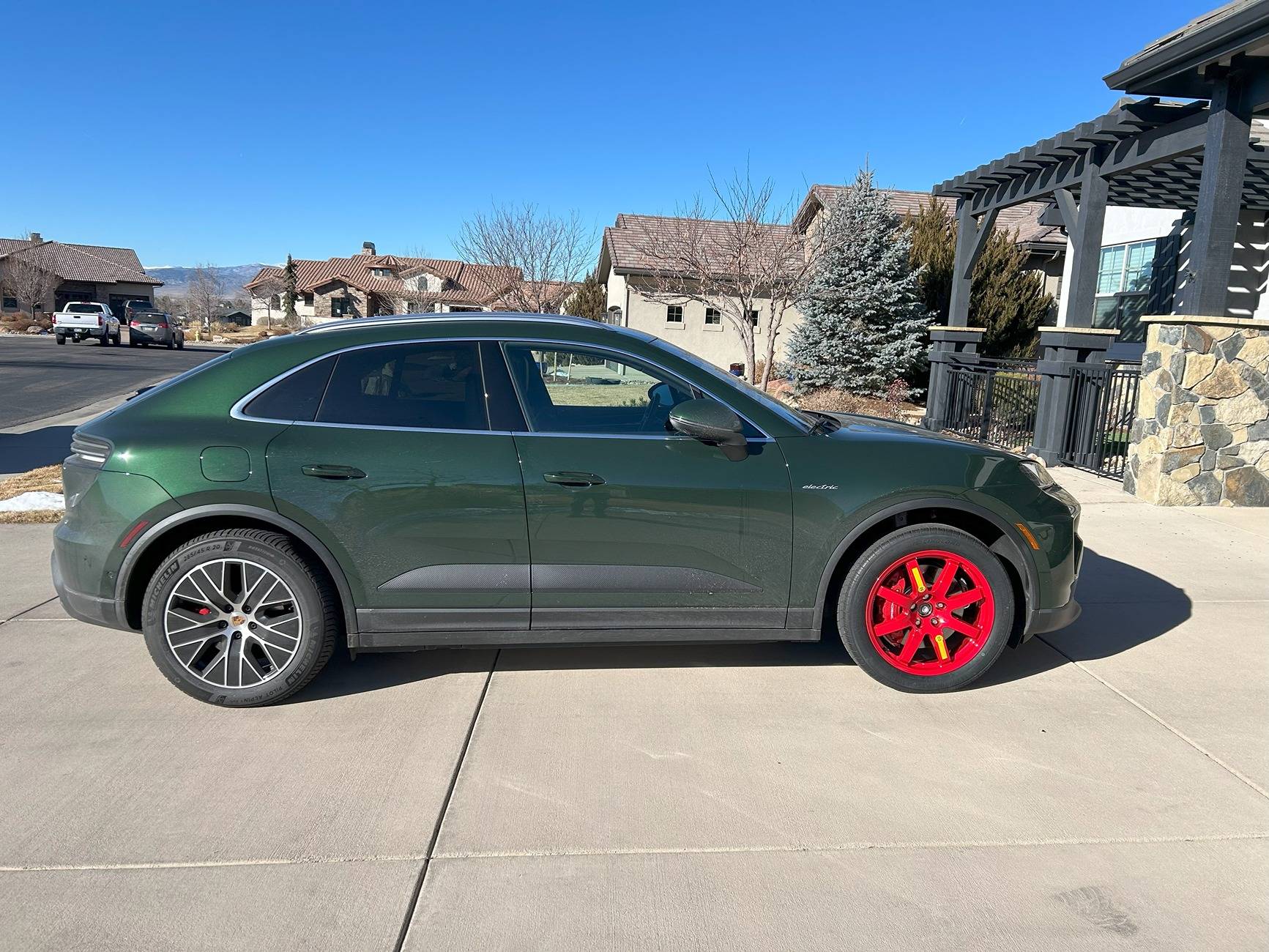

Not having a spare tire doesn't sit well with me as I travel into the mountains without cell service. I know the Macan EV comes with a can of fix-a-flat and a compressor as well as road side assistance but I prefer more options. I carry a plug kit, jack, and torque wrench. I just added a spare from EZ Spare Wheel
If you reach out to them ask for Ginny, she was very helpful.

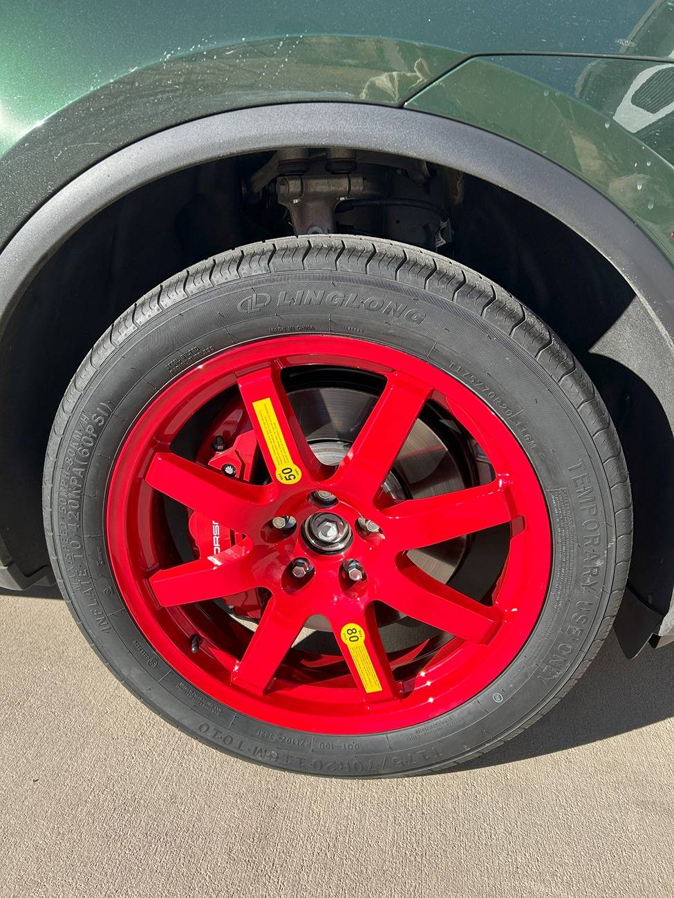

It's a 20" wheel with a 5 x 130 bolt pattern and a T175/70R20 tire as well as 14 x 1.5mm lug bolts. Yes, I'm giving up trunk space but it's worth it to me.
Electric Macan EV Spare Tire found! EZ Spare Wheel Installed Spare Tire 1
Electric Macan EV Spare Tire found! EZ Spare Wheel Installed Spare Tire 2
Electric Macan EV Spare Tire found! EZ Spare Wheel Installed Spare Tire 3
Electric Macan EV Spare Tire found! EZ Spare Wheel Installed Spare Tire 4
