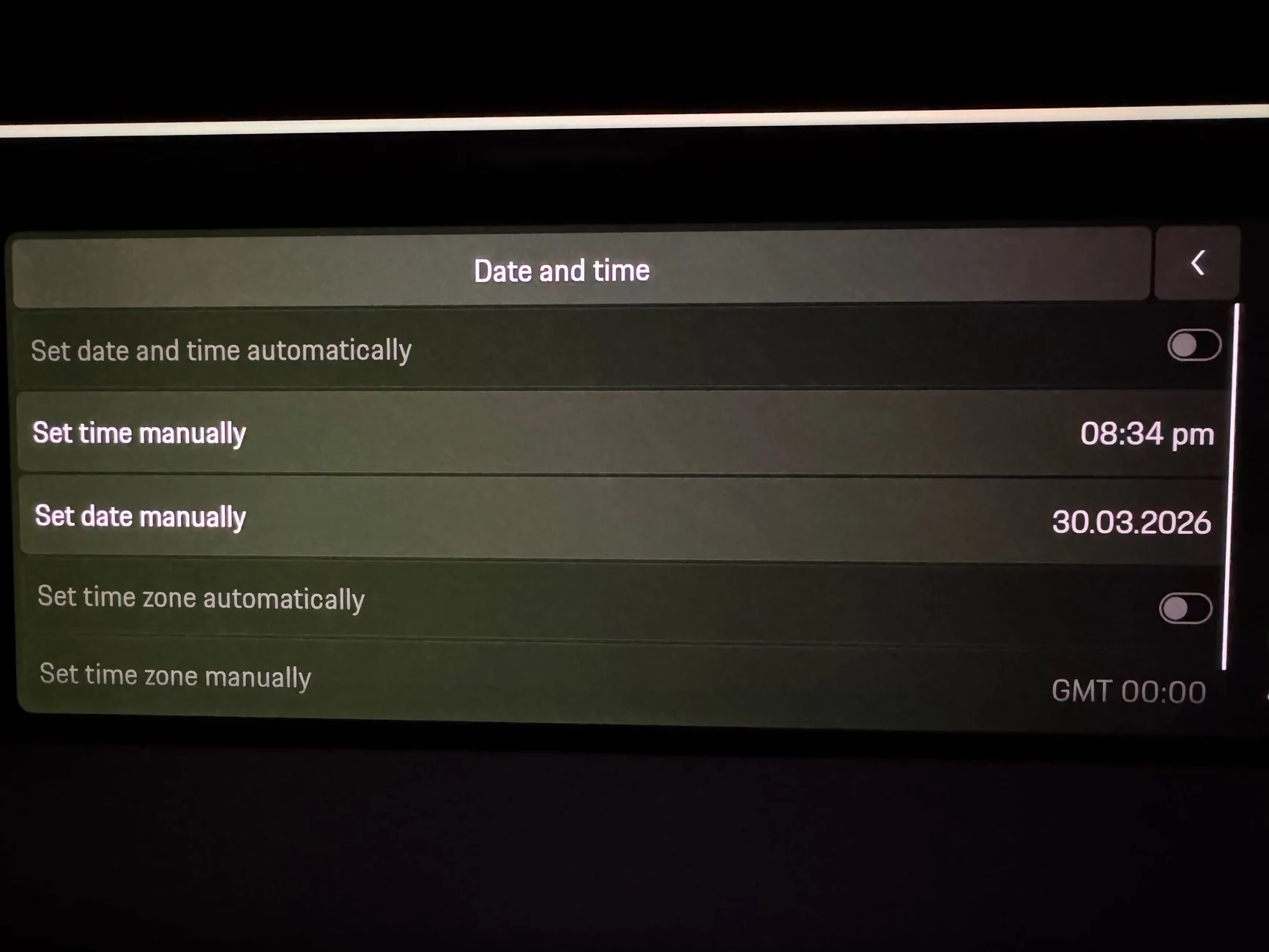

Any idea why auto time and time zone would be unavailable. Both greyed out with an error when trying to select saying not available. Car is stopped and in Park.
Electric Macan EV Can’t set auto time IMG_0392

I would first guess that you are in private mode, have the network disabled. Alternatively, does the map show the correct location, are there GPS signal issues? Those would typically be the two ways for the vehicle to automatically set the clock.
