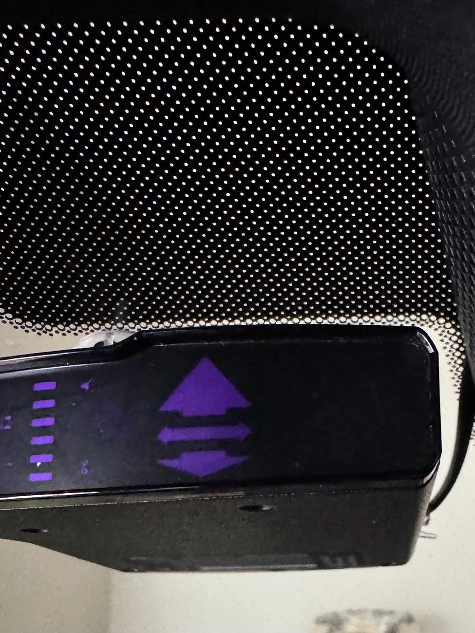

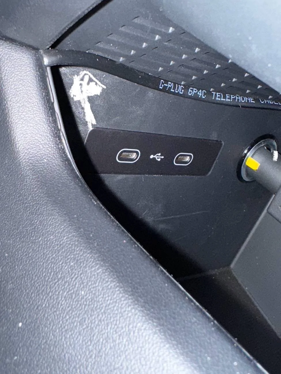

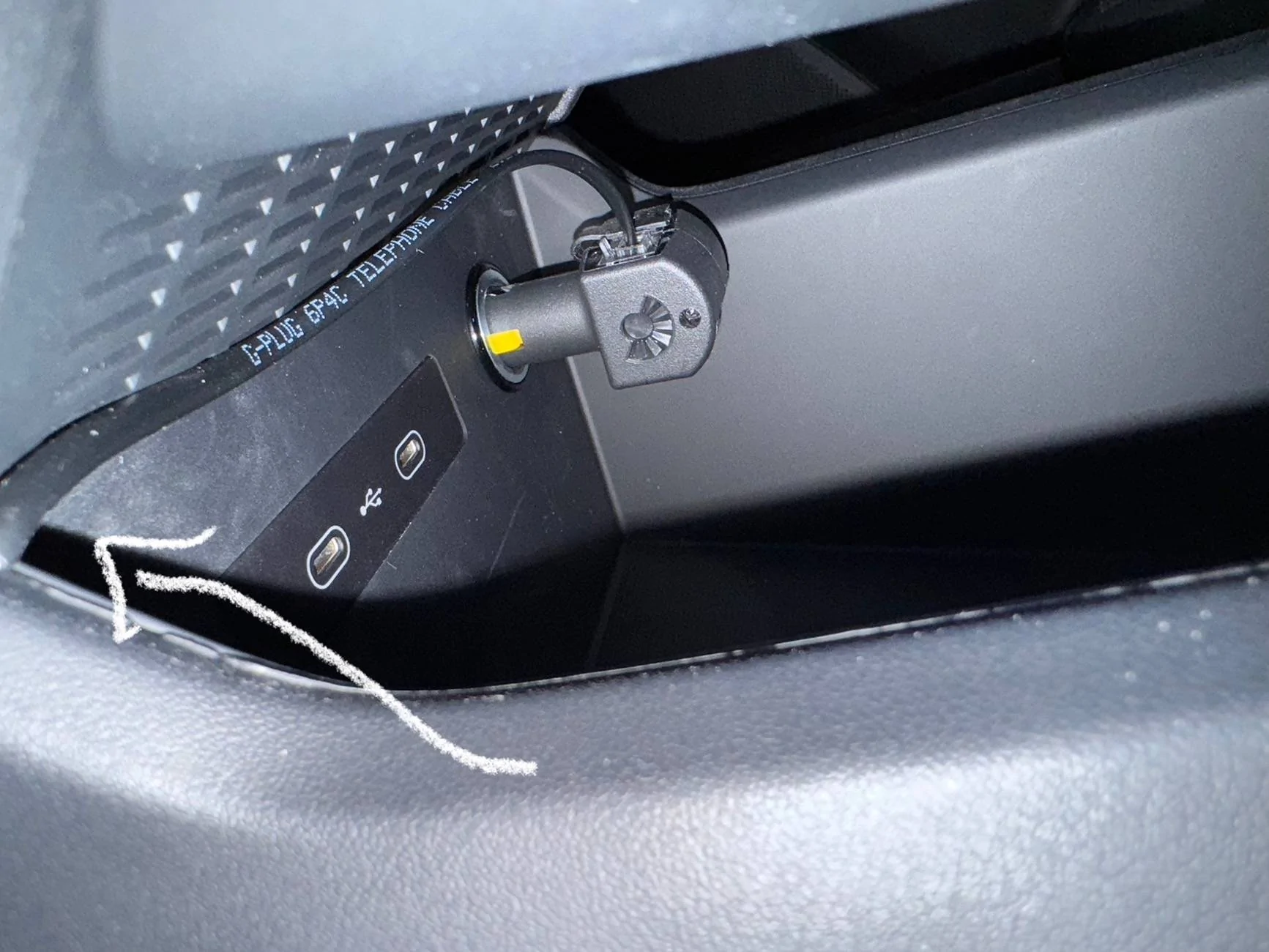

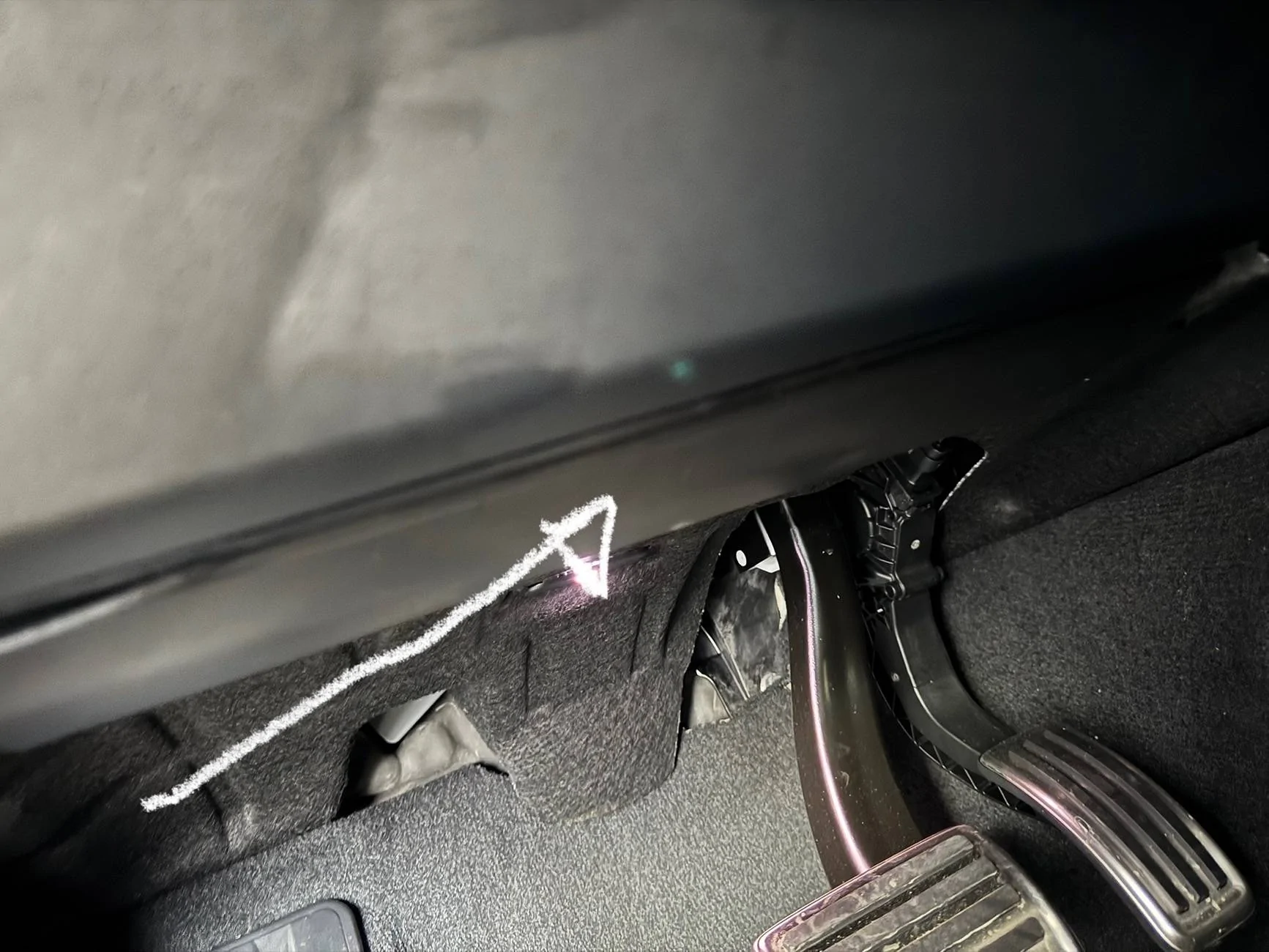

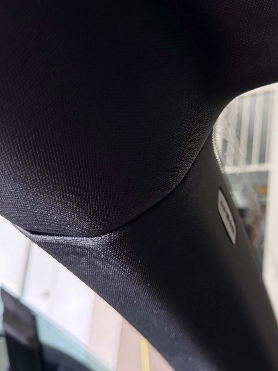

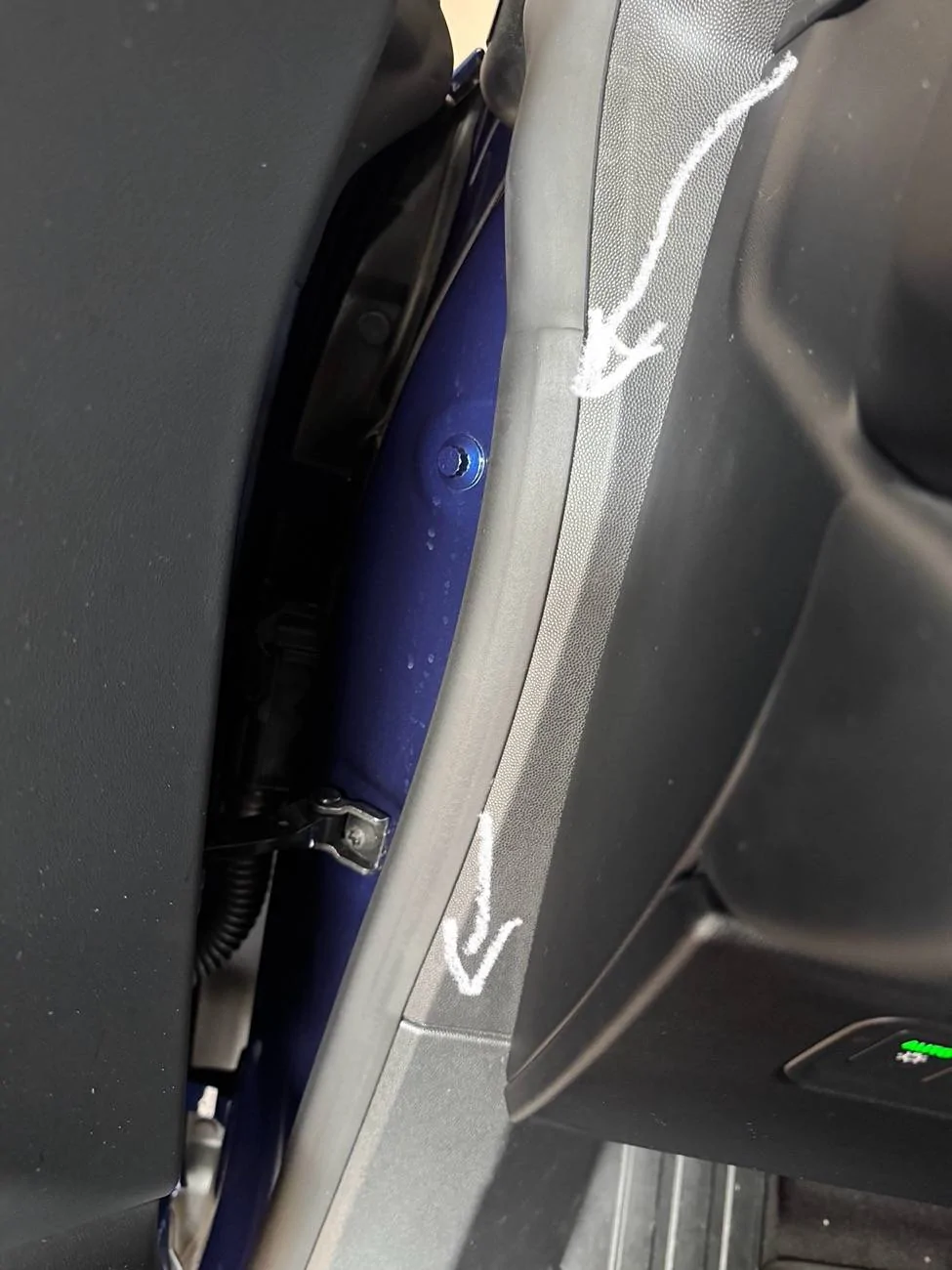

I managed to take a regular RJ-11 cable from the 12 volt plug to the radar location as shown.
It is a plug to radar without interfering with car fuses or wire tapping.
Works perfectly so far. The cable is a 10 feet that I got from Amazon. You can use a 10 or 15 feet. 10 feet cable is just the distance. Be careful when trying to pass the cable through the center console left side cover. It has small rubber caps for proper realignment.
Hope it works for you.
