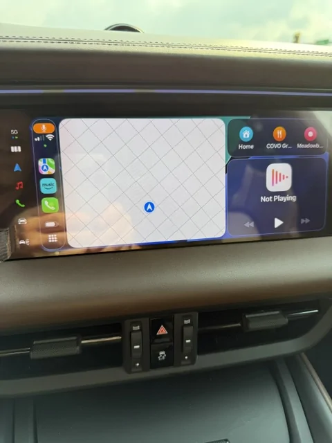

Just recently my Macan turbo began to exhibit connection issues with my iPhone. The issue is limited to the CarPlay feature and not the voice or media functions of the iPhone from the PCM. The behavior applies when the iPhone is connected to the PCM via WIFI, if I connect the phone with the USB-C port the CarPlay works as expected.
Initially my phone would connect wirelessly to the Macan_xxxx_5GHZ network and CarPlay would work for a few minutes after which I would loose functionality as such:
- the apple map would no longer display the roads/POIs, etc. I would only see a blank grid.
- access to email from the iPhone would no longer work
- browser would no longer work
Eventually I would get a message on the phone asking to switch to cellular of continue on WIFI.

A few questions that may help narrow things down a bit:
  • Do you have the latest version of iOS?
  • What iPhone do you have?
  • Did you do a recent iOS update?
  • Do you happen to have iPhone private rely enabled or VPN? If so, temporarily turn them off and try again.
  • Do you have Wi-Fi Assist enabled on your phone? If not, enable it.
  • Do you have a second phone you can test with by any chance - that will help rule out device vs vehicle-specific issues.
  • Also have you tried to forget your wifi network from within your phone and re-adding the Macan 5Ghz network - not just forgetting the device from the PCM?
