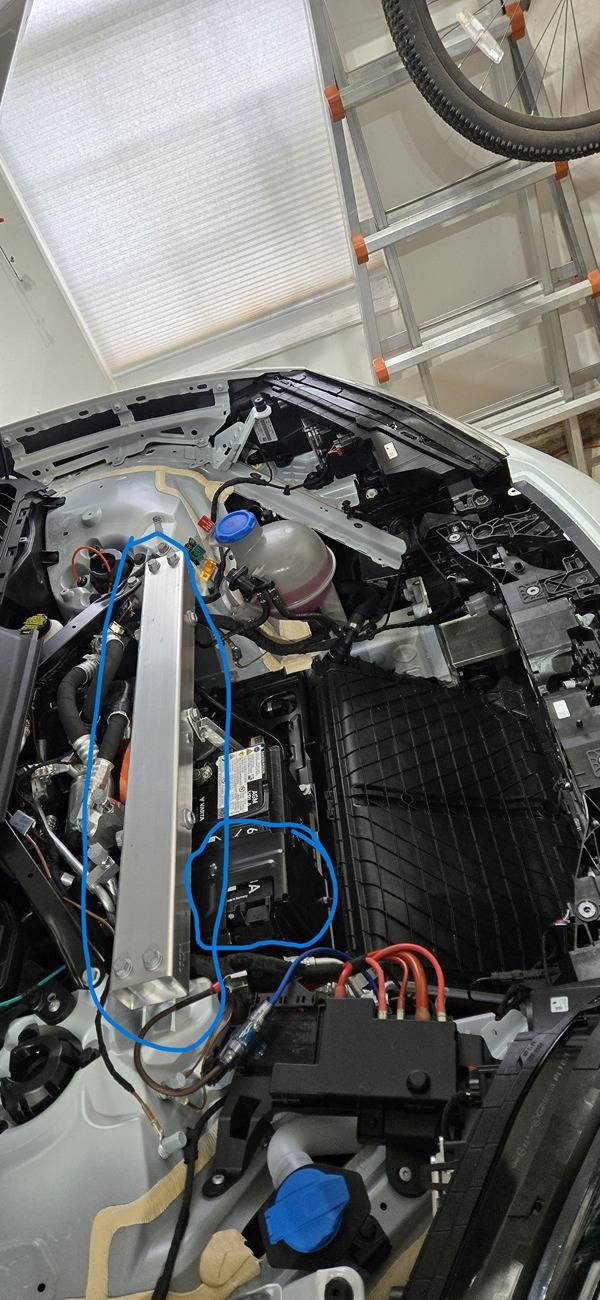

i just took the car apart to get access to the battery...and it's beyond a pain. It's truly NOT designed for owners to access. All the frunk needs to come out as well as the crossbar for the chassis! However, there is a fuse relay you can without hooking on the battery itself...but at that point, the only work youre saving yourself is taking off the cross bar cuz you still have to remove the whole frunk to get that relay...
what exactly where you trying to do that you needed direct access to the battery? there are post in the trunk and in the front bumper you can attach to charge the batter w/o taking the car apart?
but otherwise, the take the whole frunk apart to access the battery, you need nothing more than a plastic pry bar thingy for all the clips, a 10mm socket, and 20 torx

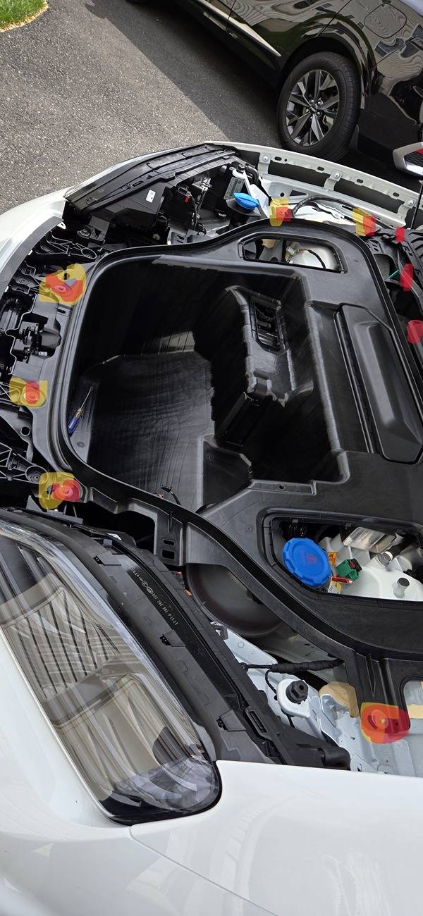

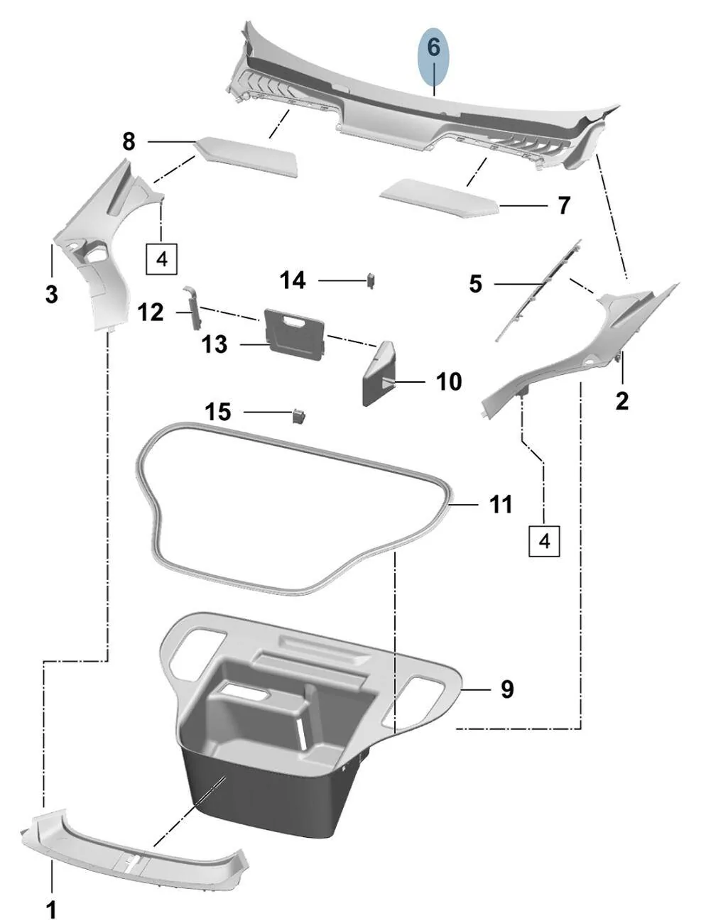

Take off all frunk plastics. Start with the rubber ring.
Electric Macan EV Documents needed to assembly / Disassembly. Screenshot 2025-04-20 110734
Everything is pull/pry or held in with pressure clips.
12 & 10 are under the felt liner. 14 & 15 are the light and emergency release that go through the felt liner and must be released before the felt liner comes out.

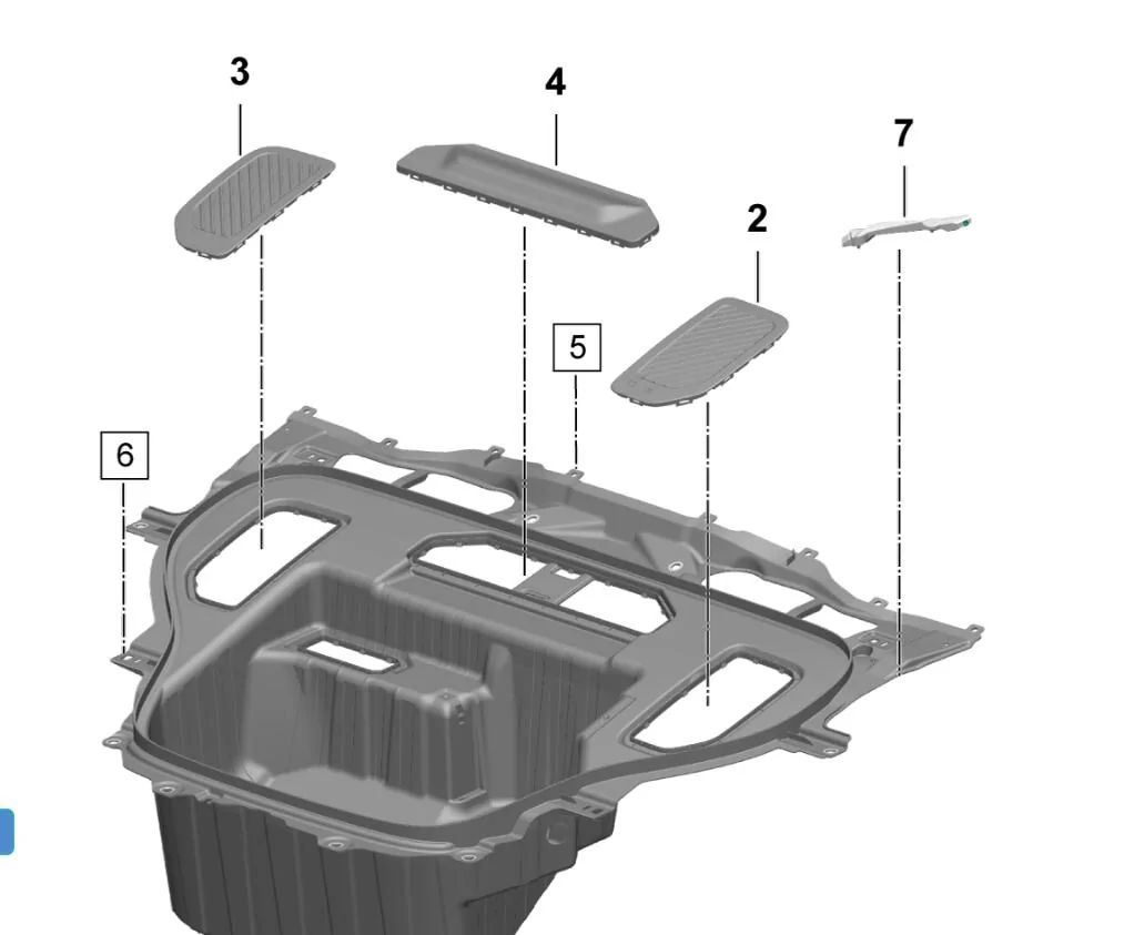

Once you've got all the frunk plastic out, you're left with the frunk bucket.
Electric Macan EV Documents needed to assembly / Disassembly. Screenshot 2025-04-20 111629
This is alllllll one piece that cover the entire bay...

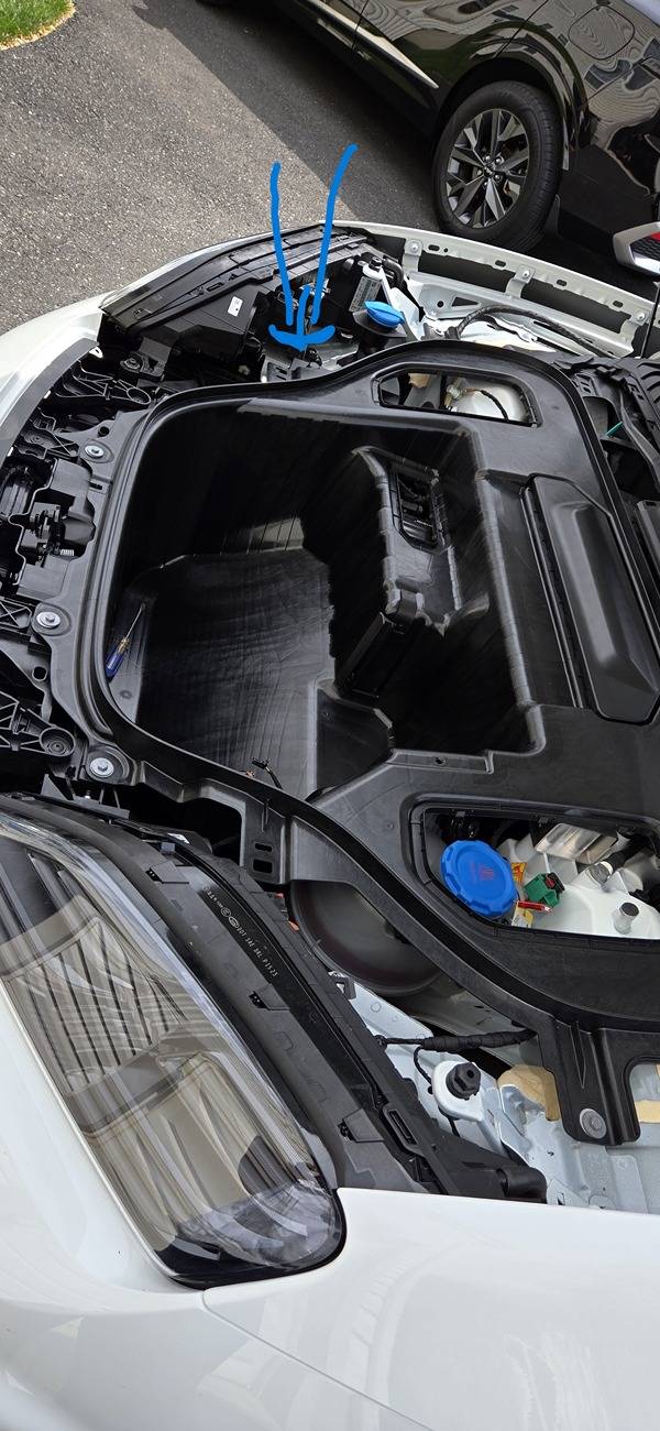

Now, this should be all would need to do (in a perfect world)...the relay is visible at this point, but I think the bucket block you from opening it all the way.
so now you would to proceed to remove the bucket.
it's held in by about 10 10mm sockets and 8 20T screws.
those 20T screws are hidden under the cowl/wiper panel. You will need a VERY low profile tool to unscrew them without taking the cowl/wipers off.

Once the bucket is out, you'll almost home. I would suggest using the relay instead of direct to the battery because the battery cover it blocked by the suspension cross bar.
both will need to be removed
Electric Macan EV Documents needed to assembly / Disassembly. 20250421_151557
OTHERWISE you can hook up to the relay which is now fully accessable. there's an unused bolt as well. and you can connect to the ground termin as well, which is not blocked, or ground to one of the other billion grounds in the frunk .
