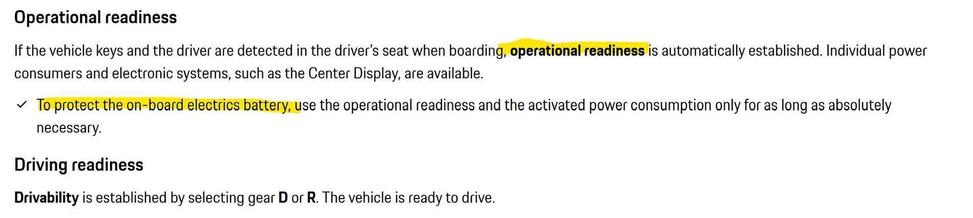

Most likely the car turned itself off after 30 minutes. This is expected operation if you are in Park and in Operational Readiness state (electronics only on mode) powered by the 12V battery. Macan EV manual is not specific after how many minutes it will turn off the car, but 30 min is the time on a Taycan to stop 12V battery power draw.
