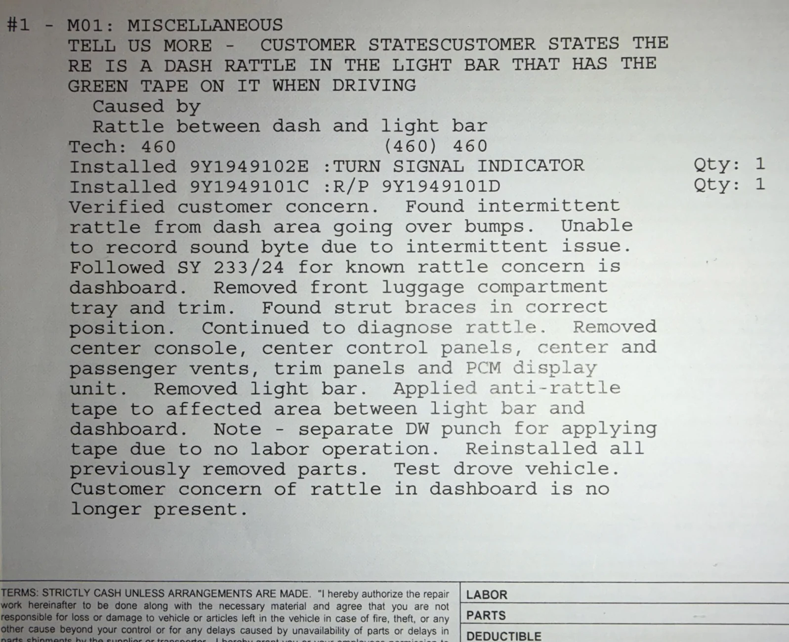

You are welcome. It was reported to be a fairly major undertaking, requiring removal of the passenger display and dash.

I missed this other thread, not realizing there was a separate forum for issues.
My Macan EV was in for a 6-day repair, with most of the delay due to recall issues and software updates, plus a second trip to the dealer to re-program the key that was reprogrammed with the software updates. The tech "forgot" to mention that both keys need to be present after the software update or one will not work.
The rattle is now about 65% improved, but still clearly audible in the exact same spot, so I will be headed back again for a second try at the repair. Three trips to the dealer in less than 10 days is an incredible waste of my time. It's not surprising though, as they forgot to order some parts for my long-scheduled warranty service last year too.

Same issue. My dealer - cherry hill porsche in NJ - said they ordered a front trim part in November to fix the problem. When I called mid December and mentioned this thread, I got a bit of attitude that the techs know what they’re doing. Still waiting for the part to come in. Imagine on a $100k car and tape is the solve??
