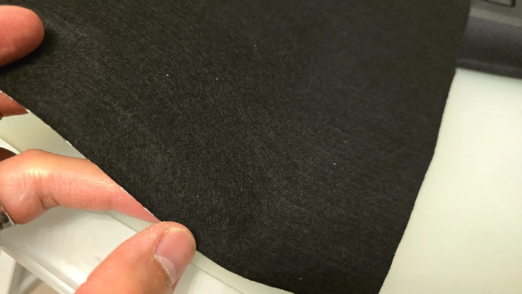

I fixed the rattle in the dashboard myself.
My light bar on the passengers side would rattle when the car is cold. I wedged some adhesive backed plastic in there. I cut a piece out unpeeled the adhesive and folded it back on itself to make it thicker. I tucked it into the light bar using a credit card, need to jam it until it goes all the way through.
I used the same fabric on the B pillar to stop the seat belt banging too.

Do you have a link to the stuff you used?

Almost the same that the dealer did to mine. They used some kind of felt.

after being gas lit by my dealer and also not having time to lose the car for several days (no loaners anymore from west london anymore due to "abuse by customers of loaners"). i fixed myself. very similar. used foam silicon 1.5mm cord https://www.amazon.co.uk/your-order...pmentId=UN6F4m95f&packageId=1&asin=B0CZ956Y1T with a ifixit phone plastic tool to pauh in gently used two lots from far near side strip with door open to mid dash. no more rattle. boom
