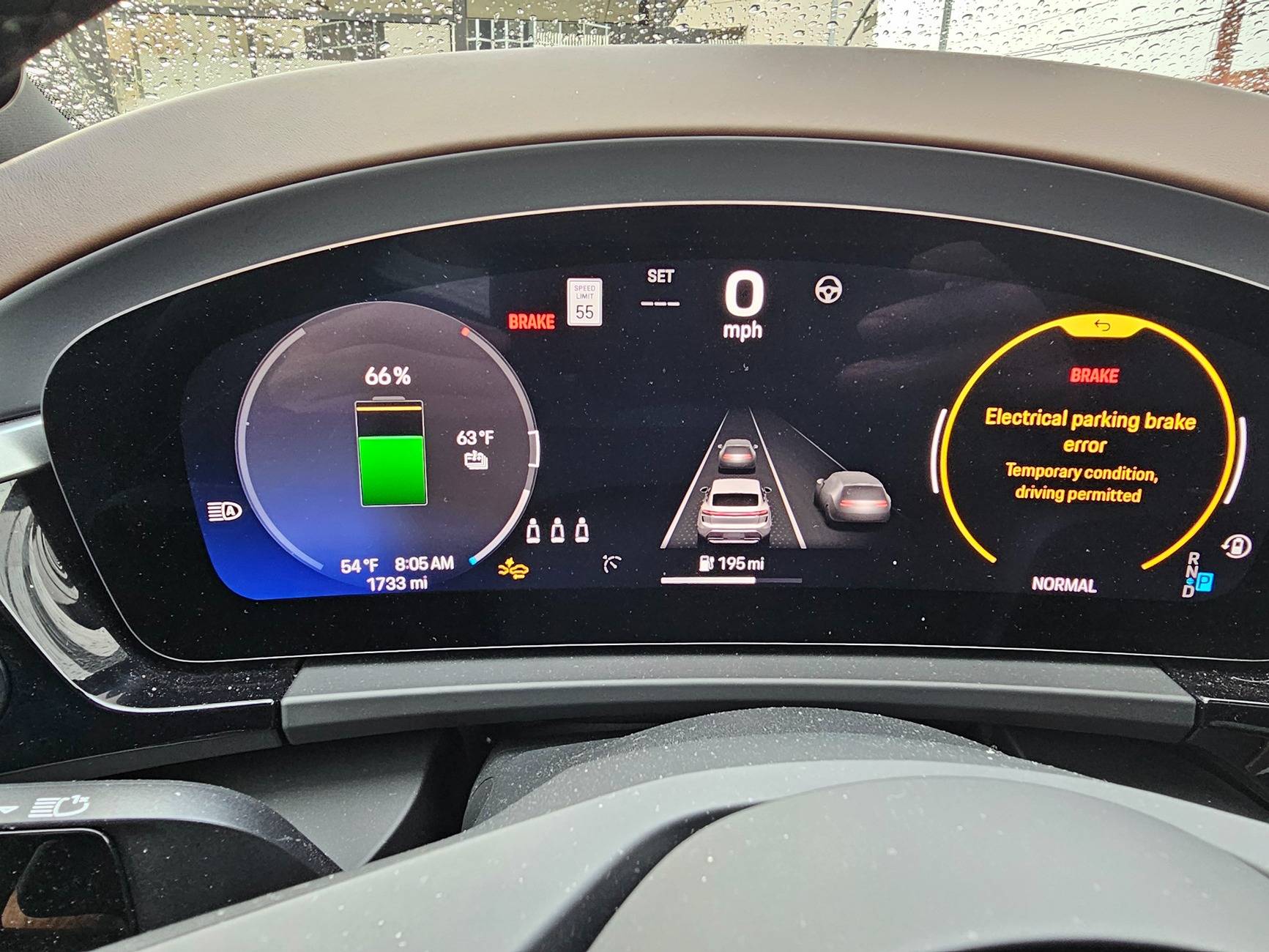

Last night I received my car off the auto transport truck.
Since then, I have this message.
Any ideas how to remedy?
Thanks!

Turn car off completely. Keep fob away from car and leave car sit for 30 minutes. Then go and activate car and most times these errors clear themselves. If not then take car in and they can capture the active error code to troubleshoot a fix.
