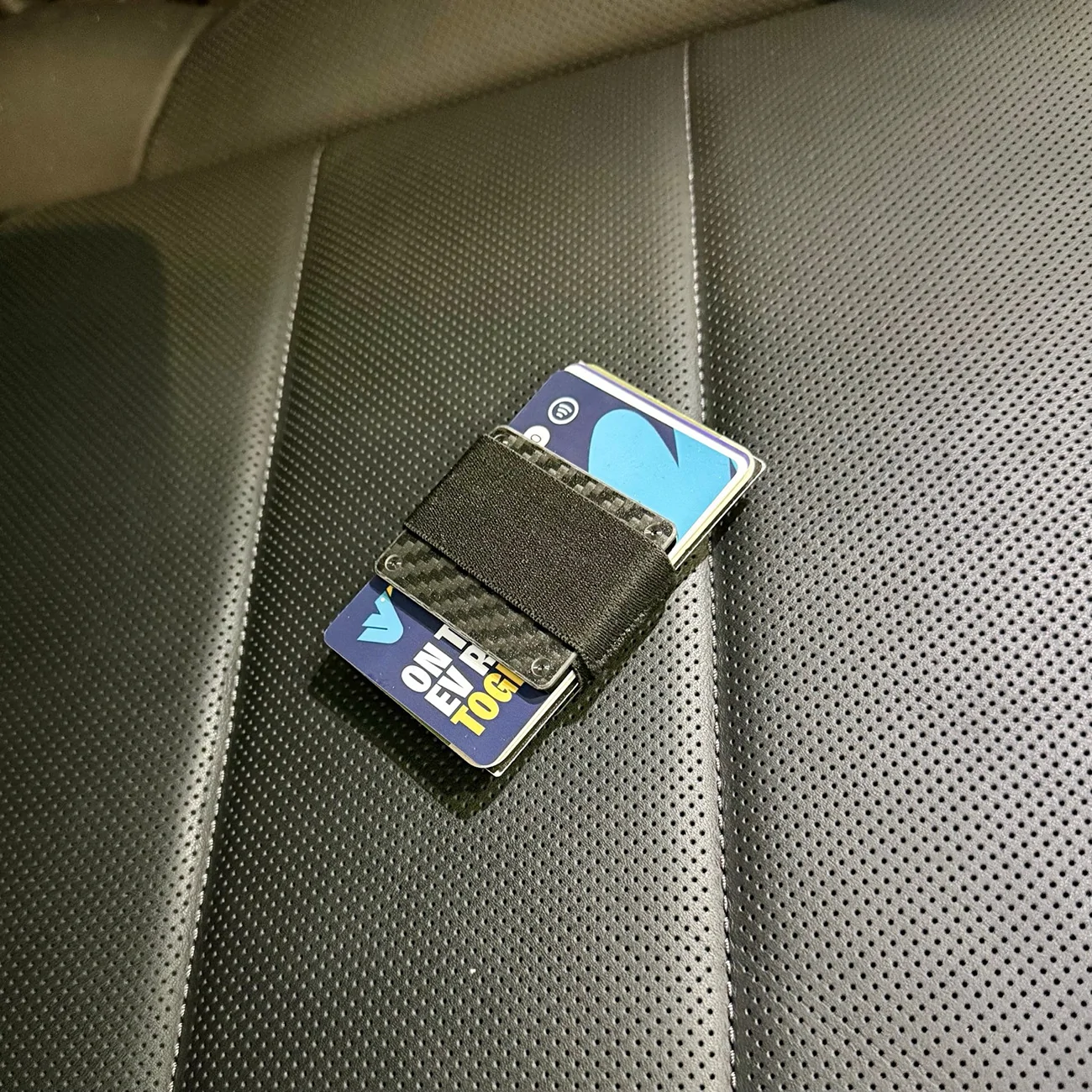

Electric Macan EV High Drama at Public Chargers [Aus] ridge wallet with EV RFID cards

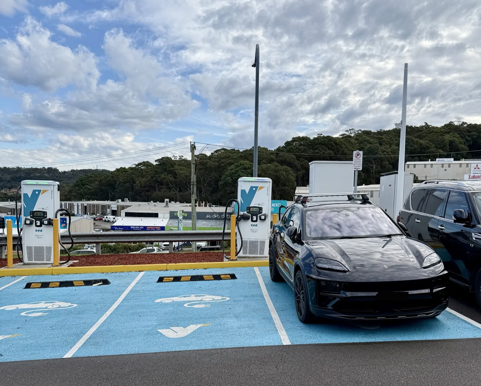

Evie - one of the big Aussie charging networks - stuck a $10 voucher in my account so I thought I would try them for my first public charging session. My nearest charge site (capable of 125kw charge rates,) was empty so I managed to avoid social embarrassment as I fumbled around with cables and charge doors and settings.
Electric Macan EV High Drama at Public Chargers [Aus] Macan at Evie charge station

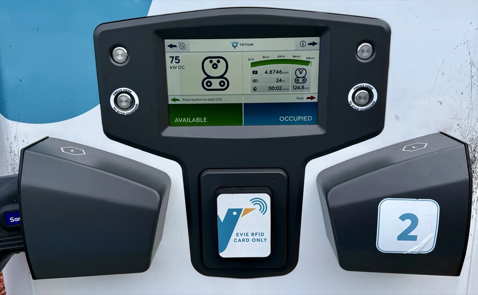

I could not for the life of me get the damn Evie app and the charger to work together to start charging. After about 15 minutes of faffing and cursing the local deity (who failed to smite me), I eventually got the RFID card out, tapped the screen and boom the charger shoved 125 kilowatts/hr of battery juice into the Macan. Interestingly once it had started charging the app woke up and gave me all the charge details, so I was able to wander off and commit consumerism. So score one for RFID zero for dodgy apps.
Electric Macan EV High Drama at Public Chargers [Aus] Evie charge rat

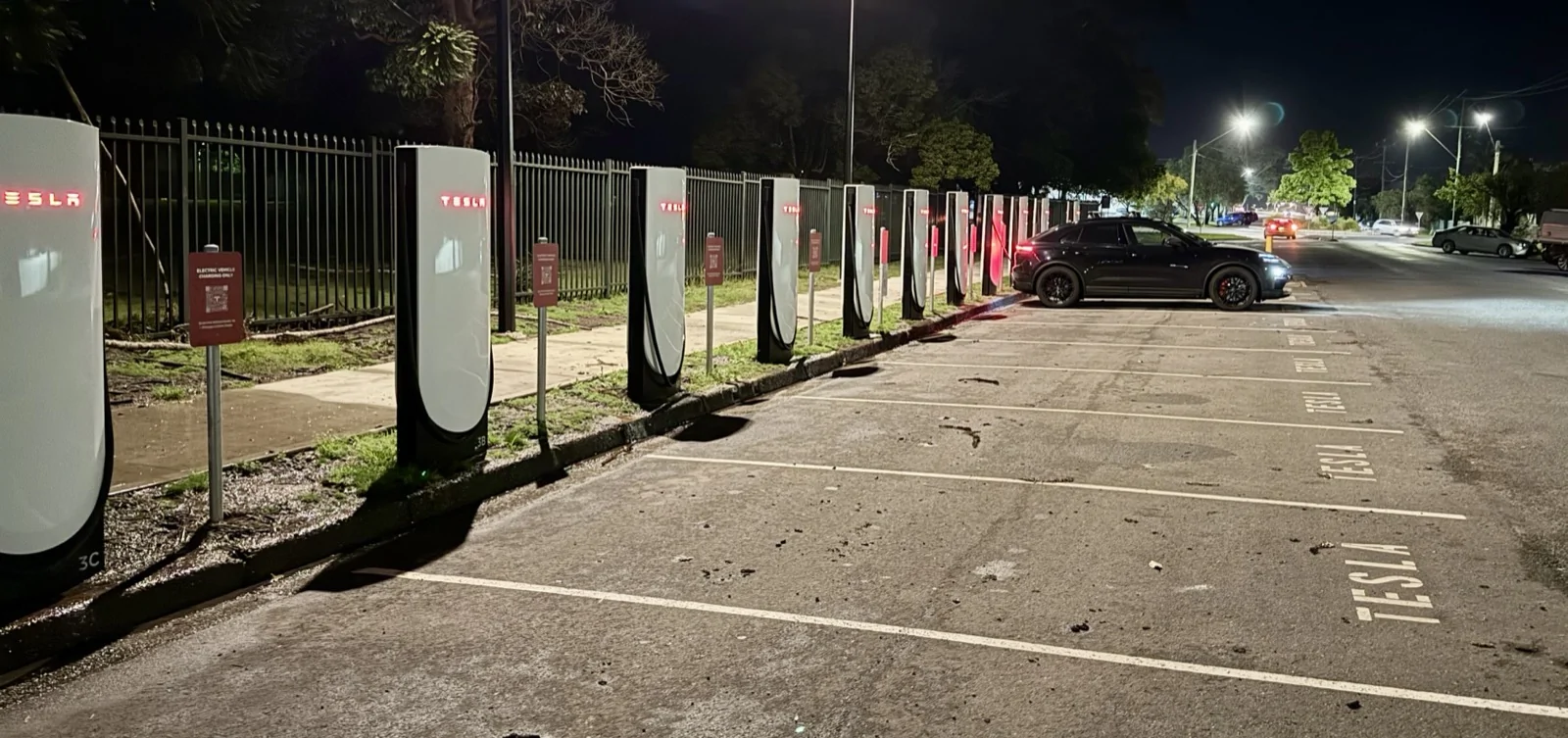

Fortunately, there's a Tesla stupidcharger with the magic dock whatsit at each end of my trip. Not visible on the Porsche Nav app though WTF Porsche pull yourselves towards yourselves please.
I like the stupidchargers because there are always seem to be at least 6-12charge stations. Chargers seem to be good quality and they're very high power. Tesla's militant idle fees mean that people move on very quickly once topped up. High speed DC chargers still aren't that common in some parts of Aus.

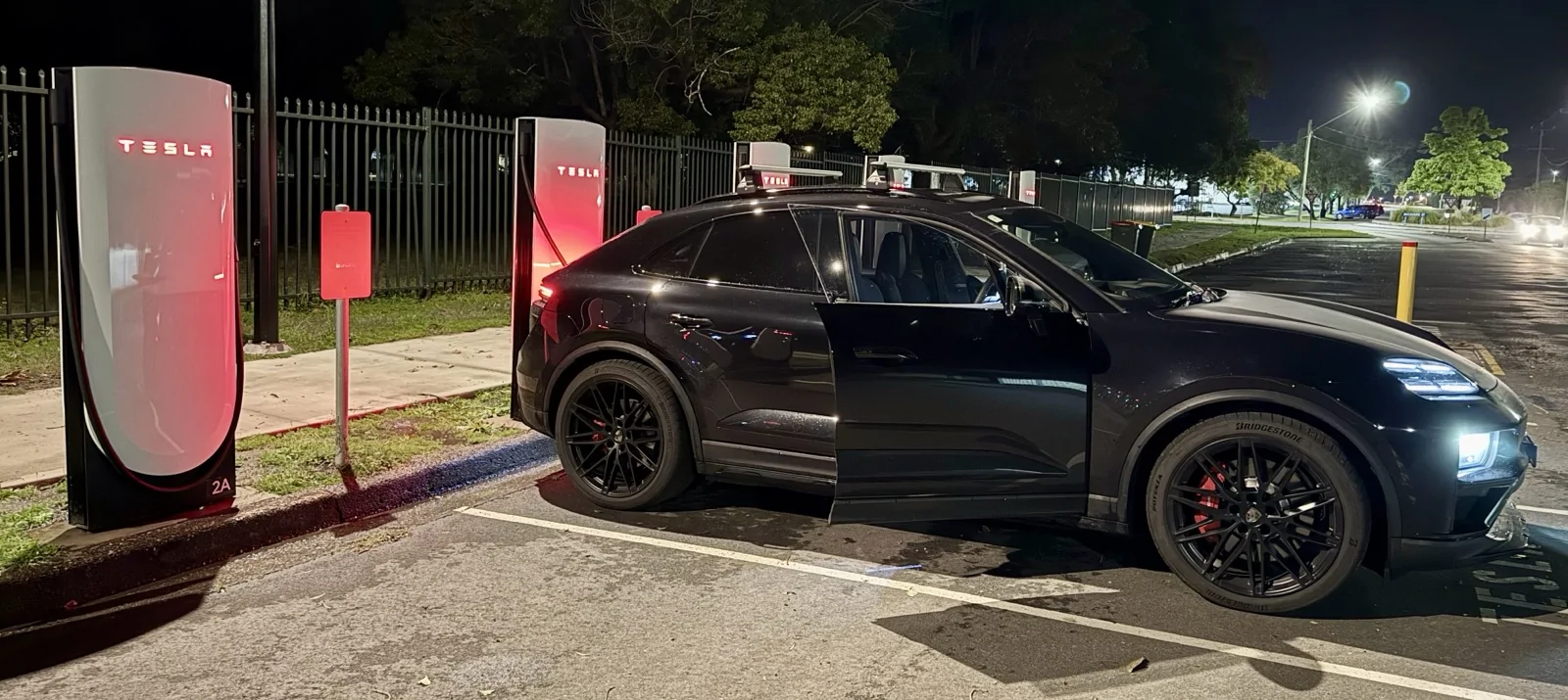

I downloaded the app, entered my payment details for the subscription and thought I was good to go. Turned up at the charger in the dark (a good thing again because there weren't many children around to hear my swearing). There was one suspicious-looking Swastikar owner charging but when he approached I just did a "Roman" salute and shouted "Heil" and he seemed pacified. If this doesn't work in the future I will try a jittery little dance and scream "KETAMINE!! Just say "Neighhhhh!".
Electric Macan EV High Drama at Public Chargers [Aus] Empty tesla supercharger sit
Sadly, once again I just could not get the app and the charging station to work. The app says to plug the car in and then select the number on the charger. But whenever I did this it told me that the charging station was occupied and to try again. No sh!t Herr Musk - I know it's occupied because it's occupied by me!! Why the F won't this damn thing work?
I tried several plugs and unplugs and then I moved to three different superchargers - all with the same result.
Eventually in desperation I started clicking around on every button on the app screen, and eventually clicked the 'update payment details' button. Then I found that I had to enter all of my payment details on this separate charging screen - none of the payment info I'd put into the subscription screen carried over. Once I'd done this, suddenly everything worked. So it seems that the two different parts of Herr Musk's Tesla charging app don't talk to each other. Even though I'd entered payment details for the subscription, this hadn't filtered through to the actual charge details. And once I did that off we went.

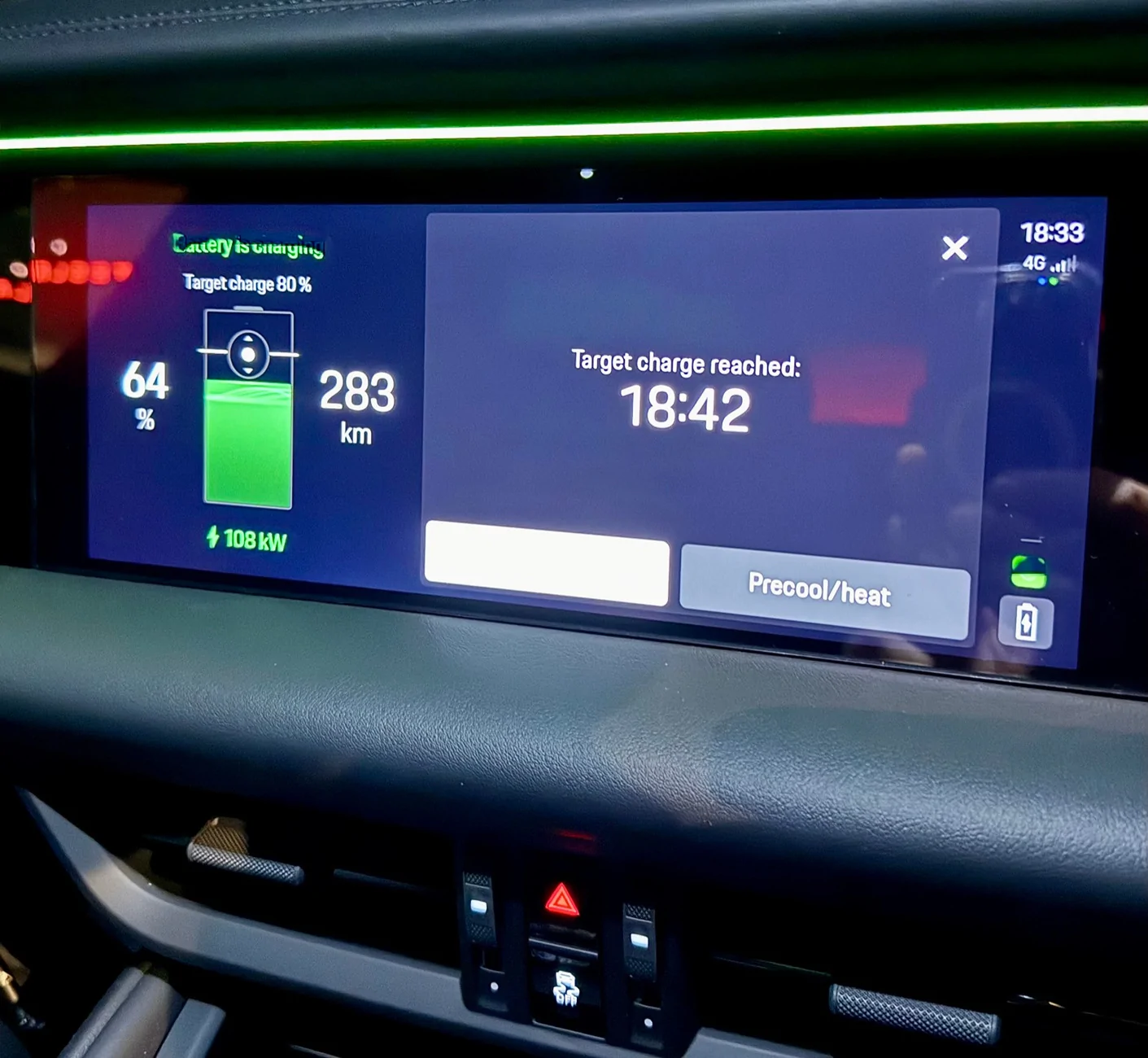

Interestingly it's a 250 kilowatt stupidcharger but my charge rate never went much over around 100 kilowatts. So score 1 for Evie, 0 for tesla.
Electric Macan EV High Drama at Public Chargers [Aus] Tesla Charge rat

It’s possible the Tesla charger was slow because they’re only 400v so the Macan will need to split the pack to match this with a lower kW rate the consequence. My googling and chatGPT’ing skills aren’t up to working out which chargers in Australia are 800v sadly.

Perhaps the reason you’re not able to charge quickly with the Tesla charger is that, since it’s not included in the Porsche app and therefore can’t be set as a destination charger, the battery isn’t being preconditioned. Have you checked if the battery temperature was within the optimal range?

I'm not sure what the battery temp was, but as it's only a couple of km from work it's likely it wasn't optimal. There is an Evie charger nearby, so I might trying setting that as a charge destination in the app next time, and see if it makes a difference to the Tesla charge rate.
@AndrewH is probably on the money - likely only a 400V charger. It's out in the sticks so possibly not worth too much Te$la investment.
