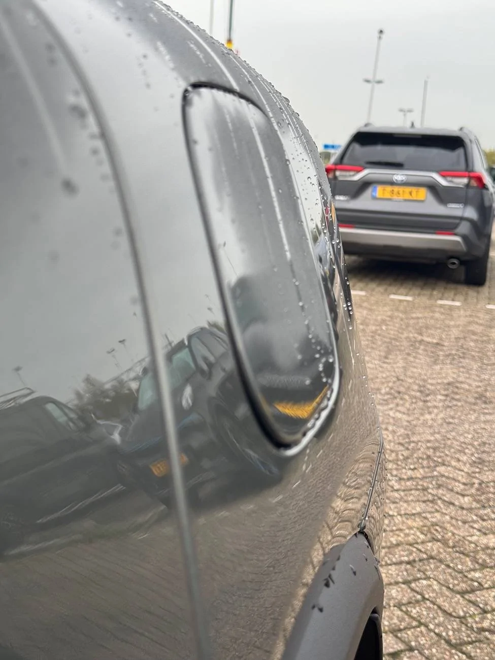

I’ve had my “strange” cover flap now for ten months. As I’ve said before on this thread the shape is due to the hydroscopic properties of the lining and Porsche don’t seem to have found a better option (according to Porsche UK). However other members of this forum have described a change in shape of the flap over time and I can now testify that this really does happen! Presumably due to varying weather conditions…..?

Both flaps on my Turbo were out of kilter at handover. I said it needed attention and they took it round to service. 3 adjusters got each flap fully aligned. Why they didn’t do it during PDI 🤷🏻‍♂️ and they told me it was a common issue.

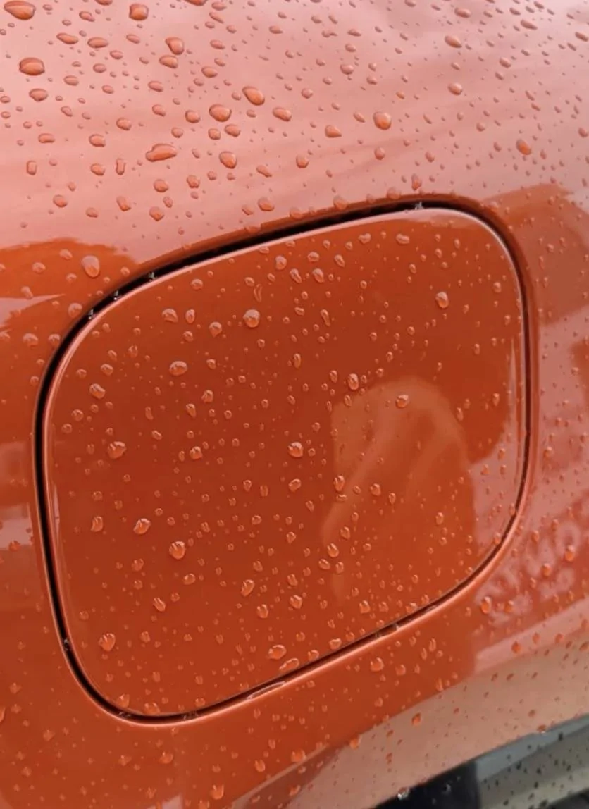

My Macan EV Manually operated charging flaps on both sides do not sit flush.
I went to Porsche dealership Solihull UK and they said it was in tolerance.
To me it isn’t within tolerance given it’s a Porsche.
Anyone else noticed this ?
Both charging flaps were sticking out when I collected our 4S from Porsche East London . The salesman was in agreement and had a technician fix it whilst the car was still in the showroom. It took him no more than 5 mins each side to rectify. I struggle to understand why it can't leave the factory flush. Furthermore, the dealership should address it before handing the car over to the customer.

The issue is hydrophobic (as someone has reported coming out of Porsche on the root cause) then shrinking the inner material may not happen right away until the material interacts with water in the air and the flap is actually flush when it leaves the factory and during shipping time it contorts. It should be inspected when it’s received by the dealer and corrected before you ever see it.
