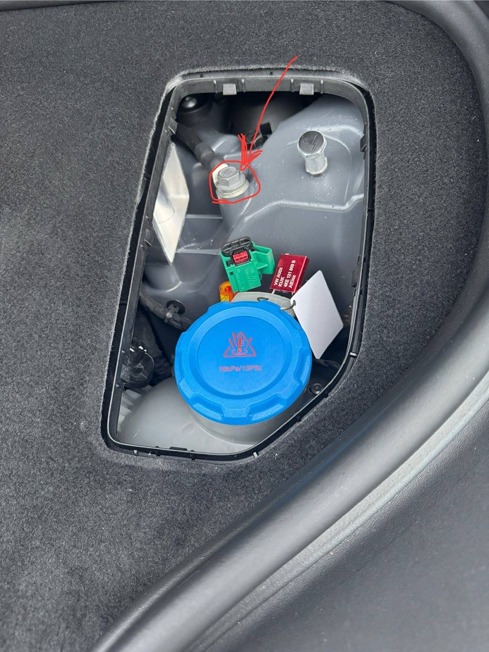

Good to hear you got sorted for now, someone needs to do a video to show where this connector is - although not sure I'd be comfortable with all those sparks.
its the one I have circled in red here if you ever need to do it...

Ok... here's the update and its good news.
The Porsche Assist engineer (actually an AA recovery person here in the UK) visited my house to look at it. His face dropped when he saw it was an EV and he started to mumble about how difficult it will be to lift the car and get it onto a transporter, etc... etc..
Before doing that he checked his knowledge base and there was a similar case so he tried the suggested action (the equivalent of the Microsoft CTL+ALT+DEL I suggested at the start of this thread) and it worked !
What he did - and I think there is reference to it in one the comments just above this - was disconnect the earth under the panel in the right hand side of the Frunk and kept it disconnected in his hand for 4-5 minutes then reconnected it ... sparks and all. I guess this is what you guys are saying about the 12V battery above.
He also commented that he knows of a few owners of other (non-Porsche) vehicles who carry a 16mm socket in their car specifically for this purpose and it tends to resolve many of these computer-related issues. That all said, I'm not sure I'd want other family members having to do this out in the wild, at night, etc.
Thanks to everyone for the advice. The seat sensors one had me convinced for a while but it just needed the reboot.
Apparently , its may've reset many of my settings to default and I need to go and set them up again. but I can live with that. Who knows... it might even have fixed my mysterious passenger window issues too...
The case in the notes he looked up might have been mine. That’s exactly what the AA man did to mine when it wouldn’t start. I now also carry a wrench (spanner) with me just in case. Never needed it but you never know. Car is in for an investigation of other electrical faults next week so will see if it needs any updates. One running issue is intermittent iPhone wireless connectivity which I would love to get solved cos it nearly always seems to happen to my wife’s phone rather than mine and I’m the one who has to try to resolve it.
