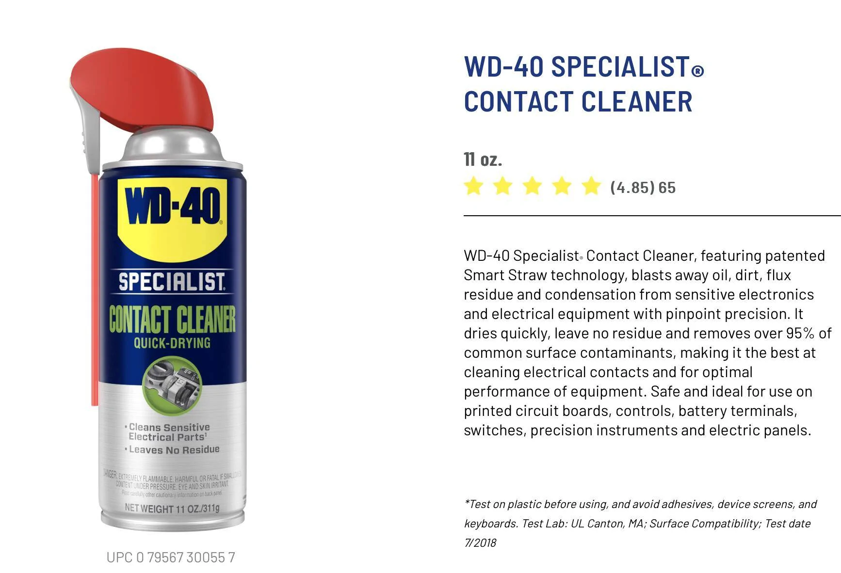

Just an update to this. I had two drives a couple of days ago where the "seat belt unfastened" warning was on the entire journey despite my seat belt being fastened. I bought a can of WD-40 contact cleaner from my local DIY store, and sprayed a generous amount into the female seatbelt buckle, and then fastened and unfastened the seat belt a few times. It immediately solved the problem and it hasn't come on since.

Wow. That buckle triggered me to hand back my car. Mine was with porsche for several weeks and after reassurance everything works perfectly I got the same error message within 10 min driving. Out of curiosity, do you have automatic charging flaps? Both got replaced on mine.

The WD-40 didn't actually solve the problem and it still exists. I've isolated it to one buckle in the rear. I know it's this one because if it comes on I can reach back and tap the red release button and the chimes will stop. However, it's sporadic and I'd rather avoid taking it to the dealer if I can help it as I don't want them fiddling around with my car for an issue that isn't present all the time. For example, it hasn't come back on for around a month now.
I'm amazed you were able to return your car for something which is relatively minor and presumably easy to solve with a change of seat buckle?
No, I don't have automatic charging flaps.
Problems started within first 30 days of ownership. That would have been the third faulty sensor to be replaced. Otherwise very happy with the car so reordered.
