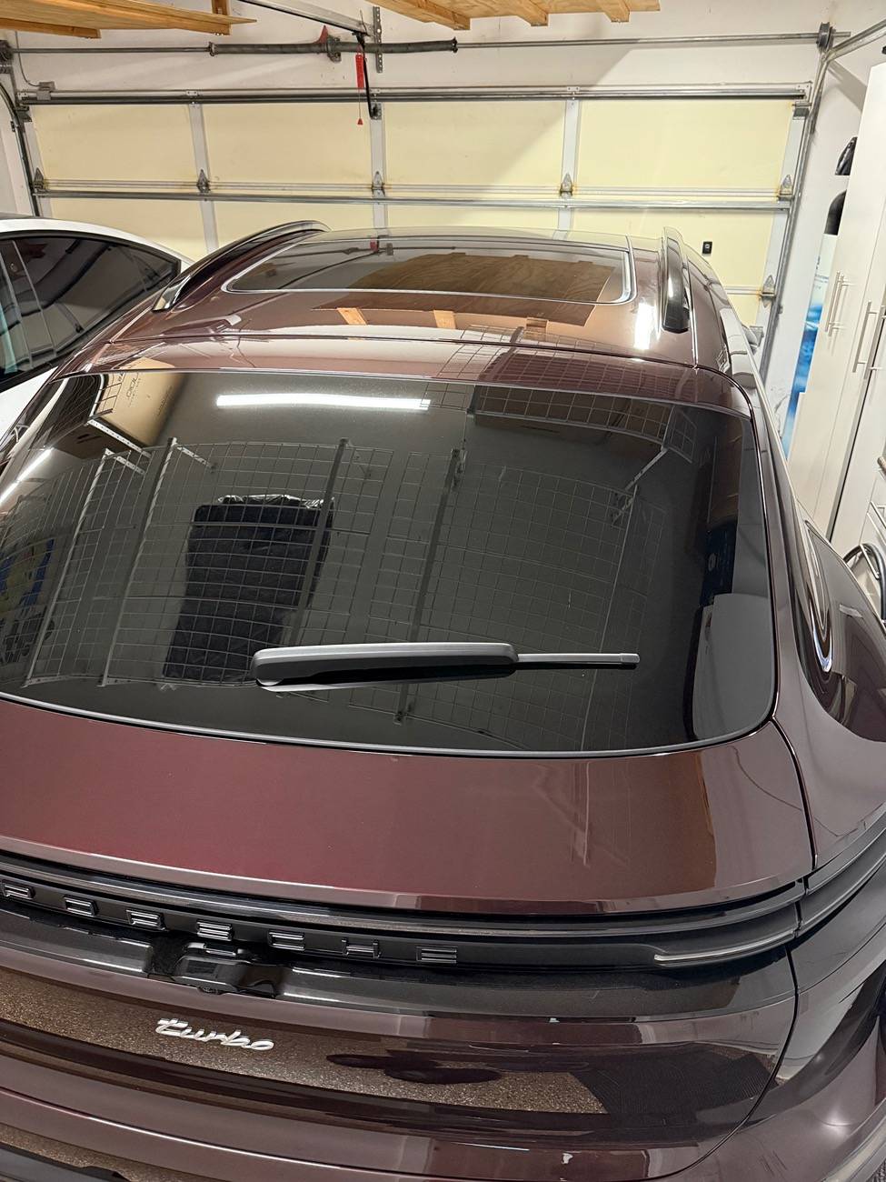

Another issue I recently noticed.
My rear windshield wiper is mounted at an angle. Added to list for dealership to fix.
photo of mine vs how I’m assuming it should look based on same spec vehicle at another dealership on Porsche finder.
Mine is also at an angle like yours as I just looked!, and like yourself other Macan EV's at the dealership have it set all the way to the bottom of the rear windshield so I also put this on my list of things for the dealership to sort out well spotted I never noticed mine until you pointed it out on yours!!!
