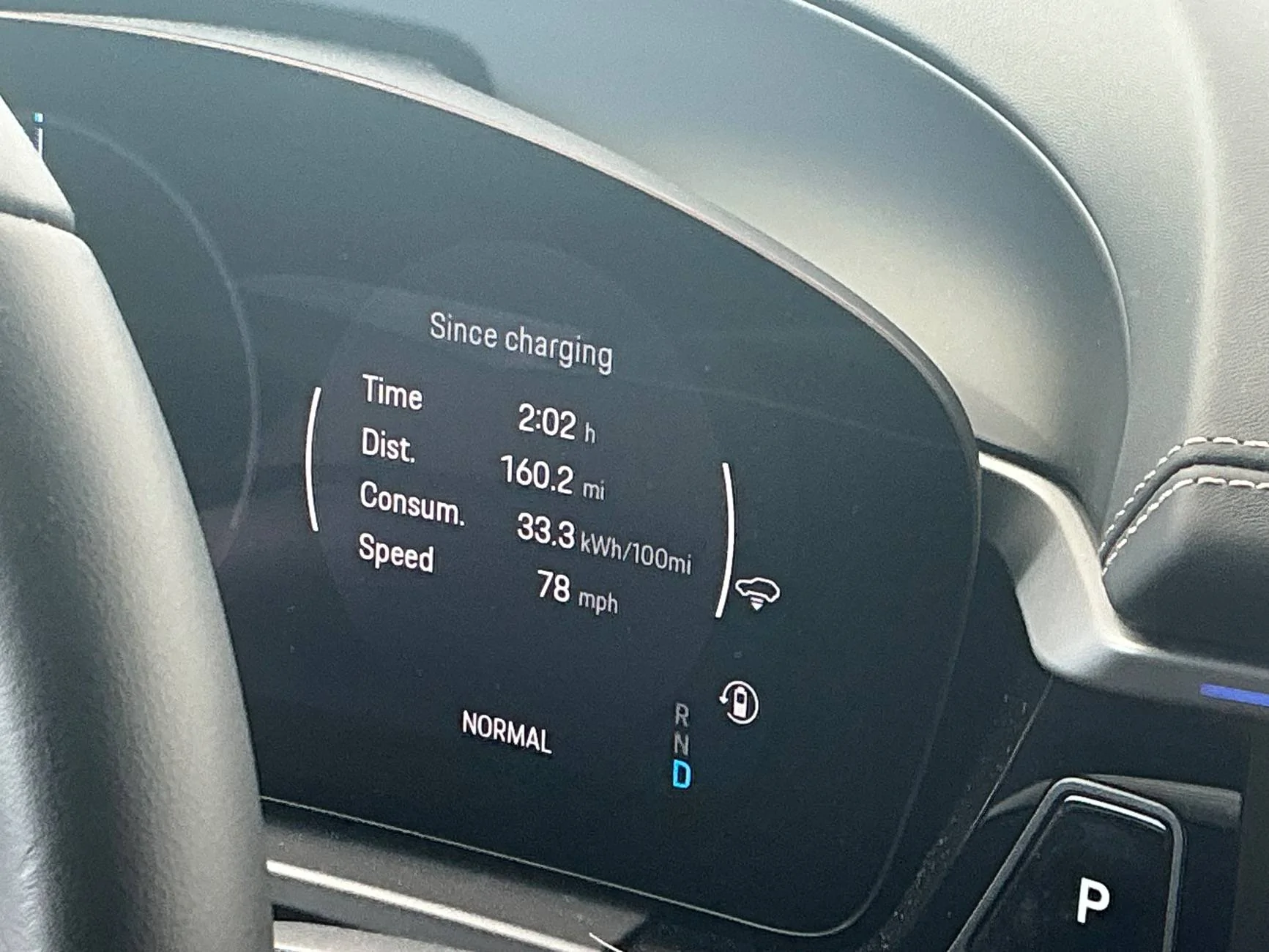

faith restored! car is a range beast today!! we are making good time and not holding back and getting these numbers - so imagine what it could do if we behaved ourselves?
Impressive numbers: 20,6kWh/100km at an average speed of 125.5 km/h
Not bad for a Turbo :rock:
There is hope :clap:
