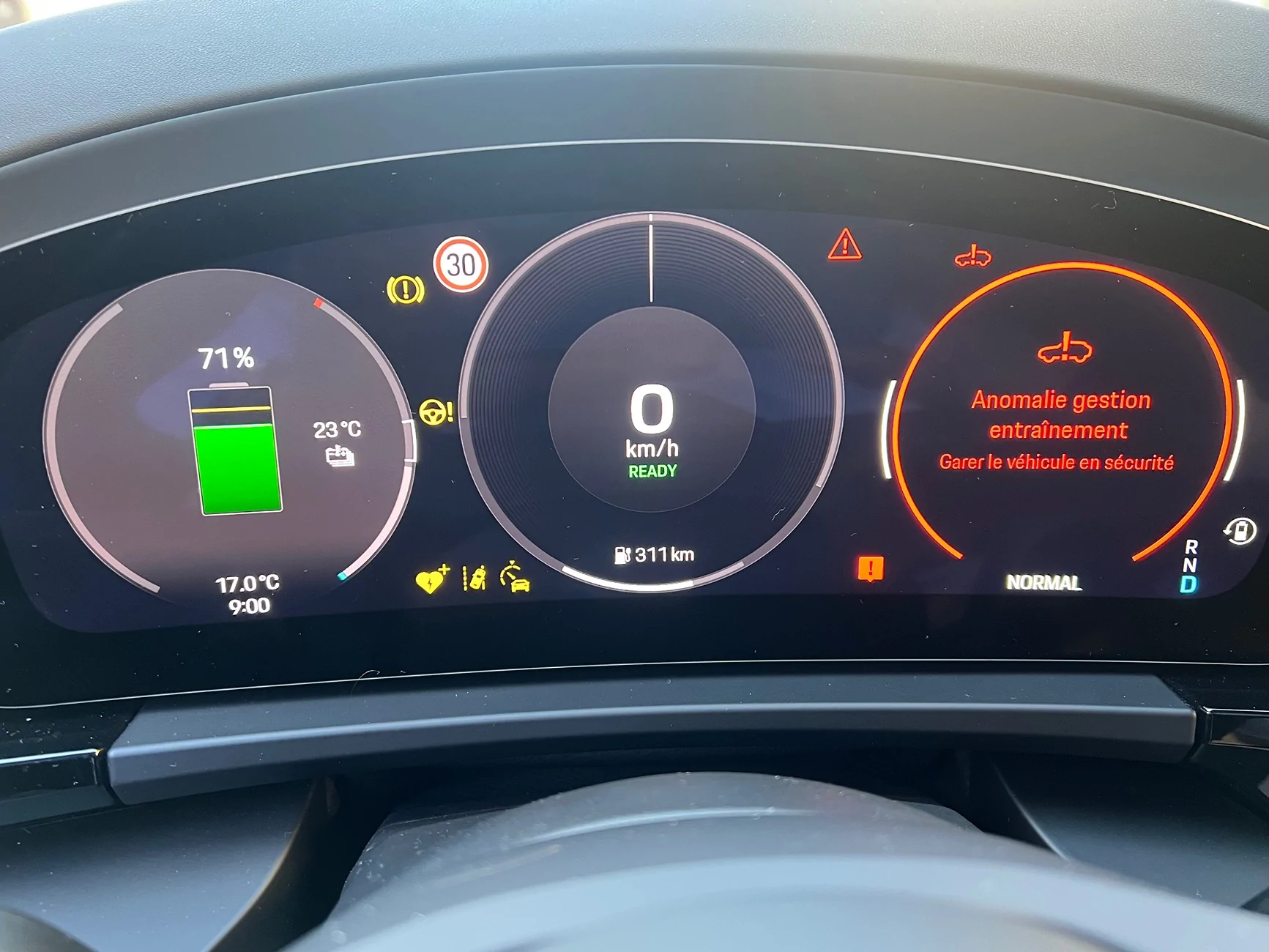

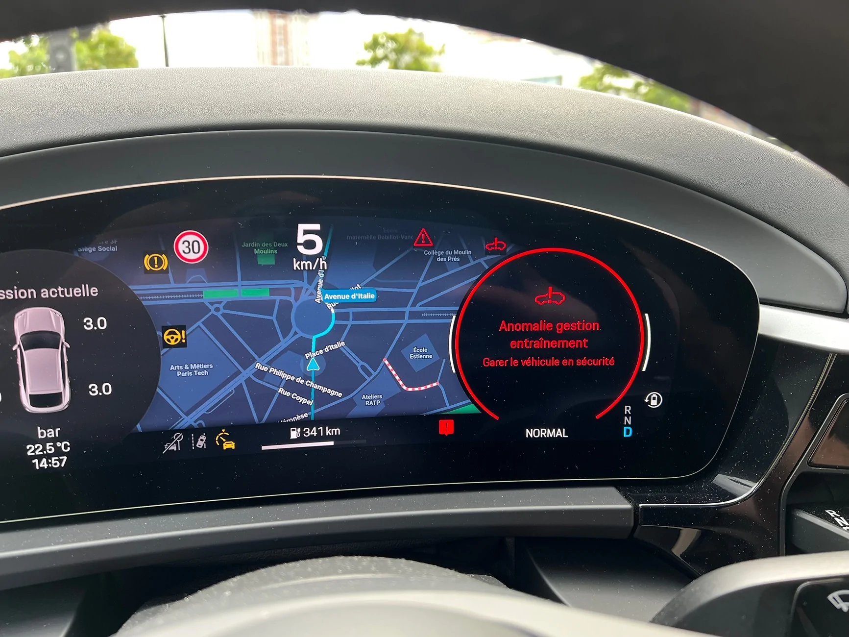

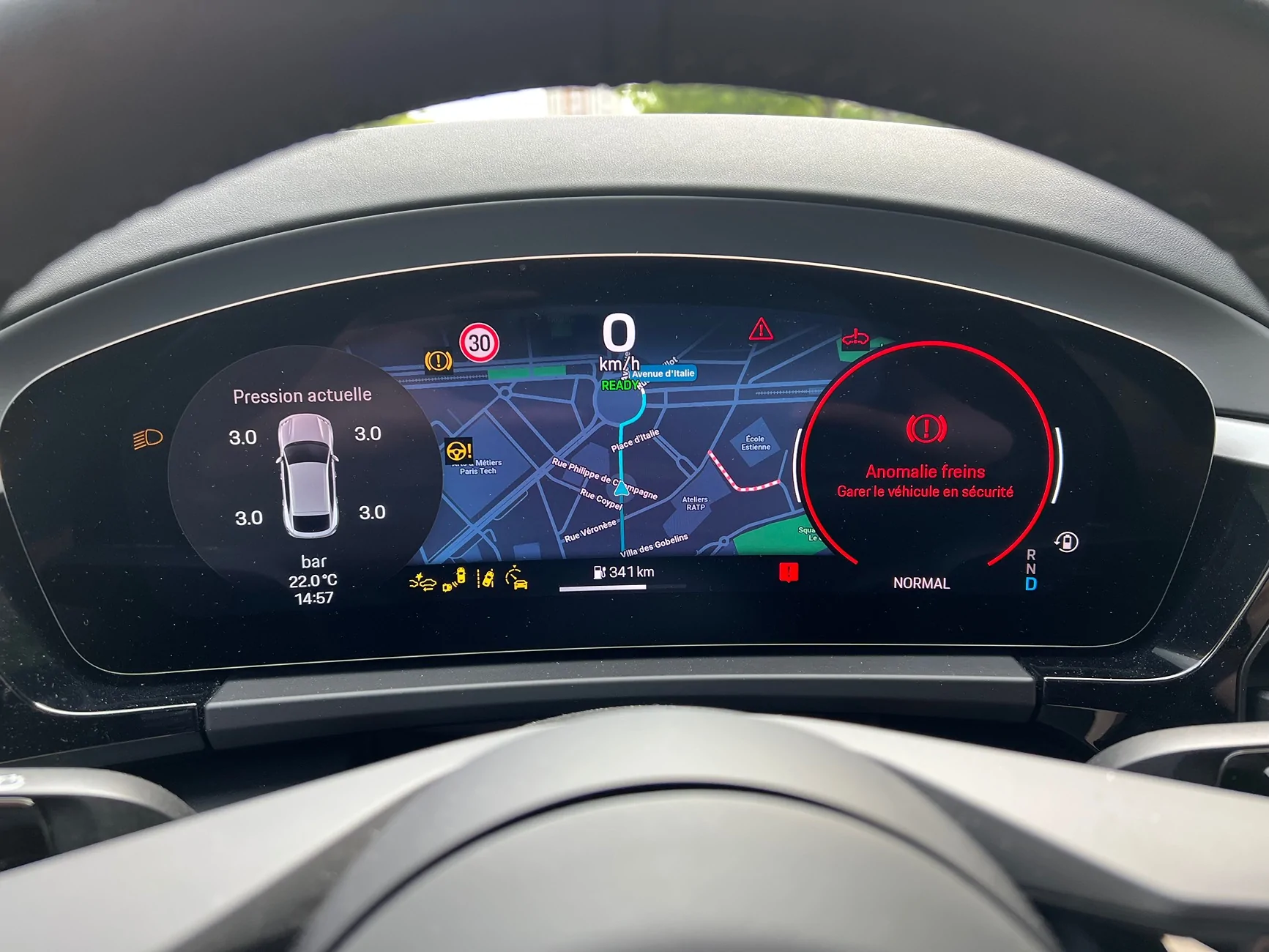

After thousands of km without problems, I’ve had 3 types of red circles of death (plus several yellow ones - pcm, direction, awd system) each 500/1000 km.
The solution was to apply the WSD0 update in early September, and now, I experience each 50 km one red circle of death (and the ones that were red became yellow , and the previous other yellow circles have disappeared!).
question, is it better after than before ?
sub-question: the yellow color of the circles / lemon ; is it a coincidence 😉
it’s not a lemon, but it’s annoying because I need to stop the car, and restart it. No problem in town, I can do it seamless, but on the highway, another story.
before WSD0 :
