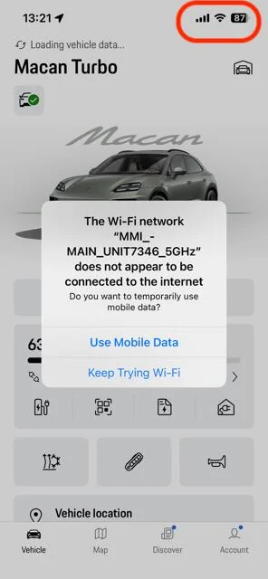

Since March, however, the data transfer and internet connection have stopped working, despite the car showing a strong 4G signal and the phones being properly connected to the hotspot.

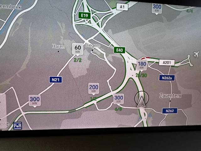

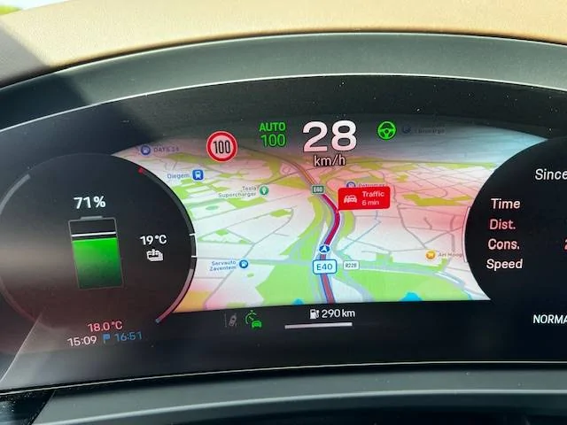

  • Possibly related: the built-in navigation system no longer displays traffic congestion, while Google Maps via CarPlay correctly shows live traffic congestion on the same route.

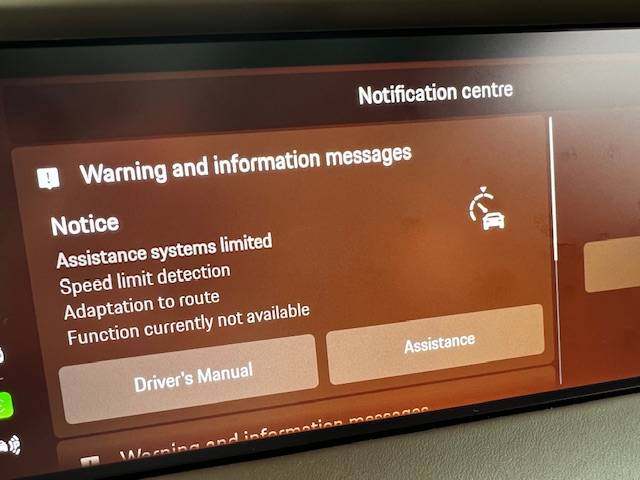

  • Recently, I also had the experience of Innodrive and speed limit recognition being out of service for two days.

I’ve had a couple of connection problems that didn’t resolve by resetting the PCM, unpairing the phone, or resetting the phone. Both times I called Porsche North America and sent the requested screenshots of the phone and car. They promised to get back to me within 48h but failed to do so. The first time I got a follow up email asking whether I still had the problem and requesting additional details. At the end, I did a factory reset of the vehicle and that fixed the problems.

After the last major update, a lot of things stopped working, for example, hot spot. Log out and do a factory reset. Log in again and you can set the settings again, they disappeared. After that, mine worked.

I had this issue recently. When connected to car play I was no longer getting a data connection. I did not do a factor reset but just deleted my phone connection (from both the device menu in pcm and also Bluetooth on my phone). Then I repaired my phone to the car. Connection and data now works as normal. You might want to try that first before doing the full factory reset on your car.

Have you recently updated, that's when it happened to me? Go into PCM, select Settings/ select System/ select Restore to factory settings. Once everything is up and running, you can log in to PCM again, you do this where your name or user is listed. You have to make settings again, some of them will unfortunately disappear.
