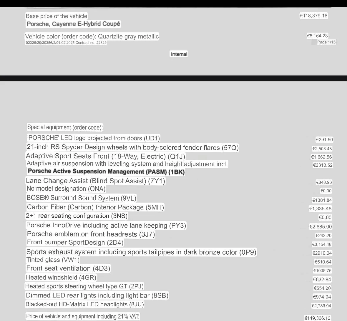

I do not have a sticker, I’ll pick it up on Friday! But! I have the contract picture (and I Google translated all the optionals for you!)

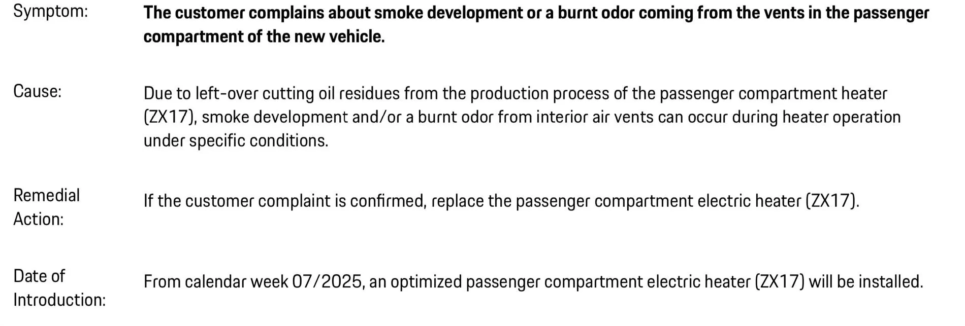

there is a recent TSB about the issue which says there can be some residual oil from the manufacturing process in the heat exchanger and in this case it has to be replaced with a new one.
chatBDE
May 9, 2025
california
Macan 4 EV
Can confirm when i brought my car back for the second time for this issue, they said there was a bulletin out for this issue and a known fix with a modified part
