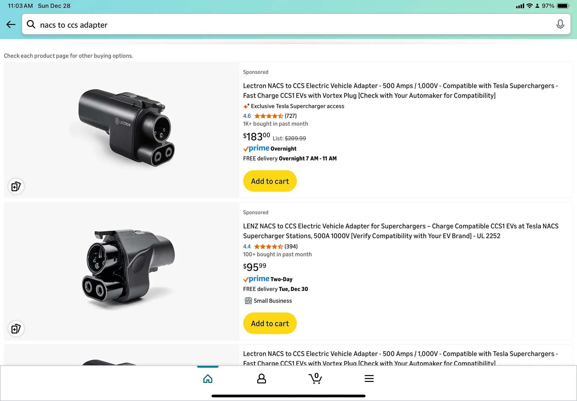

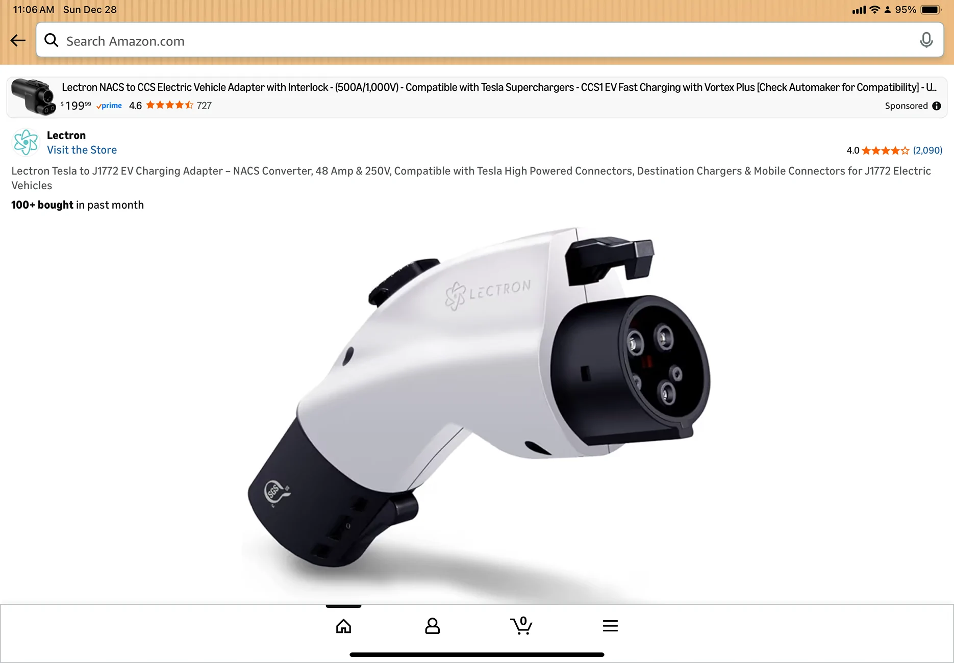

Hi. As another colleague mentioned you can order it and have it shippedto your friend‘s house.
Amazon carries both and offers overnight shipping.
I tried taking 2 pics one for Tesla fast chargers which is identical to the one Porsche sent us/me only replacing logo with Porsche logo. The other I believe is the one that you can use with a Tesla home charger not fast charger Stations.
both on Amazon. Best wishes.

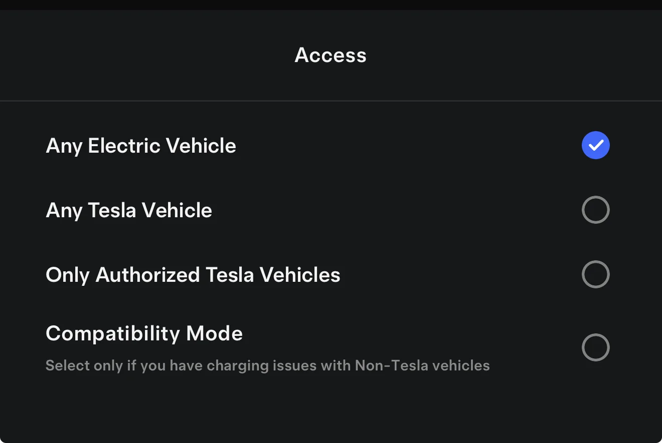

all Tesla Wall Chargers _CAN_ speak J-1772 - it's not a matter of software installed or not installed - but some Tesla Wall Chargers have been configured to be "Tesla only"
this is not the default factory configuration
if you have the right "app" and can connect to the wall chargers wifi hotspot you can "adjust" the configuration…
but many many people have lost the wifi name/password for the wall connector so it's effectively locked…(although there is a QR code on the side of the adapter)
the point is _IF_ you know what your doing and you're allowed you can "adjust" a Tesla Wall Charger's configuration to not be Tesla-only…
but since this is not the default configuration from the factory - it's unlikely a residential user made any changes what so ever…
you can use the Tesla app to "adjust" the Wall Connector's configuration if you've added the wall connector to your home's wifi…
the 4 possible configuration are show in the picture below - the default factory configuration is "Any Electric Vehicle" - so unless someone has made changes - that is the 99% likely scenario - especially for a residential home Tesla EVSE…
