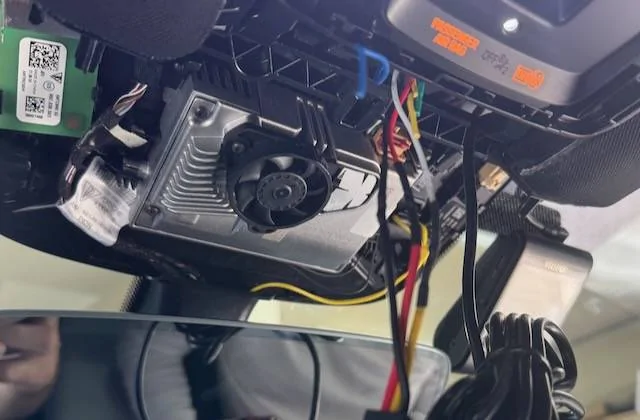

Luckily, the ACC in the pre-wiring harness is immediate on the power switch, so easy to find once we'd got it wrong the first time! He diagnosed and fixed this in-situ, as unplugging the thing once connected is hard without taking down more of the console.
Electric Macan EV Porsche Dashcam img_6282-png
This is a photo of the intermediate state before we found the correct ground wire (It was not the black that is connected in this photo!)
