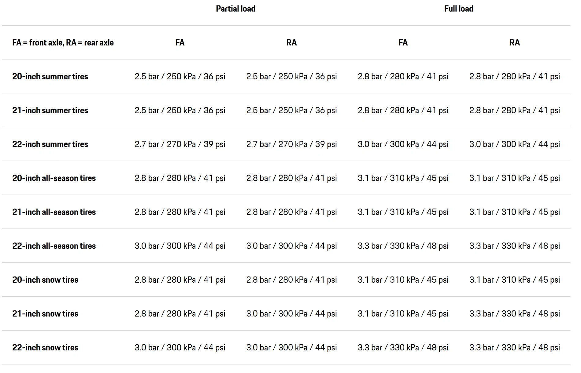

Swapped my 22" all season wheels for 21" winter wheels (Pirelli). The 22" have an inflation pressure of 48 psi. Anyone with 21" OEM Porsche Pirelli winter wheels know the recommended pressure? Thx
