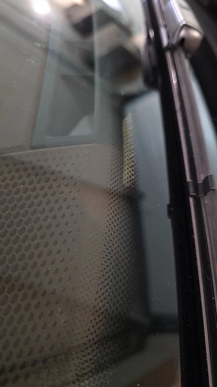

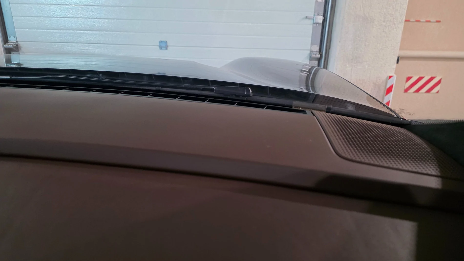

Hi there! The rattle if I'm not mistaken is coming from the speaker grill on top of your dash board, nearby the connection between the hard black plastic with brown plastic and the leather. All macans having same issue more or less, just some people they cannot listen because of the road quality in their countries. Try hitting with 2-3 fingers with high frequency the top of your dashboard nearby the speaker until the middle where the clock is located. if you can replicate then we are talking about the same rattle which I fixed by pushing some insulation material. If there is another rattle, again you can replicate by hitting your screen with 2-3 fingers to listen it but I doubt it's the screen.. I guess a permanent fix will be to remove the speaker grill and insulated, which I will try to do later on...It is okay for temp and until verify that 100% was that. Let me know if it worked.
I have the exact same issue, it is temperature dependant for me too. It started during autumn, went away during the winter time and now it is coming back.

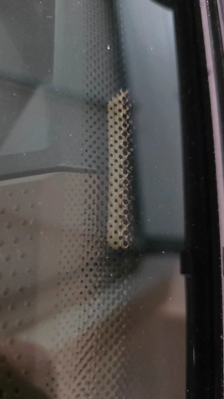

I fixed it by wedging a business card folded in half between the window and speaker/dash. Also, in my case holding down the speaker grill stops the rattle too - so at least in my case it was easy to pinpoint the cause. Had it booked for a fix, but the dealer didn't bother to remove the wedge and said there are no rattles...

That means there are 2 rattle sources.
1. From the light bar.
2. From the speaker grille.

It turned out that my rattle was most probably from stuck dust,(most probably while seating in the dealer). I removed the foam and used my Turbo fan and believe it or not rattle is gone!I was surprised too...
