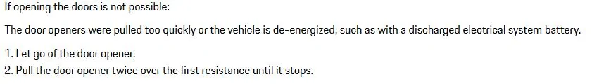

The manual doesn't really say how you can open the door. It shows you how to unlock it from the outside by pulling 5x on the handle and then put the fob on the VIN part of the windshield like some weird mating ritual.. also to manually lock the doors using the key in the glovebox. But nothing about how to open the door from the inside if you're trapped inside.
Here's the relevant part of the manual: https://manual.porsche.com/#/wpi/XA..._US/topic/id/a711a21651c8f2128d24c0b357f9bd3f
