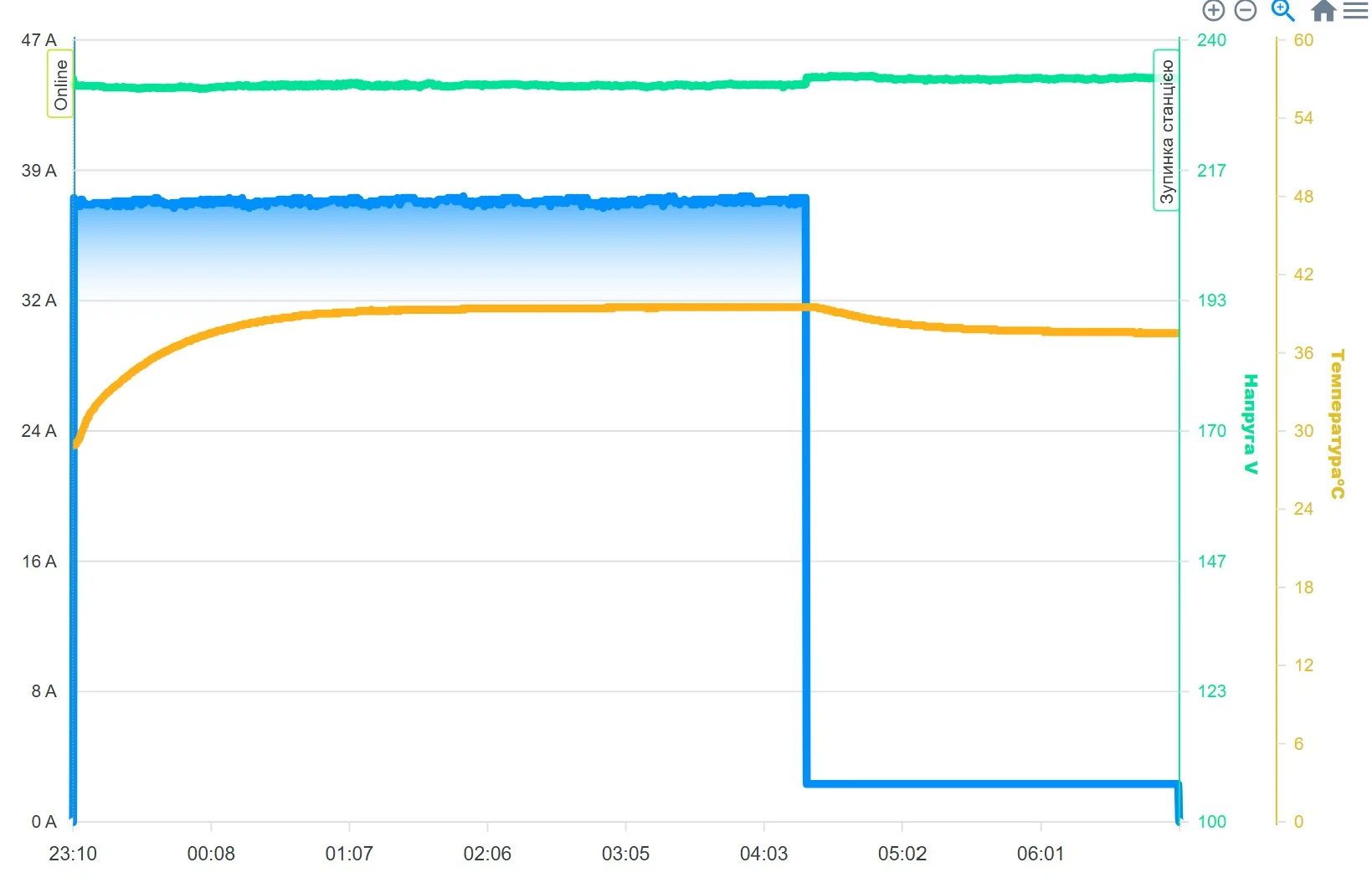

OK, I have been posting in this thread, and unfortunately now is the time to post again. We had to leave Macan EV 4S sitting for 19 days, and it lost 16% - from 61 to 45. Before, I had a problem with the car unable to reach programmed SoC (like you set it to 80%, and in the morning you get 76%), I followed the advice to discharge to 20%, wait 12 hours, charge to 90% and again wait 12 hours. That fixed inability to charge to 80%, and other glitches (like the car reporting 31%->70% DC charging progress while station says it sent only 30kWh) as well. However, massive discharge did not go anywhere. It was unlocked in our garage, with the keys on another floor with concrete floor in between. But SoC drop was also observed when it was locked in the public underground garage, so I don't think the problem is related to the car being (un)locked.
Before recalibration I thought that the SoC drop is virtual, car just cannot understand what the SoC is. But yesterday I plugged it in, and this morning I found that it really consumed 46kWh (we drove it yesterday so it lost another 10%, SoC was 35% when plugging in, and 80% is the target). Which means the car actually lost that 16%, and I cannot imagine how it is possible. This is 16 kWh, insane amount of energy, just think of it. Even in theory how would it lose 16kWh other than converting it into heat?
Another strange thing is that EVSE does not get a "stop charging" signal. Current chart shows normal current of 37.8A, and once it consumed those 46kWh, drop to 2.3A. EVSE is programmed to stop charging at 7:00AM, and until then it shows sending 2.3A to the car. EVSE is good, I checked with another EV and it definitely finishes charging session once car reaches programmed SoC. I believe this started some time after getting the Macan, first few months it worked just fine, losing not a % of SoC and ending charging session correctly. I will try public AC charger which shows amperage value, have a few nearby.
Here is the amperage chart. Look at the blue line. First it is at 12 * 3 (I have three phase system and limited current to 12A, it does not matter, might have been 15 or 16), then drops to 2.3A and stays there indefinitely. It stops at 7AM only because EVSE is programmed to do so.
Electric Macan EV Sudden Range Drop at 80% Charge in Macan 4S charging_current
Anyone had this issue (SoC loss, charging glitch is a secondary issue)? Dealer said they have a software update, but I don't believe this is software glitch.

I have shared my issue with local EV forum (not specific to Macan), and someone there suggested that EVSE issue (last part of my post 2 posts above in this thread) hints that car does not let EVSE go into sleep, draining some energy for its needs. I have a clamp meter, and made an experiment - started charging the car (BTW it lost 1% since yesterday according to display), it consumed 1.5kWh, stopped charging, but one phase still consumed 1A, while two others 0.3-0.4A. Once unplugged, all phases went into 0.1A which is probably meter's precision. I know protocol would not allow charging current less than 6A, so I'm lost here. Probably this is specific to this particular EVSE, but with other cars it stops charging correctly.
@ChrisFromUK As you said, it very much looks like the car does not go into the deep sleep, and does not want anything around it (including the EVSE) to do that. Do you have an EVSE at home? Can you look what happens once you are done charging the Macan? Will the EVSE recognize that charging is finished, or will it hang in charging mode?

OK, I see, thanks! Found a way to delete scheduled departure time - just swipe it right to left from the screen. Still car shows that it is charging (green lights everywhere) while display says charging session is complete. I'm paying so much attention to the charging because I believe those two issues (car not terminating charging session and car losing SoC) are related, and it is easier to make the dealer look into the charging as it easily reproducible.
