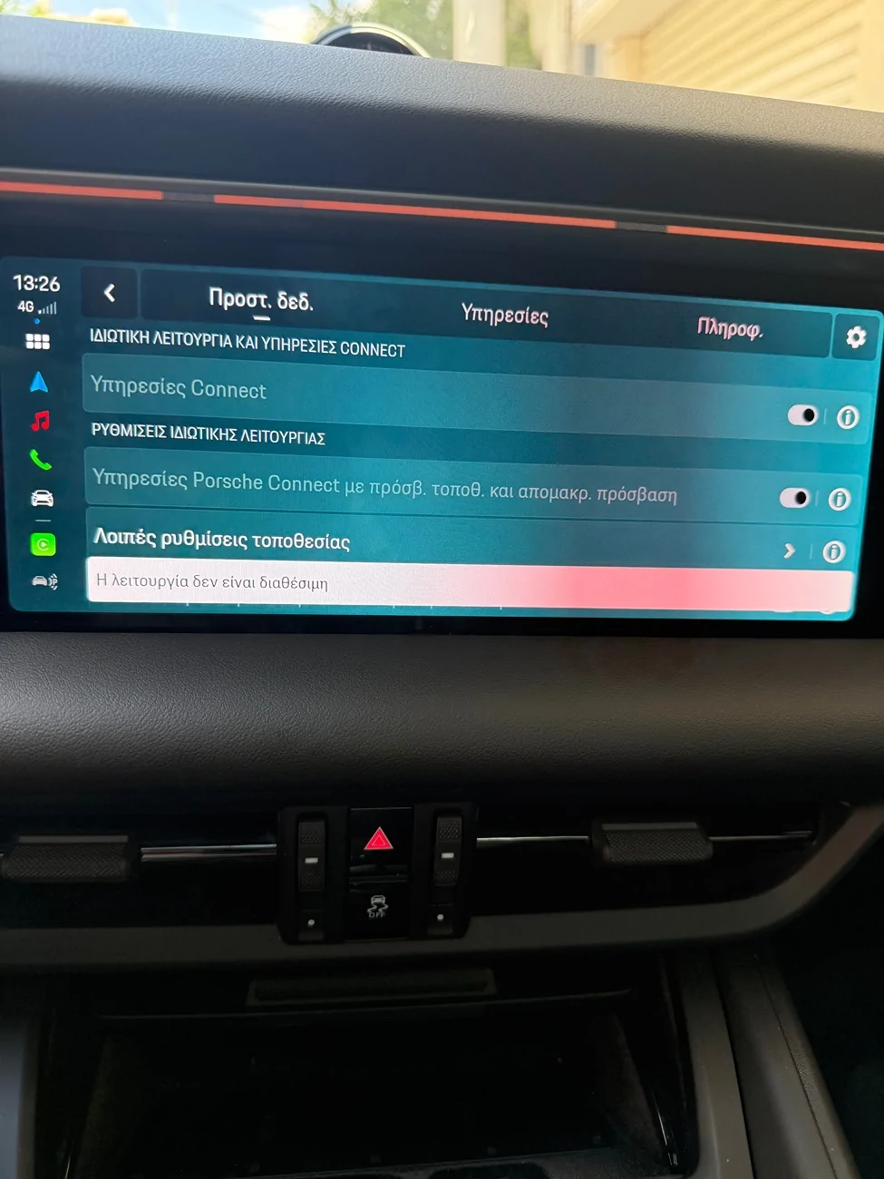

Electric Macan EV the mobile app has stopped receiving data from my car IMG_1810
