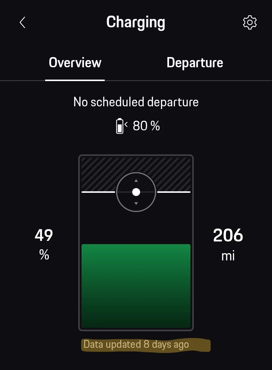

While the app isn't updating with SoC or range, everything else seems to be syncing normally (vehicle status, mileage, vehicle location, tyre pressure, and trip data).
Battery is currently on 62% but the app has been stuck on 49% for over a week.

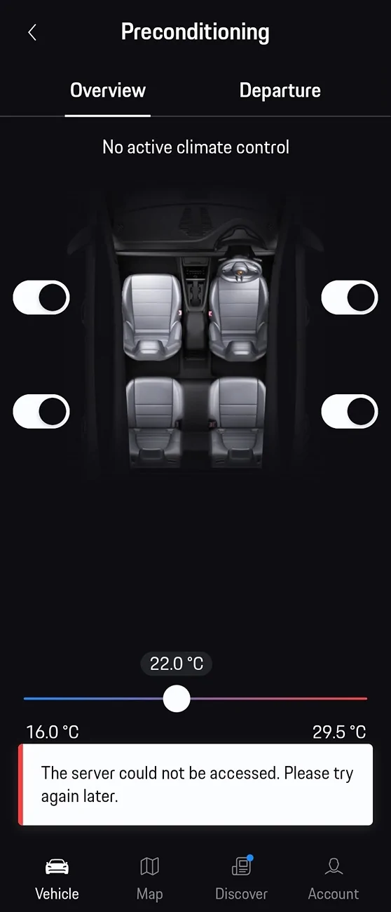

Also, I can't send anything to the car such as preconditioning or a destination.

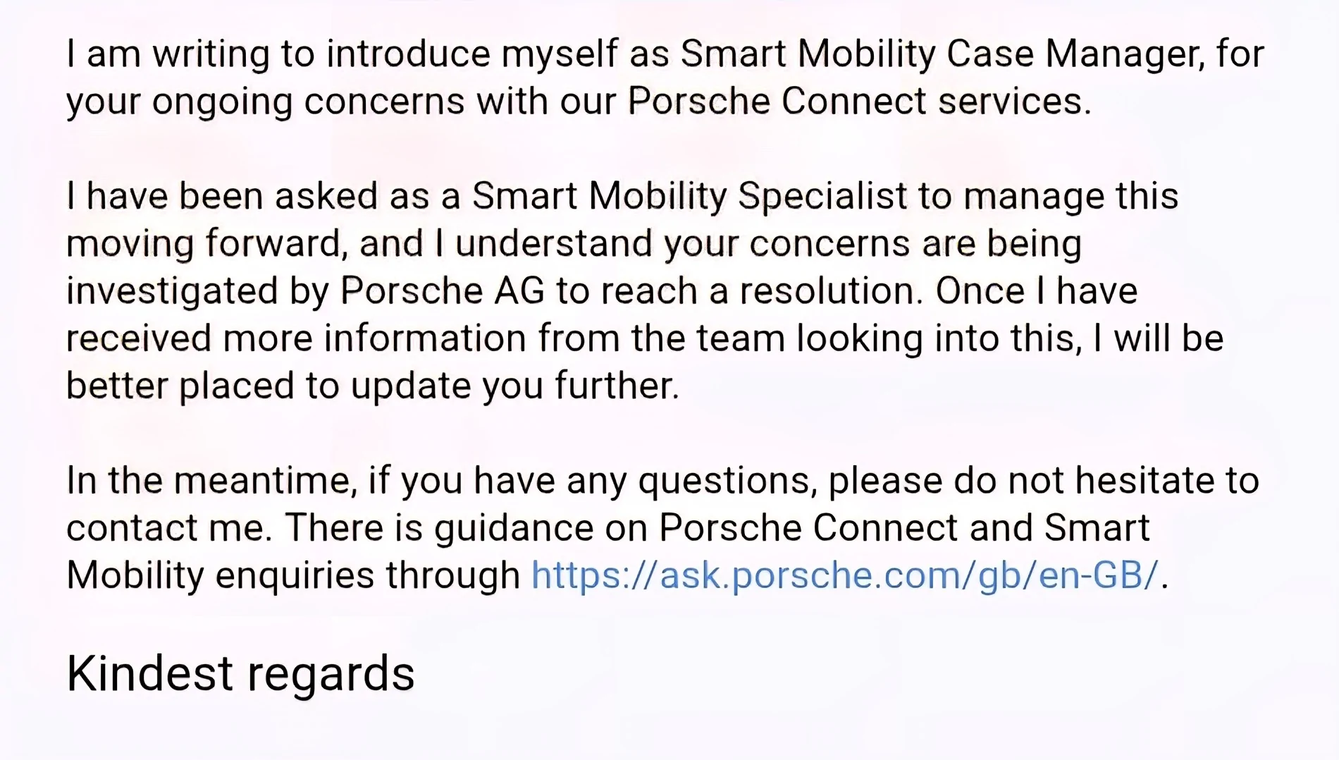

Sounds like a remote access authorization issue. I called customer service who provided me with the link below to upload screenshots and submit a report. Awaiting feedback.
https://my.porsche.com/app/bug-reporting/targeted-use
Edit: Forgot to mention that I reset the PCM a couple of times but that didn't help. Ended up deleting my account and resetting the vehicle to factory settings to no avail.
Response from Porsche:

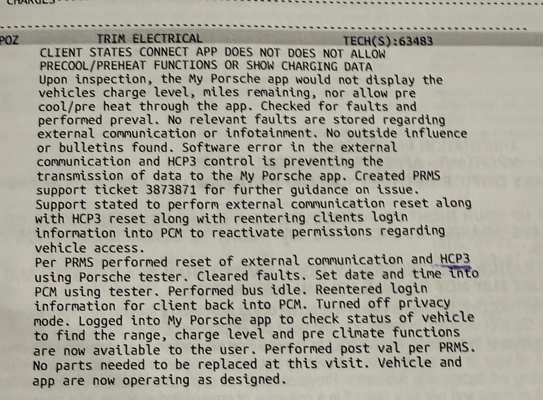

I took delivery of my new Turbo last week and experienced the same Porsche Connect problems that most of you have been plagued with. We tried resetting to factory settings and reinstalling my data but this did not help. Today the dealer did a reset of a couple PCM modules and this fixed everything! Here is what they did! I hope this helps those that have not gotten a solution from their dealer
Electric Macan EV the mobile app has stopped receiving data from my car IMG_3559

Does anyone knows were the fuse is and the number of it .
Instructions for Service at Porsche Center:
"To re-establish the data connection in affected vehicles, a complete restart of the ConMod control unit is required.
This can be carried out either by performing a ‘Hard Reset’ diagnostic routine using PIDT/PIWIS, or by removing the corresponding fuse for approximately 3–4 minutes (with CL15 switched off, due to privacy requirements)."

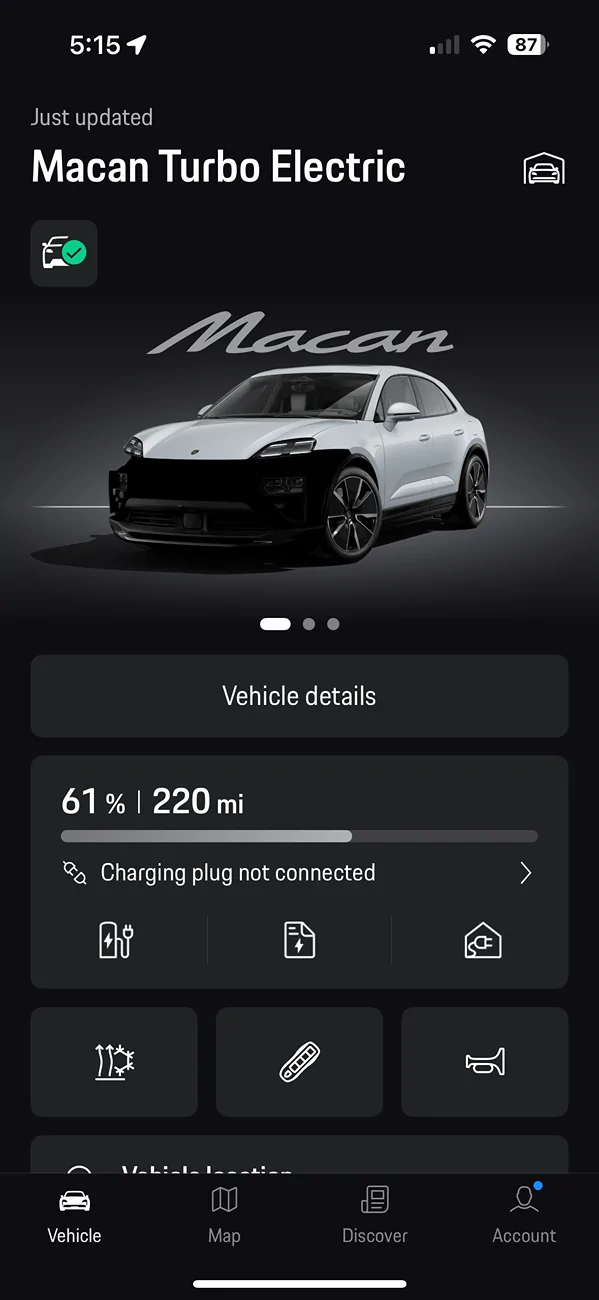

My app has the weird missing bumper bug. It's online in my "saved configurations" too.

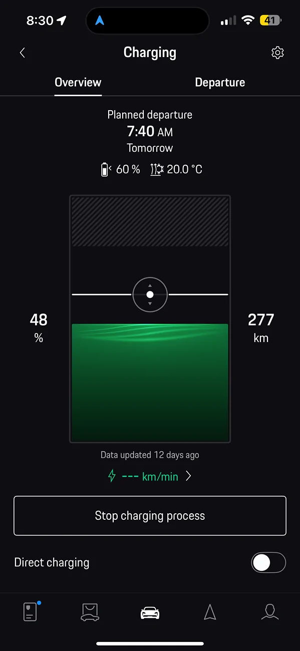

Mine hasn’t been updating for 12 days. Been to the dealership with no solution. Tried uninstalling and reinstalling, didn’t work. It’s mind blowing Porsche takes so long to fix bugs. Dealership is useless too, they don’t know what’s wrong. Some ppl’s app randomly started working I read. But it doesn’t make any sense how only a few got it working and not all of us. Don’t think they pushed any updates lately. It’s really annoying how I can’t pre-climate my car and I have to change schedules inside the car instead of on my phone.
Electric Macan EV the mobile app has stopped receiving data from my car IMG_7489
