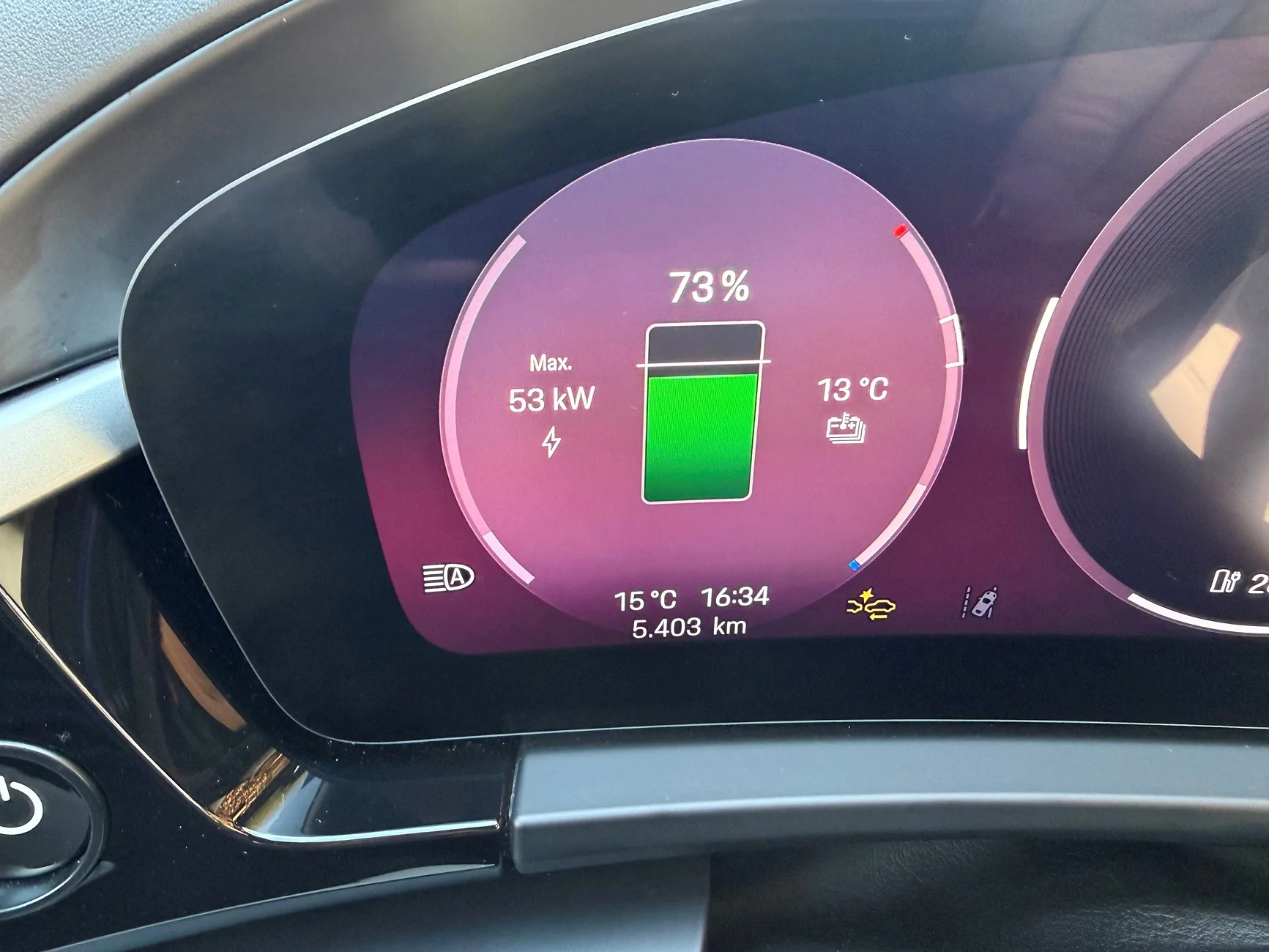

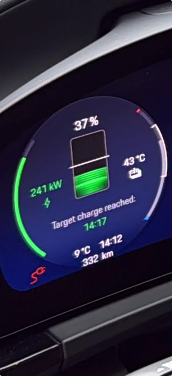

Have you tried using the porsche Nav app, as I suspect the battery is not at the optimum temperature for high speed charging. I have a MY26 Macan which shows on the side of the battery guage the instant max charge rate and at normal temps you will get low charge rate, for fast charge it will need to be around 43c please see pictures below

Battery temp was reported as 21c, which is a little below the optimum starting temp for charging, but not enough to drop speed to only 40kw.
That first photo clearly shows a max charge speed higher than 40 at a much lower temperature than 21c

Notice that the second photo above with the battery temperature shows the range (gray bar on the right of the dial) starting MUCH lower than 43c and that temperature is NOT the optimum temperature for starting a charging session. This range starts about 25c. 43c is a mid-charge temperature that is expected as power is stored in the battery

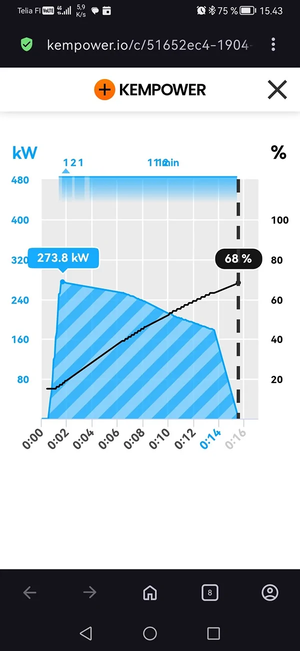

Driving Macan 4 below 20% and letting it heat to ca. 35 C the charging was way faster than in my 4s 2020.
I only had the car as a loaner for ca. 1000 km but battery handling was way better than in my Trashcan.
What did your charger report? Was it limited by car?
