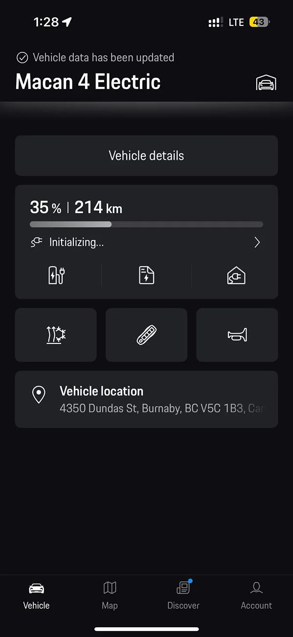

Very odd. I’ve been away for 11 days and left it at 50% as per instructed in manual. I also plugged in my car.
For some reason it looks like there’s an issue with charger as it’s been stucked on “initializing” and not charging. However my battery is down to 35%. That’s a bit weird.
