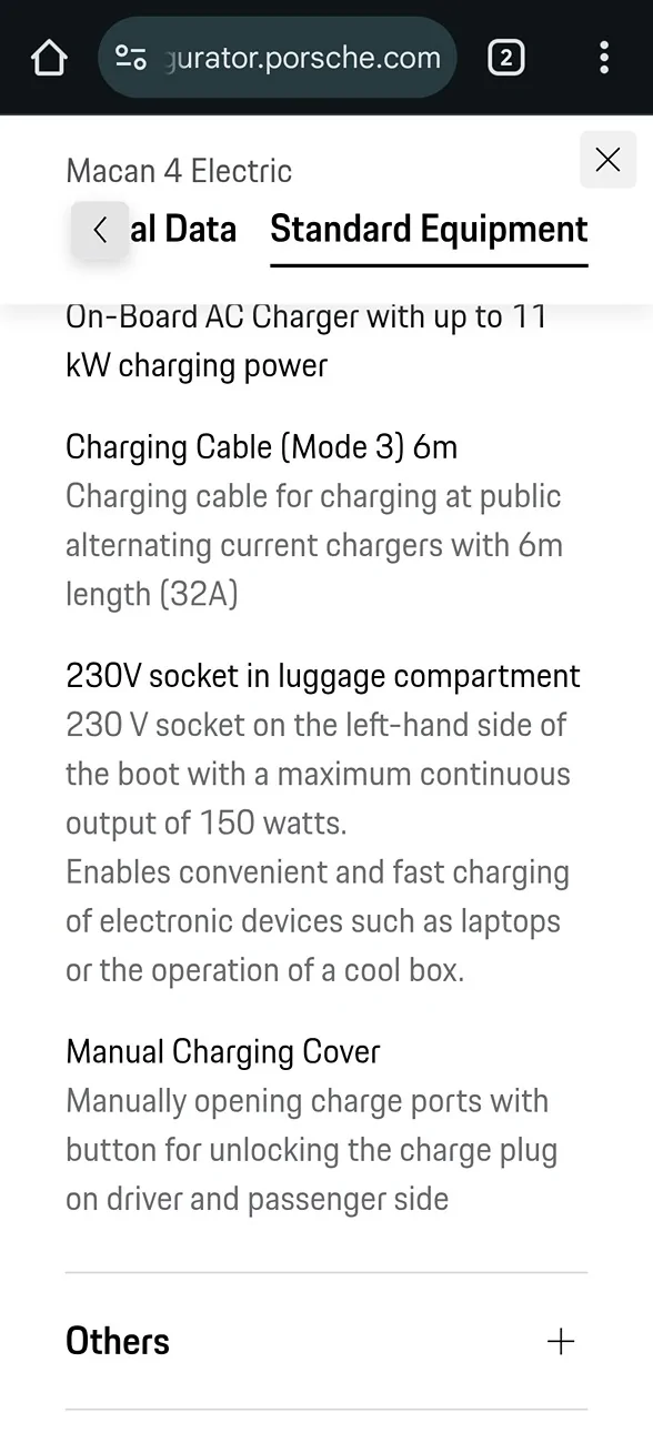

Normally there is a choice of 16A or 32A EVSE to car cable on the configurator.
32A is the standard cable supplied.
Suspect your dealership may have swapped cables on you - worth a challenge.
Electric Macan EV Wall box does not work (finally solved) Screenshot_20251110_105140_Chrome Beta
