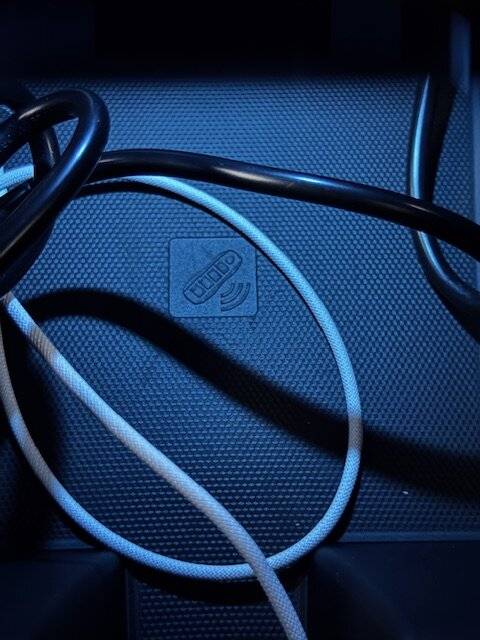

Hi All,
What is this for in the storage area in the mid section? Is the little picture for you to store your keys there.
I don't think it's for wireless charging as that's the compartment above.

It's where to put your fob to be recognized by the car if the fob battery is dead.

The location in the front shelf of the centre console (marked with a logo) is used to start the car as part of an unlock/drive/lock scenario when the vehicle key remote doesn't work e.g, because the battery is exhausted.

If the vehicle key remote doesn't work, the car can be started by first placing the vehicle remote key in the front shelf of the centre console, pressing the brake and then the power button.
