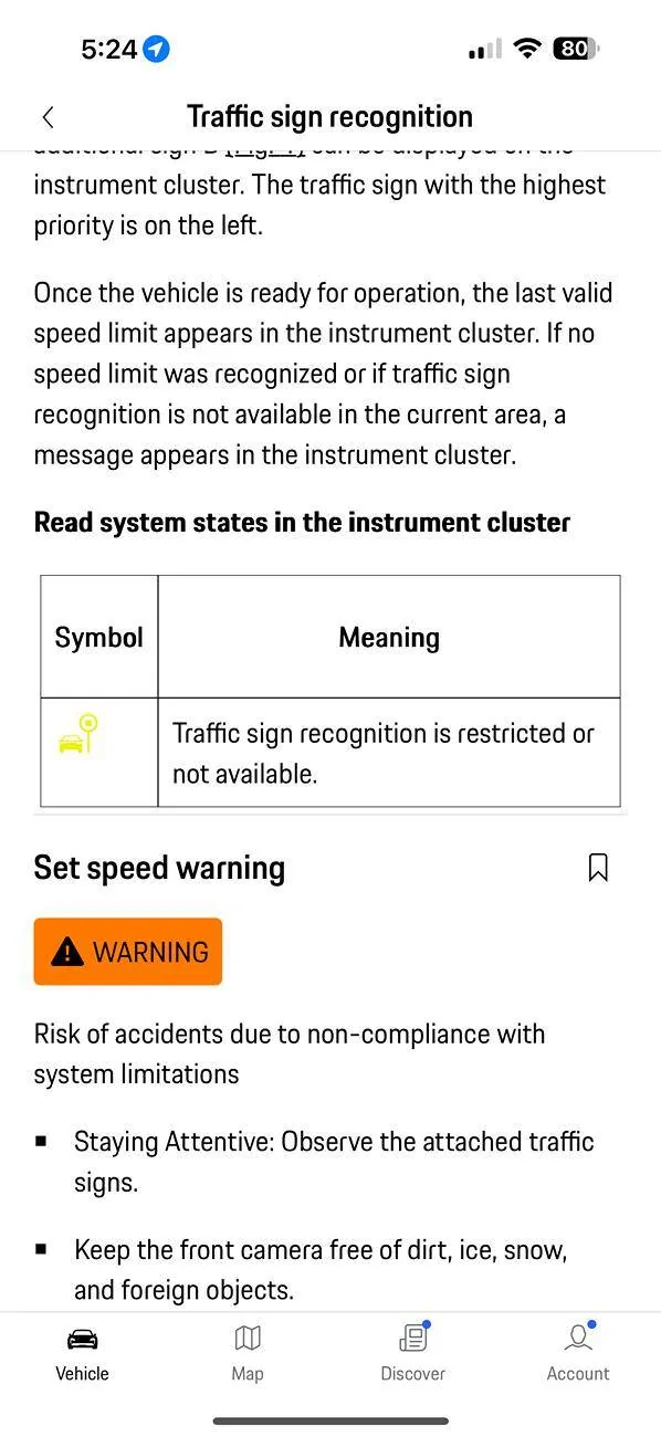

It is in the manual under display elements. See attached.
Thank you!! I did not see it in the print copy, but just downloaded in the app and was able to find it based of what you posted. Appreciate it!
It has come on twice when it has been heavy rain.
