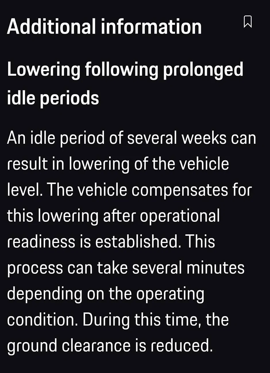

I’ve also noticed the Macan lowers itself if I’m in normal height mode after being parked. Don’t know if this is built into the system or can be engaged or disengaged.
