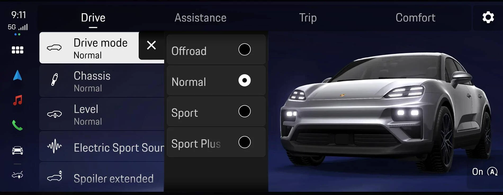

This is odd. If you optioned Sports Chrono then you get Sport+ Drive Mode as shown here. Then the Mode Dial screen should have Sport+ as an option.

yeah, sounds like he didn't option the chrono package

There is Sport+ for the suspension only if you didn't option the Sports Chrono package. That's different from the Sport+ drive mode which adjusts throttle response and steering.
None of the modes have any effect on steering ratio. Unlike other brands, Porsche does not change steering weight with modes. Any change to steering feel is simply a result of increased throttle sensitivity and less computer nanny.
Sport+ for the eMacan alters throttle response, suspension, and PSM (traction control). Sports Chrono also gets you PSM Sport, which is between fully activated and fully deactivated.
