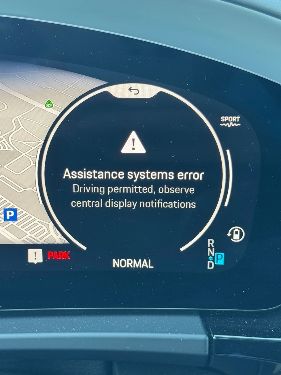

My car has been parked in the garage for about three weeks while we were on holiday. Mysteriously the battery drained overnight from ~85% to ~65% after about two and half weeks. Then down another 1% overnight earlier this week. I tried plugging into my home charger when we returned home, but it took three tries before it would start charging the battery. Yesterday I drove the car for the first time since we returned home and about three miles from home after leaving my garage I received the systems warning screen. It did not clear after multiple stops for lunch, shopping, car wash, etc... Time to deal with the dealership.
Electric Macan EV Assistant Systems Error - Again IMG_8262
