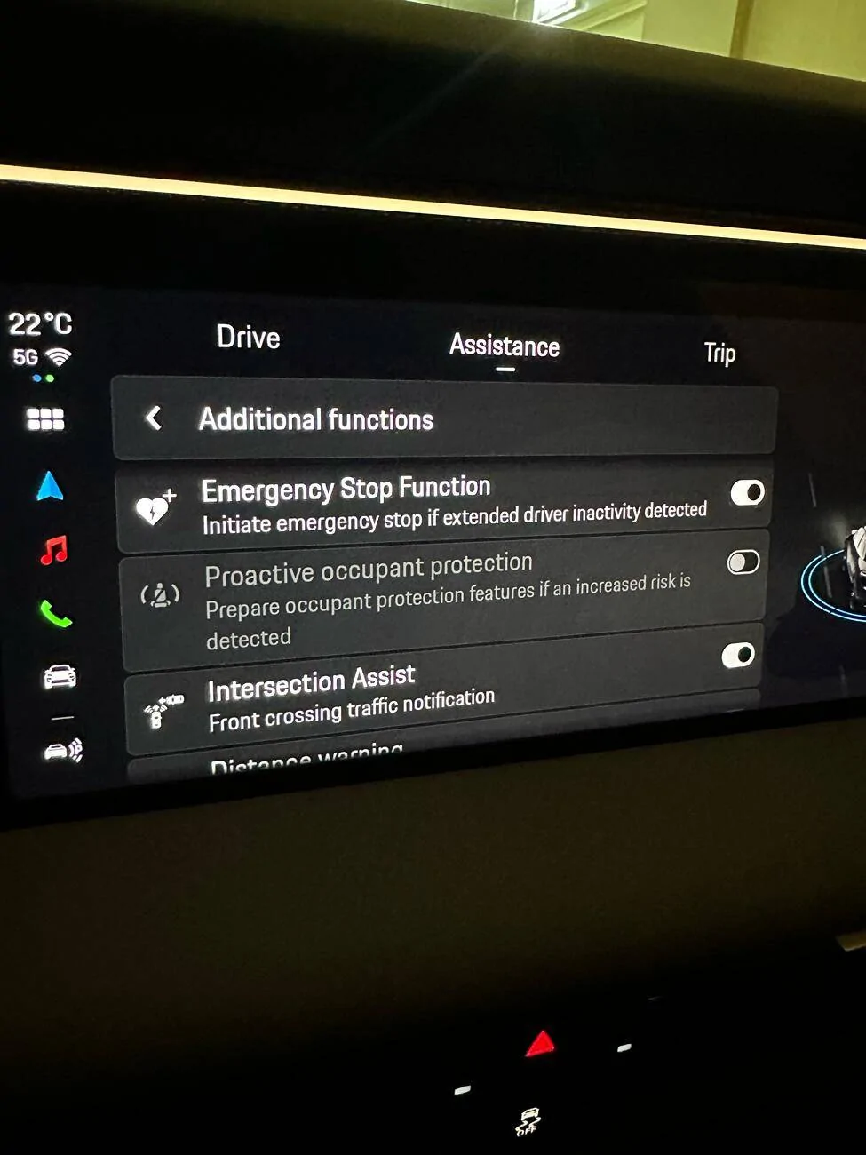

Tried restarting the car and shutting it down but the error still shows. Any tips other than sending it for service?
Edit: Check if you have PSM off. For some reason when PSM it's off, there is no icon on the dash.

Did you try to get off the car, close it, waiting some minutes and then opening again?

"When PSM Sport mode is switched on or PSM is switched off, proactive occupant protection is automatically deactivated."

It keeps on coming back even with PSM on. Might be due to rain blocking the front camera because it comes and goes randomly.

I dont' think so. We had and have heavy rain here and it never happened to me...
