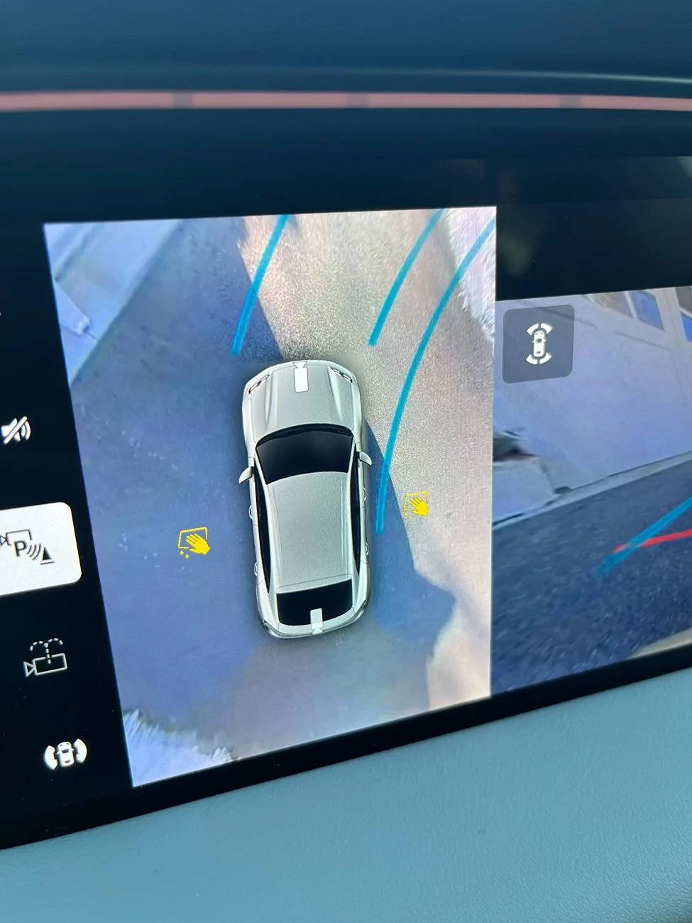

Has anyone come across this warning on the surround view screen - with little yellow hands? i'm also seeing an "assistance systems limited" warning on the driver console. i guessed it meant that some cameras/sensors were dirty so have cleaned them all but still get the warning. any tips?

Your guess was correct - the manual describes the icons as meaning - Sensor dirty. System not available or only has restricted availability
if you’ve cleaned all the sensors and then locked the car and left it for a bit then it must be a faulty sensor ?
Yes. I had this exact issue and no matter how many times I cleaned the sensors under the side mirrors, the message would not go away.
I took my Macan 4S to my local dealership and they cleaned all the sensors. The dealership told me there was a waxy buildup on the sensors they were able to remove. I suspect the waxy buildup was from when I had my car detailed six weeks ago. My dealership did not charge me for the service. I hope this helps.
