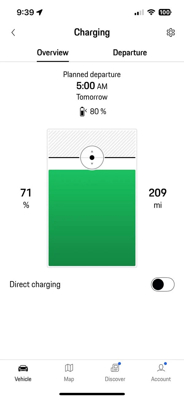

Do you have a departure time set or did you toggle “Direct Charging” to on? If Direct charging is on or there is no departure time, your car will charge immediately. In the screenshot it is set correctly to delay charge before 5AM. Also, you should see a pulsating blue light and “charging paused”
Electric Macan EV Car charged before optimized charging schedule IMG_1670

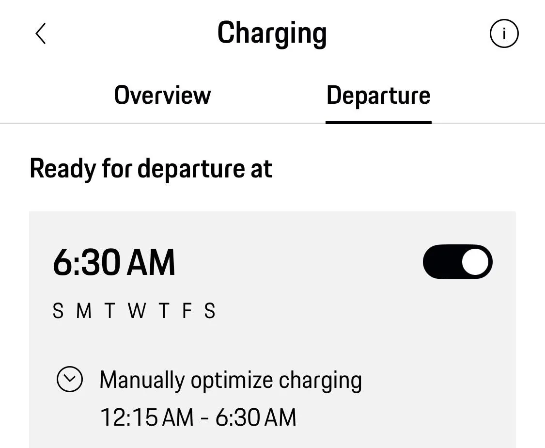

Quick update. It seems the one night was a fluke as it hasn’t happened again since… The departure is set properly & direct charging has never been toggled on. The car was around 55% the night it started charging before the set departure time.
Electric Macan EV Car charged before optimized charging schedule IMG_3180
