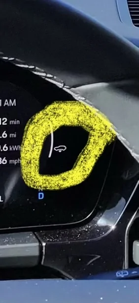

What is this icon? I don't notice a pattern when driving and can't find it in the owner's manual. It's an outline of a car in white, with a small white triangle underneath. Is it something to do with the air suspension? Is it a reference to the mythology that the earth is balanced on the back of a turtle?

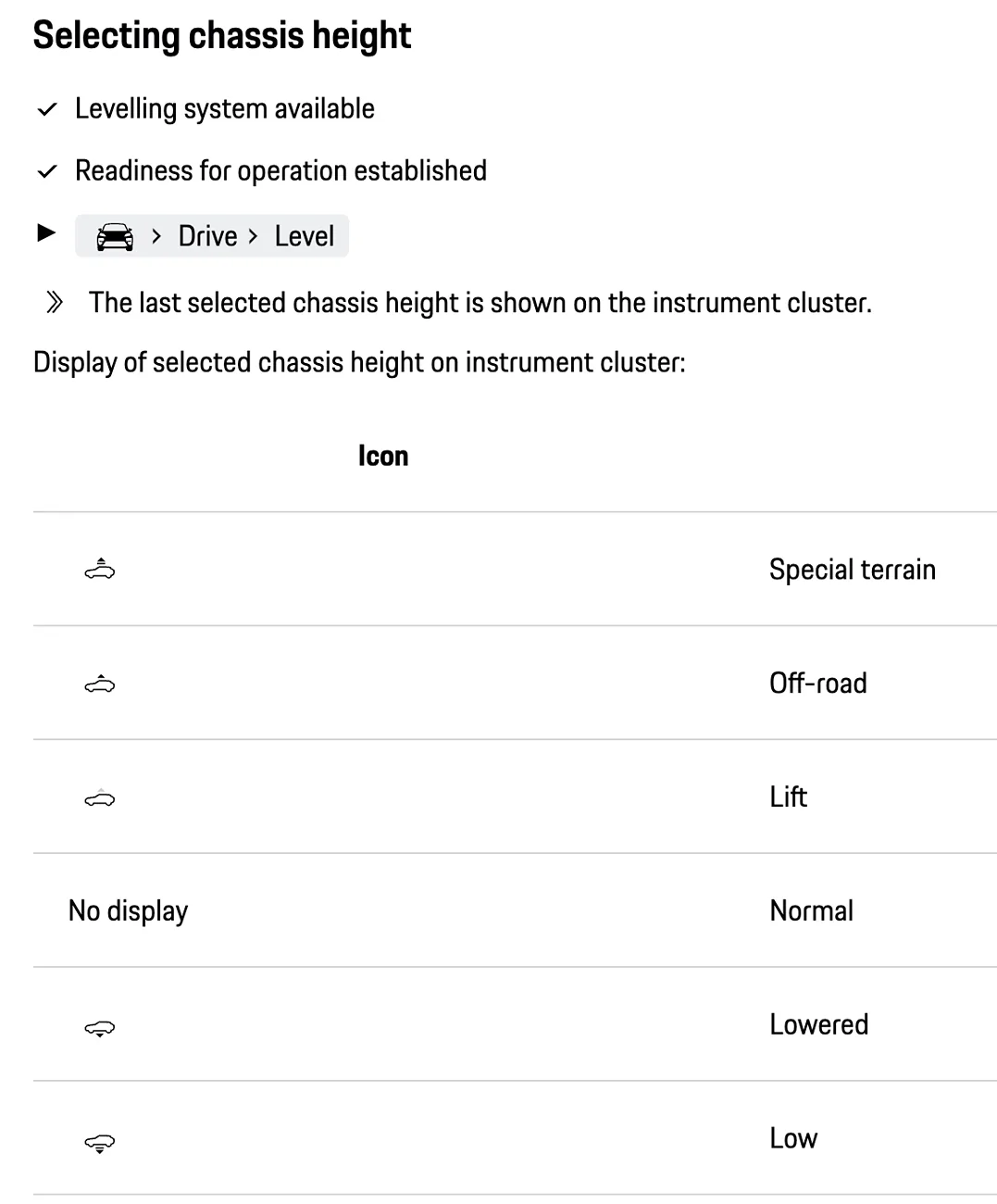

Thank you so much! That makes sense. I was looking in the section with all the colorful icons.

The car auto-lowers when you go faster than some speed (I want to say 50 mph or so?)
It also goes lower in sport, and higher in offroad or "smart lift location" mode.
That's what this icon shows. It also blinks with little arrows inside the car, as it adjusts to a new mode.
