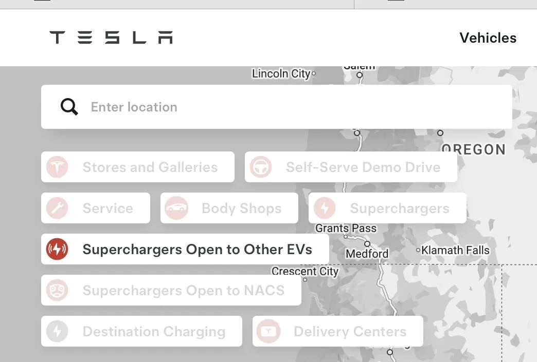

this site will show you "MagicDock" superchargers that you can use with your Macan EV today
https://www.tesla.com/findus?v=2&bounds=45.93948220337085,-100.4746153805812,30.472090127071716,-130.7089903805812&zoom=6&filters=party
simply set up the filters as shown below - and the map will show you only sites w/MagicDocks installed…no adapter required - because the "adapter" for CCS1 is provide by Tesla at the site…
Electric Macan EV [FAQ] - North America - Road trip kit for traveling with your Macan (or an EV)… IMG_2372

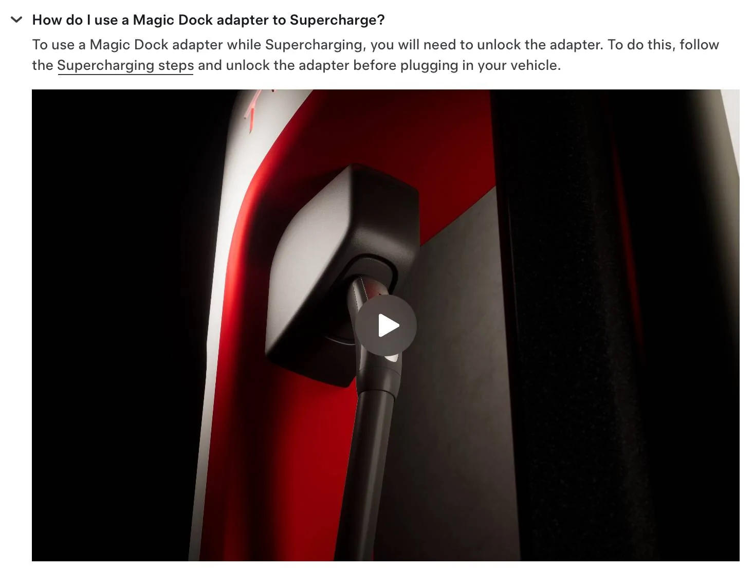

simply follow the steps outlined at this site - https://www.tesla.com/support/supercharging-other-evs#magic-dock to use a MagicDock
Electric Macan EV [FAQ] - North America - Road trip kit for traveling with your Macan (or an EV)… IMG_2373
