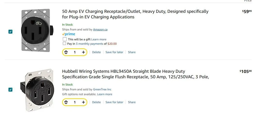

so here is my proposed order. Price difference is interesting. (CND dollars)
looks good - I'll be very very interested in your feedback comparing the new sockets head to head…I think it will be a great contribution to the EV community if we learn first hand that both sockets are an equally good choice, or one stands out vs. the other as either better or worse…
thanks for doing this!
in both cases I think either/both of these sockets are a higher quality upgrade vs. your current Leviton sockets in your garage.

I agree - I found it whlie looking on amazon to give you @shawn a link for purchase ;-)
would not have found it if it was not for you!!!
I love this!! we're all learning as we go and new information is happening!!
I love this.

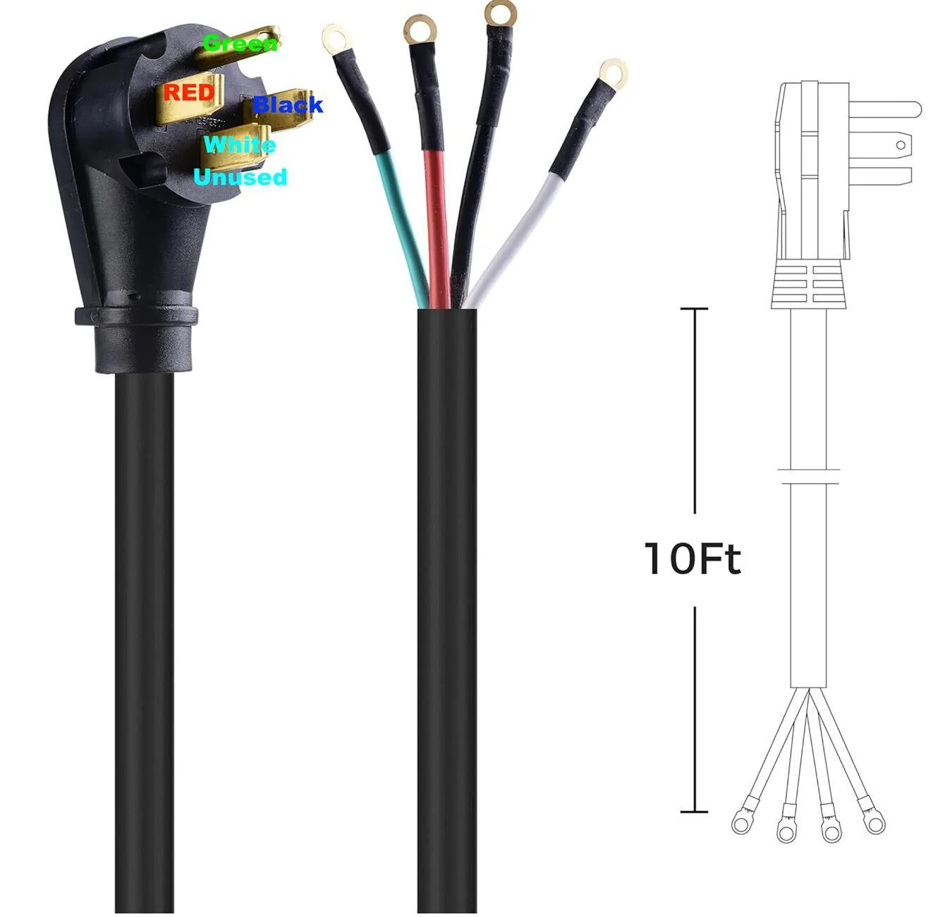

NOTE: _ANY_ hardwired EVSE in North America can be "converted" to a plug based EVSE with this cord from amazon (or similar) - this cord is rated for 50 amps - it's 4 wire, so you just won't use the white/neutral wire.
Max allowed circuit size for _ANY_ NEMA plug-based EVSE in North America is 50 amp circuit breaker - 40 amp charge rate - EVSE's running at greater than 50/40 amps MUST be hardwired as-per 99.9% of building code regulations - therefore _IF_ you're going to install a "hardwired" EVSE and use a cord like this one (or similar) then you MUST limit your EVSE to 50/40 amps (9.6 kW max charge rate).
the cord linked in this posting is a NEMA 14-50 plug-cable - 4 wires - 2 hots, 1 neutral, 1 ground - Neutrals are un-necessary/unused with North American EVSE's. (there is not even a place to attach/connect a neutral wire inside of any hardwired EVSE I've ever installed - so you just push the white/neutral wire aside inside the EVSE box and put a wire nut on it) - so you can simply ignore/wire-nut the "white/neutral" wire and only wire up the 2 hots and 1 ground inside your EVSE
_OR_
you can find a similar cable for a NEMA 6-50 outlet and then use a NEMA 6-50 outlet and have a "matching" 3 wire cable for your 3 wire EVSE plugged into your 3-wire NEMA 6-50 outlet
there is nothing "magic" about a plug based or hardwired EVSE - with plug-based EVSE one end of the 3/4 wires is "molded" into a "plug" and the wires soldered/connected to plug-blades and encased in plastic…
in fact if you order a plug-based EVSE from enphase/clipper-creek/ChargePoint, I promise you it _IS_ a hardwired unit where they simply pre-attached a cable just like this one before they put it in the box…so a hardwired EVSE vs a plug-based EVSE in most cases is simply a matter of did the vendor go ahead and attached a cable exactly like this before shipping it to you - there is nothing "magic" here. Hardwired EVSE's just do not ship with one of these cables (much like most 240V home appliances where they leave this part as an exercise for the reader/installers).
recommend the 10 ft version - YMMV - don't take electrical advice from the internet - you're on your own if you follow this advice and things go sideways.
NOTE: one of my 3 Tesla Universal Wall Chargers is wired to a Hubble NEMA 14-50 using this exact cable - it was easy and has worked well since Oct. of 2023 - YMMV - hire an electrician if you are the slightest bit uncomfortable and let them make all the decisions.
the cable listed below has the following:
  • red wire - 6 AWG copper wire - 120V hot - overkill/overspec for 50 amp applications
  • black wire - 6 AWG copper wire - 120V hot - overkill/overspec for 50 amp applications
  • white wire - 8 AWG copper wire - electrical neutral - _UNUSED_ in EVSE wire diagrams - will be inert and never carry any electrical current - it does not matter - 8 AWG wire is good as a neutral for 50 amp applications - but again it's not used in this case!!
  • green wire - 8 AWG copper wire - electrical ground - overkill/overspec for 50 amp applications
when I wired up my Tesla Universal wall charger the hardest part of the install was carefully stripping back the thick/heavy-duty black rubber insulation from the "bare wire" end of the cable to give myself a little more length for the red/black/white/green wires to bend/feed them around the inside of the Tesla Wall charger dock (I had to free up about 20 inches of the 4 wires to nicely fit/bend inside the Wall charger dock) - so you'll need to trim back the thick heavy duty black rubber insulation to give yourself more working length of wire to attach it inside most EVSE's - this why I recommend the 10 ft version of this cable to give yourself plenty of length since you may want to trim the cable length to "fit" your particular install - trimming back the black insulation is actually the hardest part of this entire process - as you have to be careful to remove the black insulation but not also strip the insulation on the individual wires!!! This is the most time consuming and tedious part of using a cable like this - after you freed up enough length for inside the EVSE box/dock - the rest of the install is nearly trivial.
NOTE: each of the 4 bare wires corresponds to one of the metal "blades" on/in the plug head - I've labeled the blades in the picture below to match the wire color coming out the other end - red and black might be wrong - but it doesn't matter - both are 120V hot and 100% interchangeable in electrical 240V applications (it honestly makes NO difference) - green is ground, white is neutral - ground pin is at the 12 o'clock position on the plug head, and neutral (unused) is at the 6 o'clock position (but again unused in any EVSE install/scenario).
the goal of this post is NOT to make you install your own EVSE using a 50 amp prefabricated NEMA 14-50 appliance cable - it's to demystify this stuff and show people that it's actually pretty simple how this stuff works - 3 wires, and some simple wiring and you have an EVSE.
https://www.amazon.com/gp/product/B084D28DTD/ref=ppx_yo_dt_b_search_asin_title?ie=UTF8&th=1
_OR_

there are similar pre-fabricated cords for most _ANY_ North American NEMA socket - so you can do the exact same thing for 15, 20, and 30 amp NEMA outlets (the proper NEMA socket for a 40 amp circuit happens to be a NEMA 14-50/6-50 - this is apparently allowed since there is no explicit 40 amp NEMA socket)
so if you want to install _ANY_ EVSE for any circuit breaker size but have it be plugged based - simply use the correct NEMA socket - and purchase a pre-fabricated appliance cable and wire up the 3 wires (ignoring the 4th wire if your cable has it).
you can hook up your Tesla Wall Charger or ChargePoint Flex to your dryer outlet (30 amps) and set them to 30 amp breaker and use a dryer appliance cable for NEMA 14-30 or 6-30 for example…easy peasy.

Got the first one in (the Lveviton) just waiting for the Hubbell. I had a look at the CB pannel for the two separate circuits and they both have 40 amp breakers. I was a bit surprised as I thought they would be 50 amp breakers. I will ask the Electrician when the Hubbell comes in.
any thoughts on comparing the two different outlets?

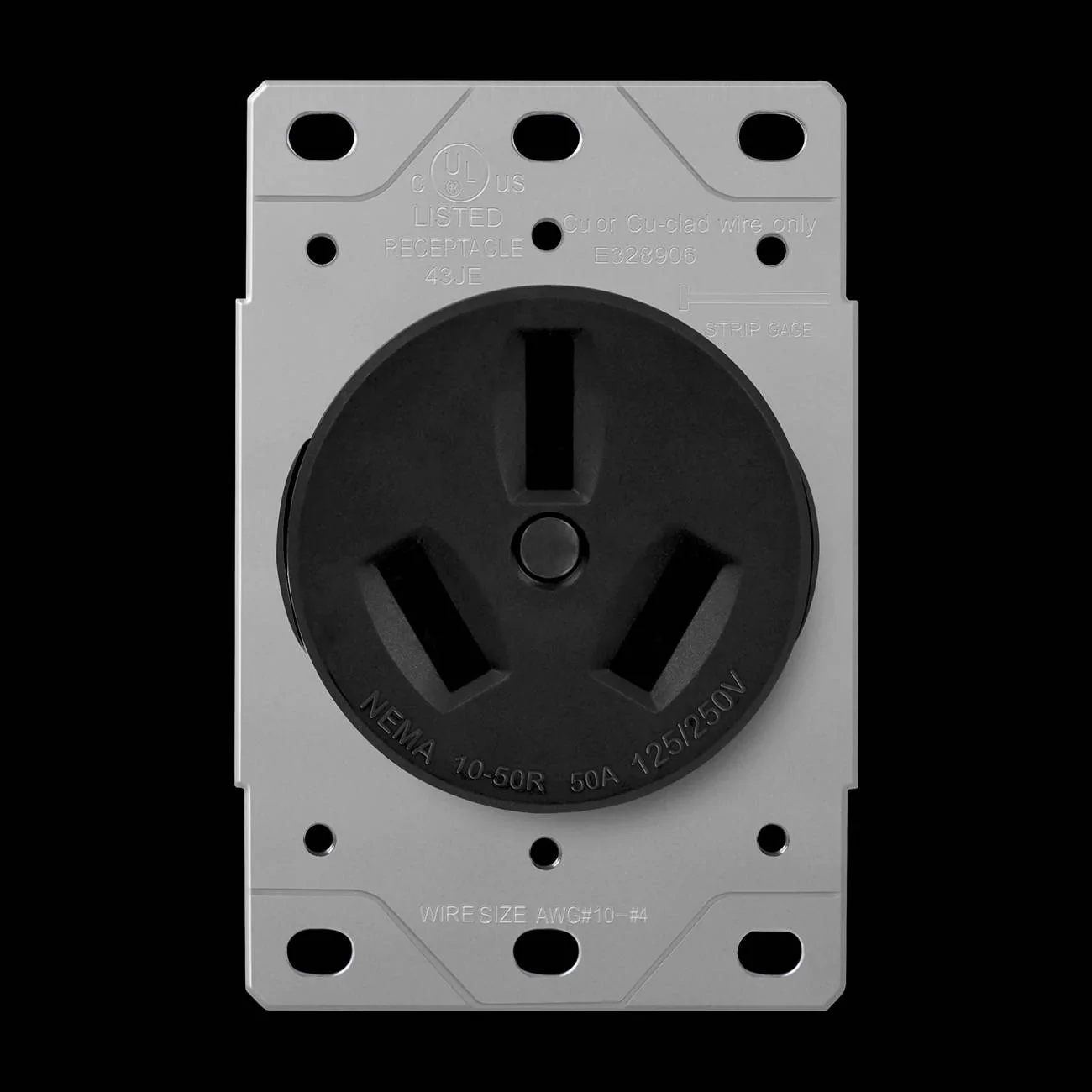

NEMA 10-50 is yet another NEMA plug type for 240V 50 amp circuit -but it's still only 3 wires and fundamentally identical to NEMA 6-50 outlet - since both are 3 wire affairs its easy to covert an existing 10-50 outlet to 6-50 outlet, or just buy an adapter - at the end of the day they are functionally identical but with a different "blade" pattern - there is no difference electrically in terms of circuit capacity - just the shape of the plug & socket…
NEMA 10-50 shown below…3 wires - 2 hots and ground -240V - 50 amps capacity - just more of the same in a slightly different package.
Both are installed and both work as expected. The Hubbell looked slightly more robust but the other was very similar. I just left the original circuits as they were so I have two separate 40amp circuits. Charge time is slow but good enough for overnight charging and I have only ever charged one at a time although I suppose I could charge both simultaneously if I needed to. The old Leveton that was removed looked pretty cheap and discoloured by comparison so I am glad I replaced it.
I appreciate the update - so you'd say one or the other is equally good and recommend both with out reservation?
Yes both are good and solid choices. Of course I would not recommend the standard dryer outlet I had before as the difference is very noticeable. it seemed like the electrian took note as well so so he won’t be using that for future EV installations ?
