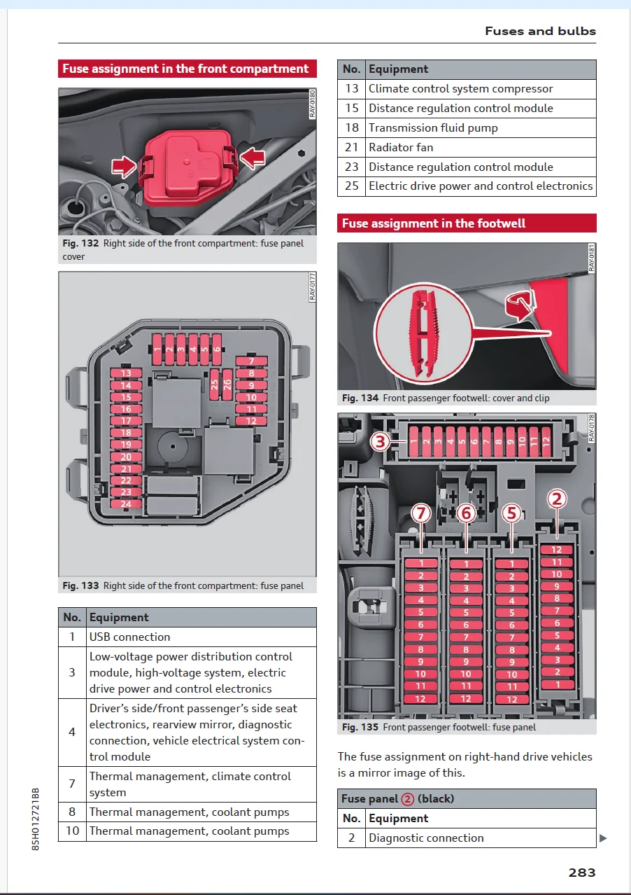

The Porsche online manual is so bad, in two ways:
1. it's really hard to navigate, because it requires clicking in and out of multiple hierarchical sections
2. it's really very skimpy on information
Meanwhile, the Audi Q6 e-tron has a PDF manual with lots more information.
Given that the Macan EV and the Q6 e-tron share a platform, it may be that some of the information transfers between them.

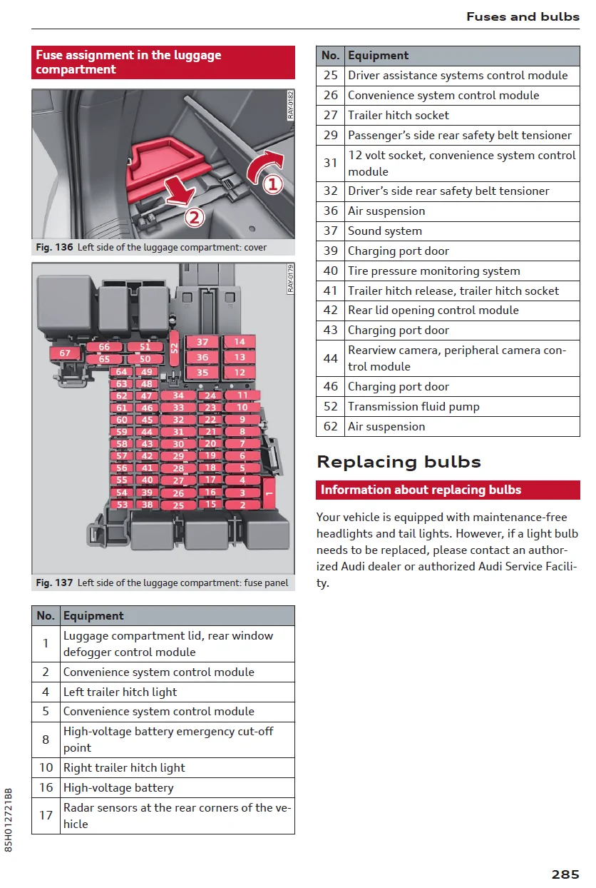

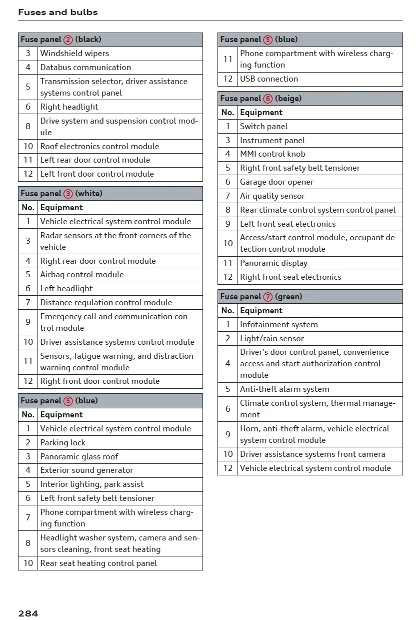

Here's a diagram of the fuse circuits for the e-tron.
Electric Macan EV Fuse assignment 1755564948332-hs
I'm not 100% sure about this, because "slot 1" is un-populated by default, and is supposed to be for the Porsche dashcam pre-wire.
Here, it's listed as "USB"
Electric Macan EV Fuse assignment 1755565018533-zk
Electric Macan EV Fuse assignment 1755565041549-x9
We shall see...

I can confirm that the dash Cam prewiring requires fuse 2 in Fig 133 for those who like to do things themselves or fit a non Porsche Dash Cam - the wiring harness is all there but they don't fit the just ( 5 amp ) this is an ACC power line so turns on with the start stop button
