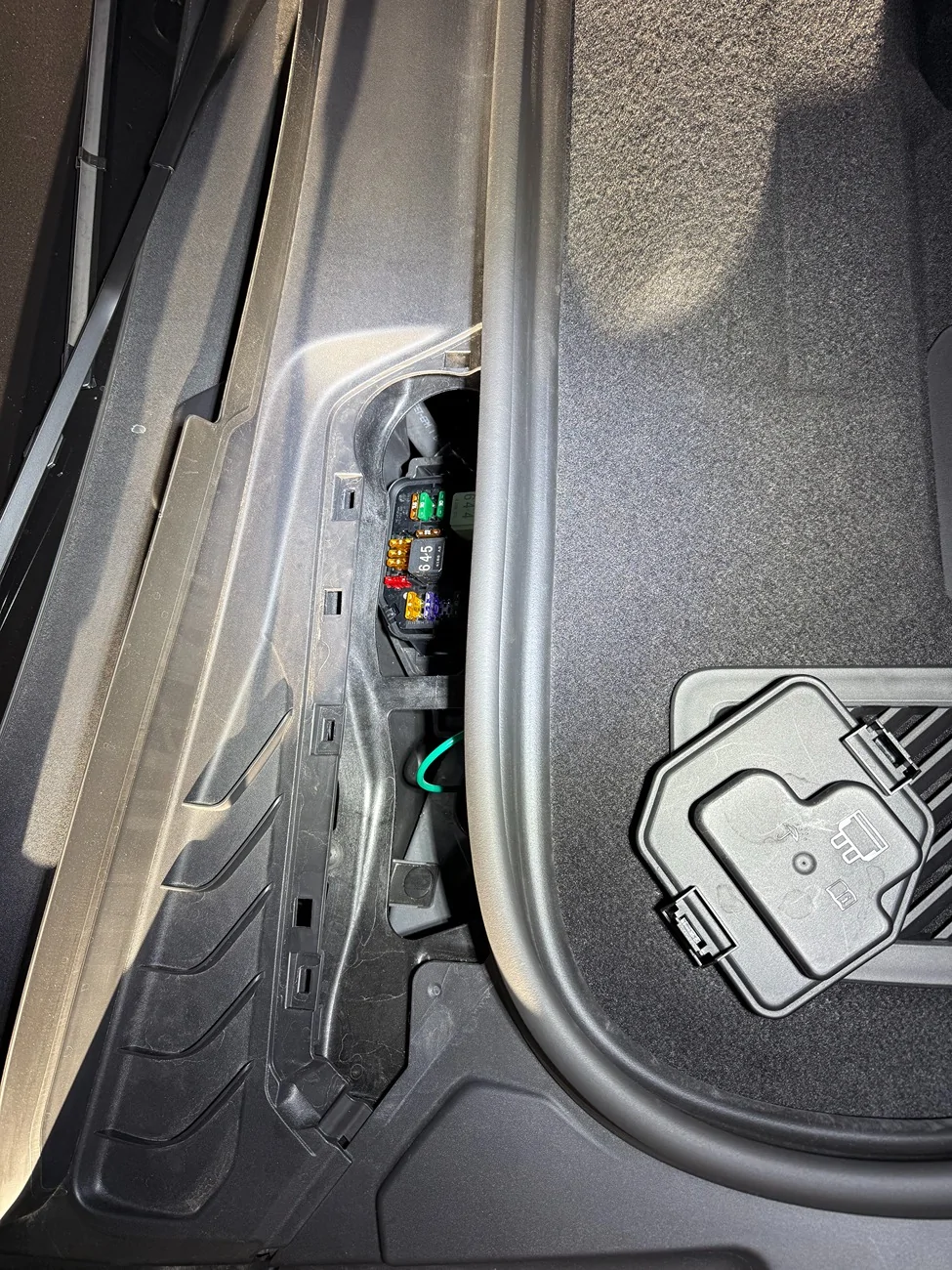

When you say “all good on the fuses”, did you install the 2 fuses required to complete the circuit to the power plug?
10amp in the frunk and 5amp in the passenger footwell are the 2 new fuses.

"all good with the fuses" is just referencing that there were no blown fuses.
Since then I found the fuse location for the dash cam preparation in the frunk. See the red fuse in the photo.
I found the one other location in the passenger footwell to put another fuse. I don't know what that fuse location is used for. But there are contacts on both sides for a fuse. What is the 5 amp in the passenger footwell for Tom?

The documentation for installing the OEM camera earlier in this thread shows the locations to put these 2 fuses, and you can be sure they are only used for the dashcam.
Here's the post that references the Porsche docs: https://www.macanevowners.com/forum...on-issues-fuse-box-location.17100/post-276977
The 10amp in the frunk fuse box for the ACC connection and is switched - and it goes off when the car does, not 30 minutes later.
The 5amp in the passenger footwell is for continuous power and is not switched.
My dashcam hardware detects when the car is off for Parking Mode and uses the continuous power at a lower amps for that, switching off entirely when the voltage drops too much.

That red fuse and fusebox -- it's really hard to reach, at least without dismounting the whole frunk container tray.
Did you have a way to get in there?
336
336
Luckily, the red fuse is situated in the easiest part of the fuse box to reach without removing the whole thing. You might need to re-tuck the rubber frunk surround when putting it back together, but snapping off the cover and opening the box gave enough access.
My installer did the work, and this wasn’t the trickiest part. Getting the lid off was easy, putting it back on involved pulling out the rubber surround enough to get access.

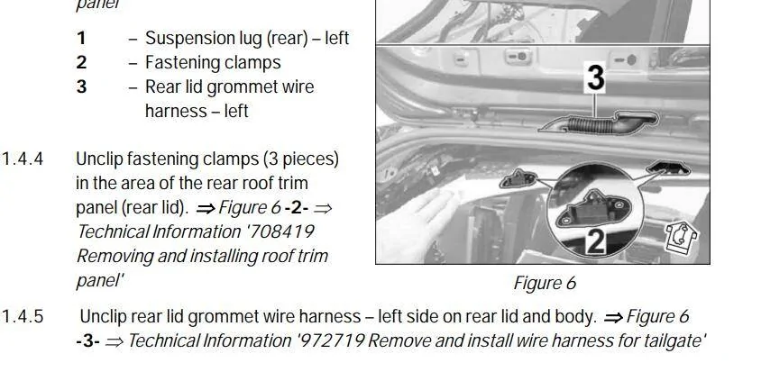

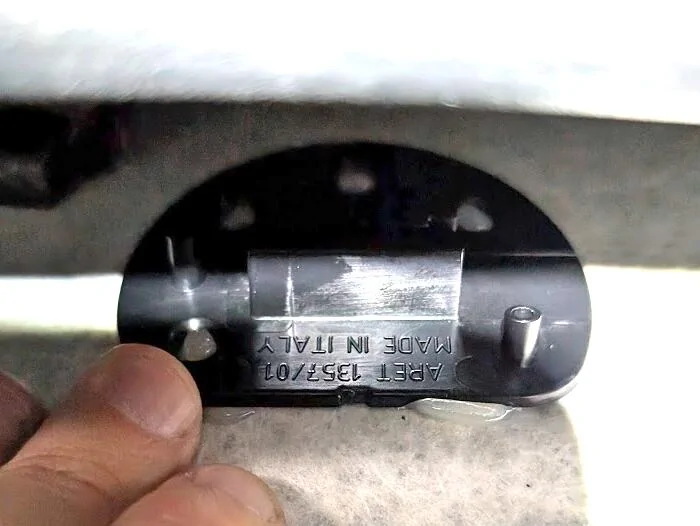

The only casualty was one of the fastening clamps on the roofliner. Hopefully that is a piece that can be replaced easily.
I've attached the image of the piece. Seems like there is a better way to remove these that doesn't involve pulling down.
The back was certainly a bit of work versus doing this on a pre-wired Cayenne (only removing one piece of trim). This involved the four panels a torx screw and a 12-point m8 screw (got a bit at O'reilly for this).
