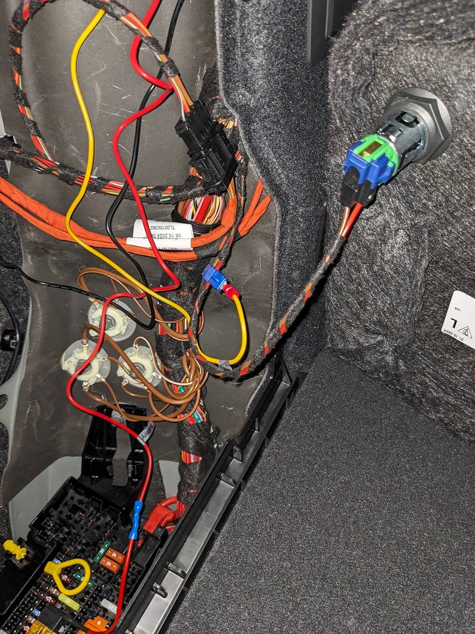

Sorry, boot is an English term clearly! As you open the 'luggage compartment' on the left side pull the whole recessed trim piece out that holds the 12V outlet and the fuse box is underneath:
Electric Macan EV Dashcam installation issues -- fuse box location? PXL_20250201_175324608
I've not dared pull fuse 8 yet, but it appears it would disable the HV battery as it has an emergency responder tag on it and then driving would not be possible. I've not dared pull it as I don't know if the car would need a reset afterwards - are you willing to be our guinea pig? ?

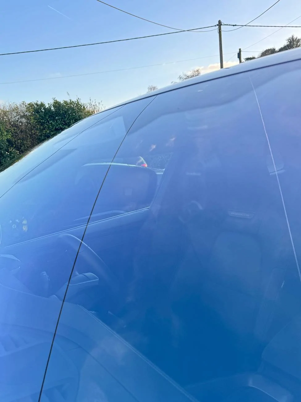

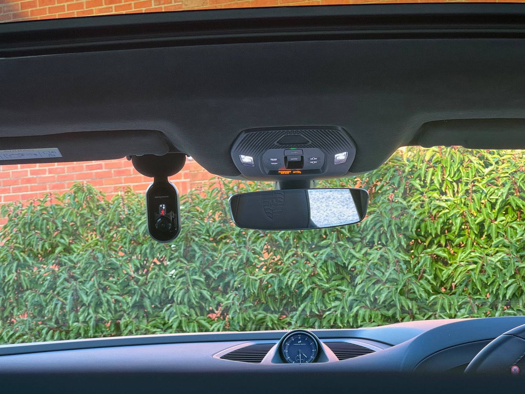

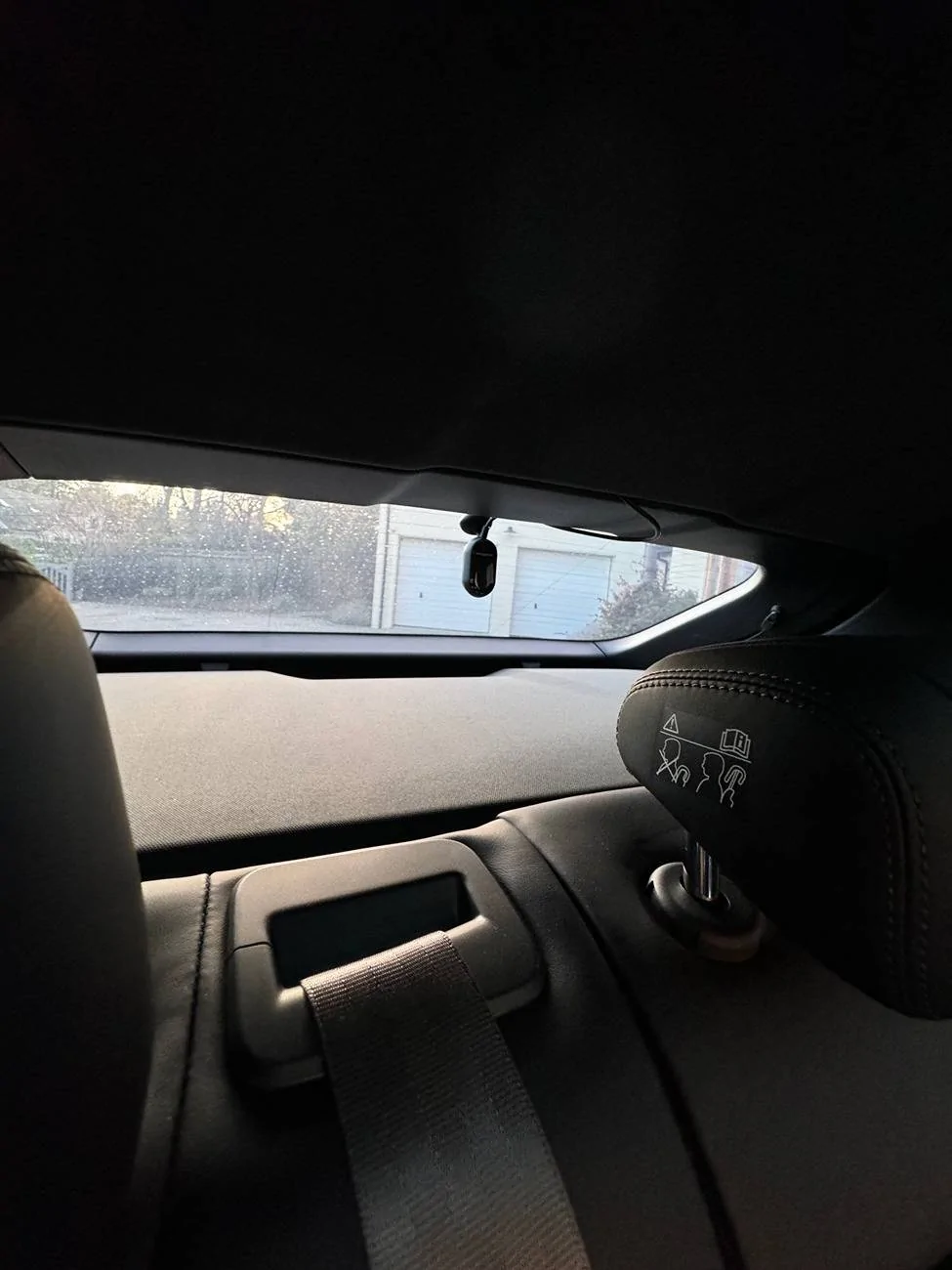

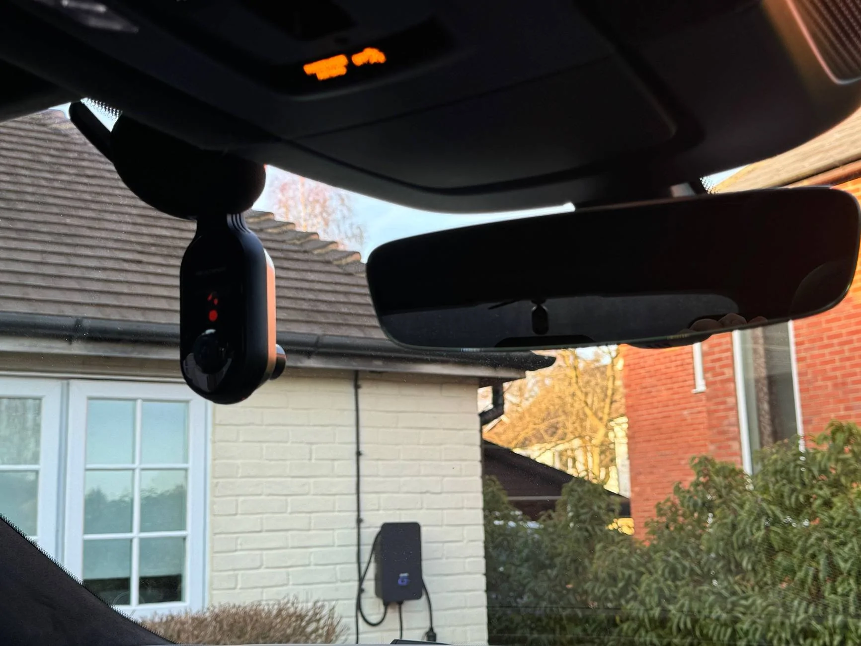

Sorry this took so long to get the photos and post, but here are some photos showing the camera install. Both in position and showing the cable into the OBD port etc. so no need for fuses etc.
Parking mode works fine, uses voltage drop to know when the car is 'driving' and when turned off. Cellular connected so can remotely access the camera (interior, front and rear) as well as grab videos when needed. Can speak remotely to the driver also if you have loaned the car out to someone else and it can also have alarms for speed etc. if you want.
It's a NextBase IQ Camera.

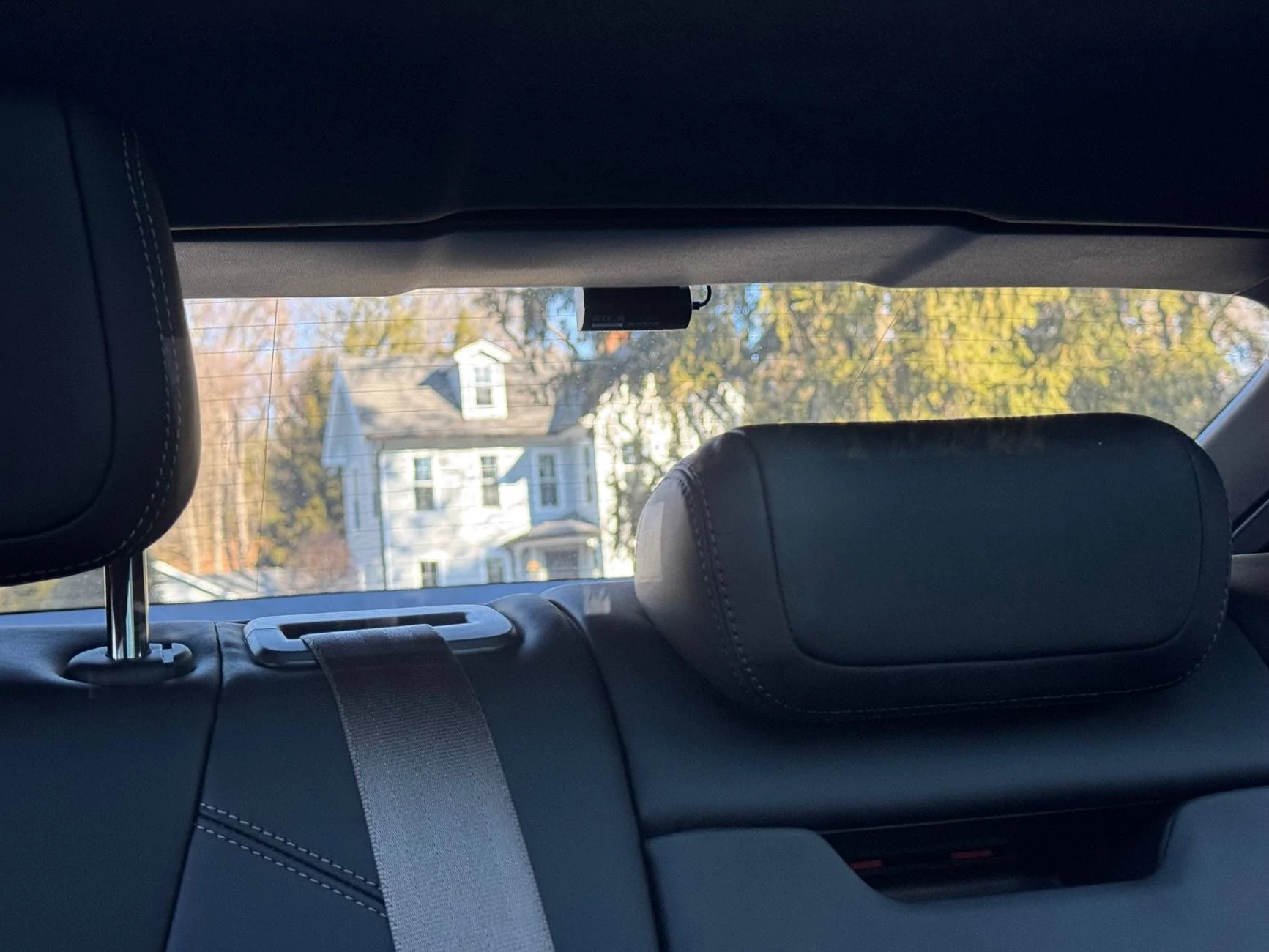

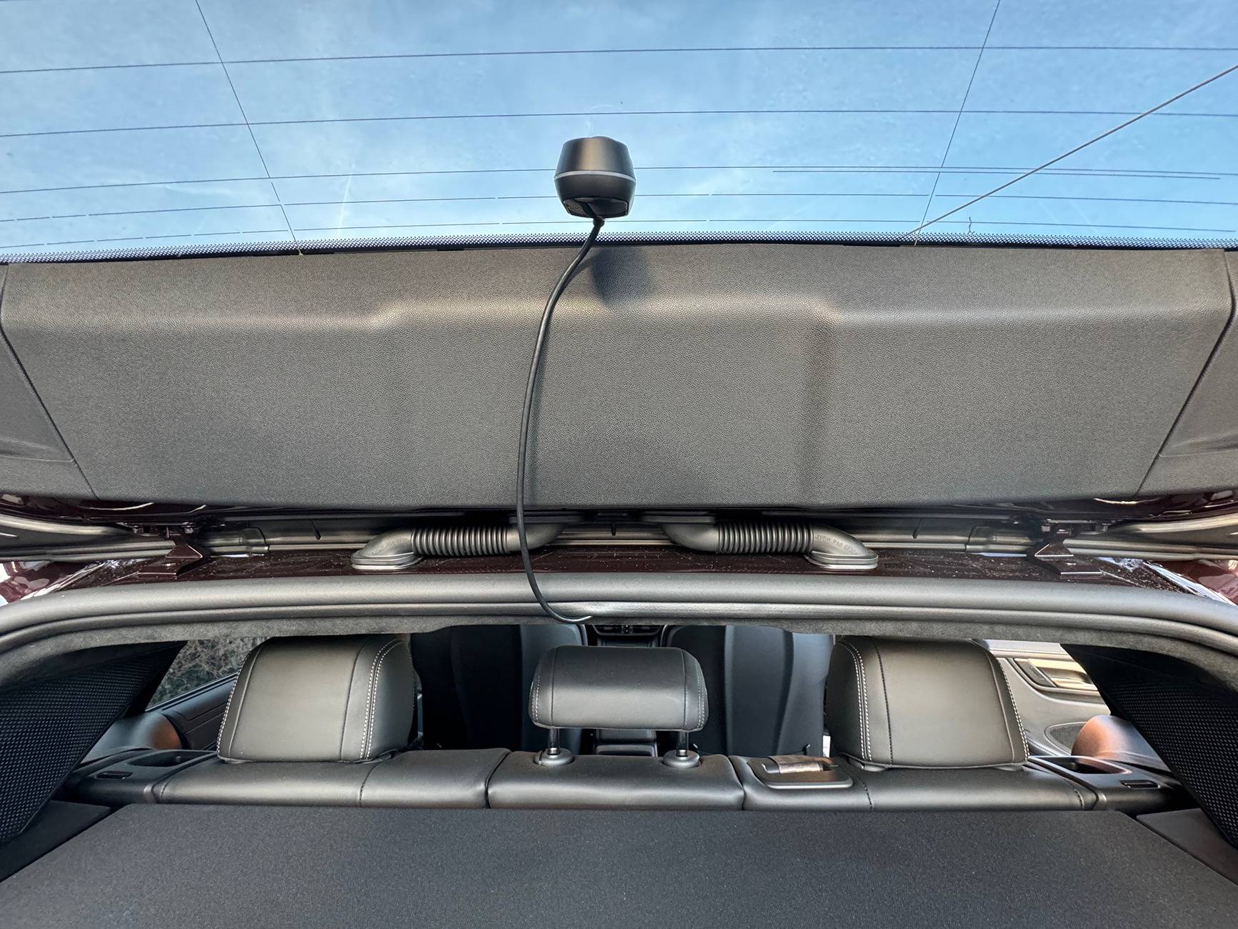

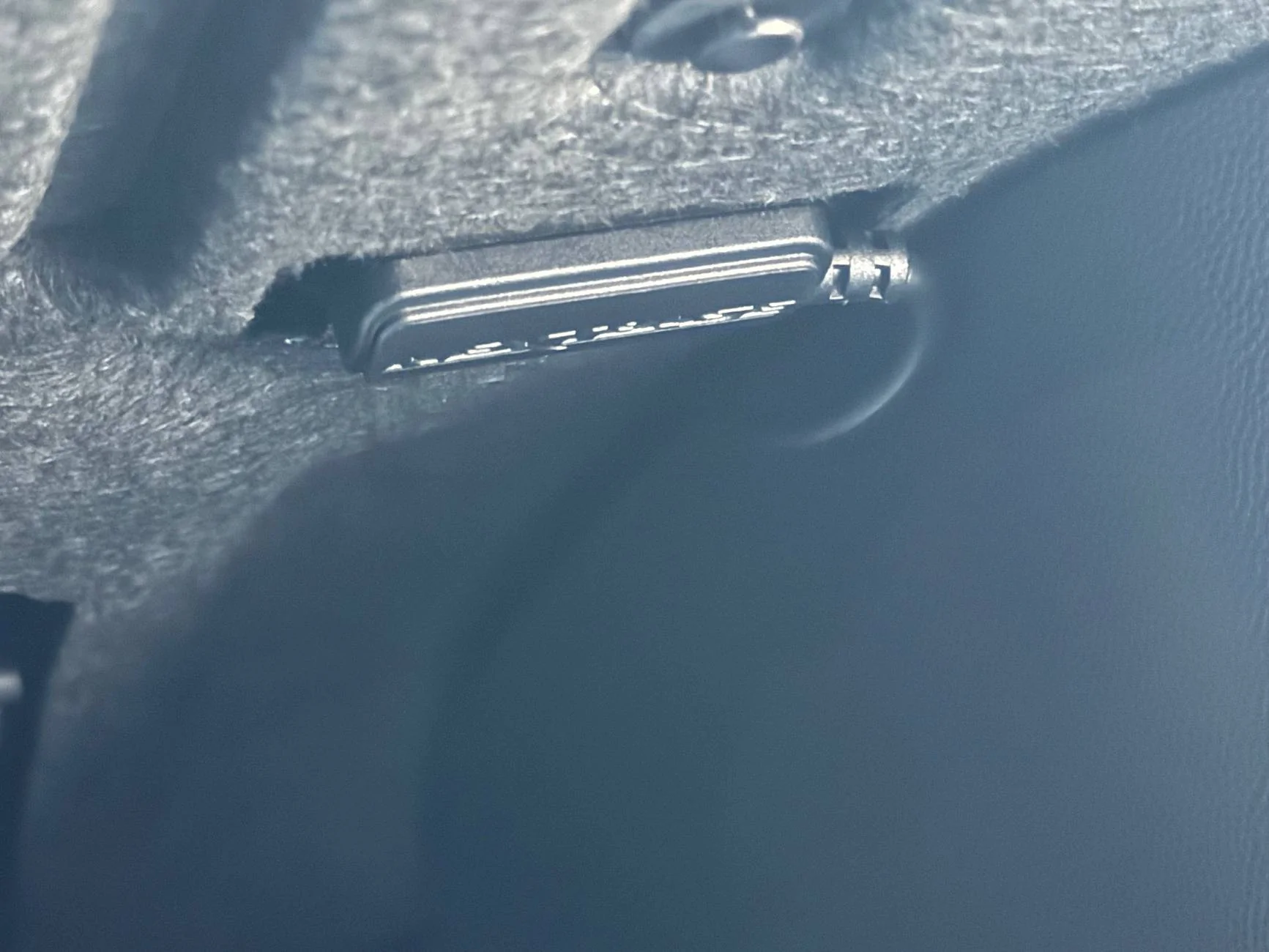

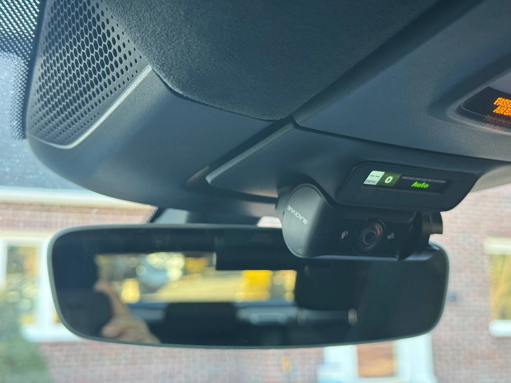

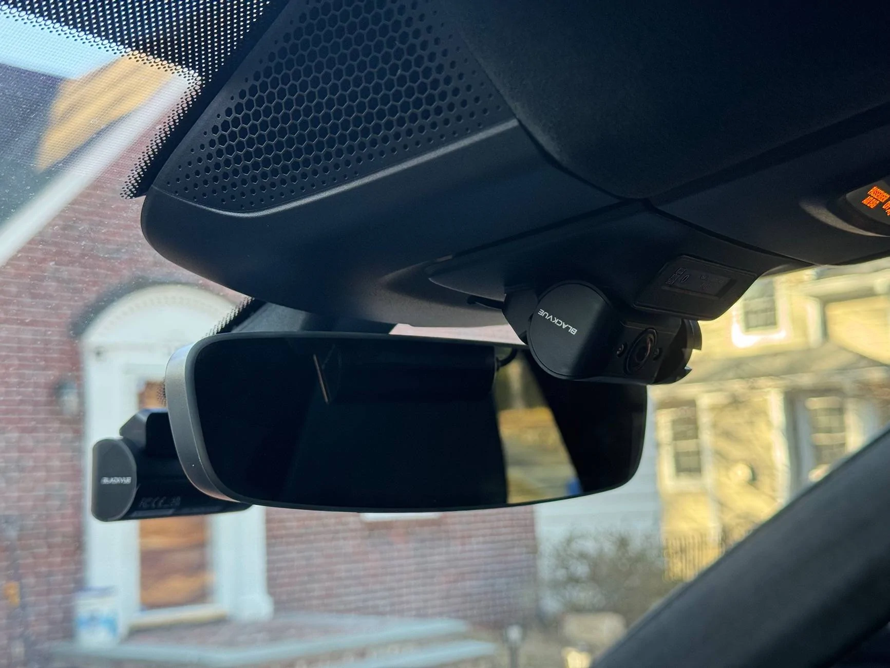

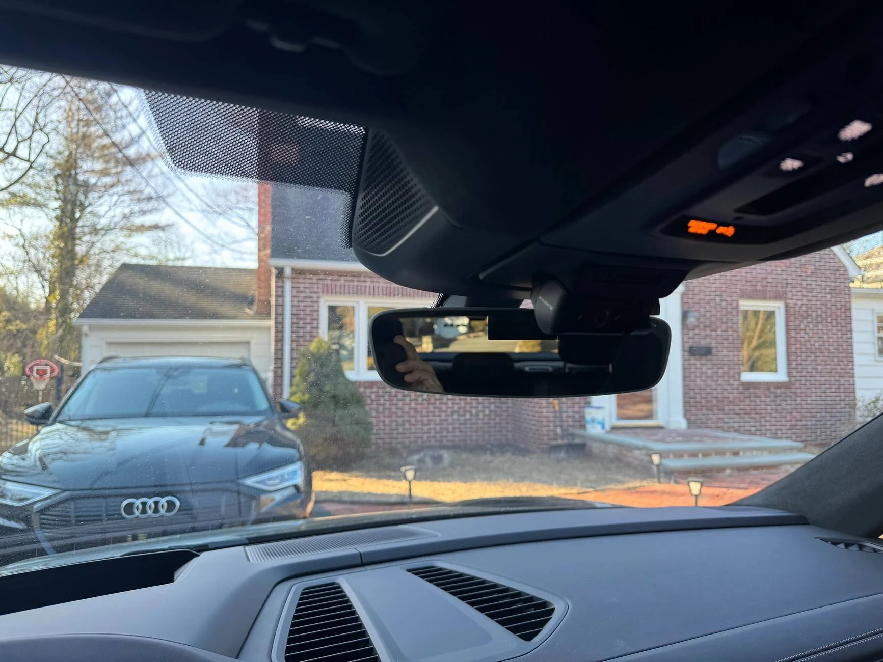

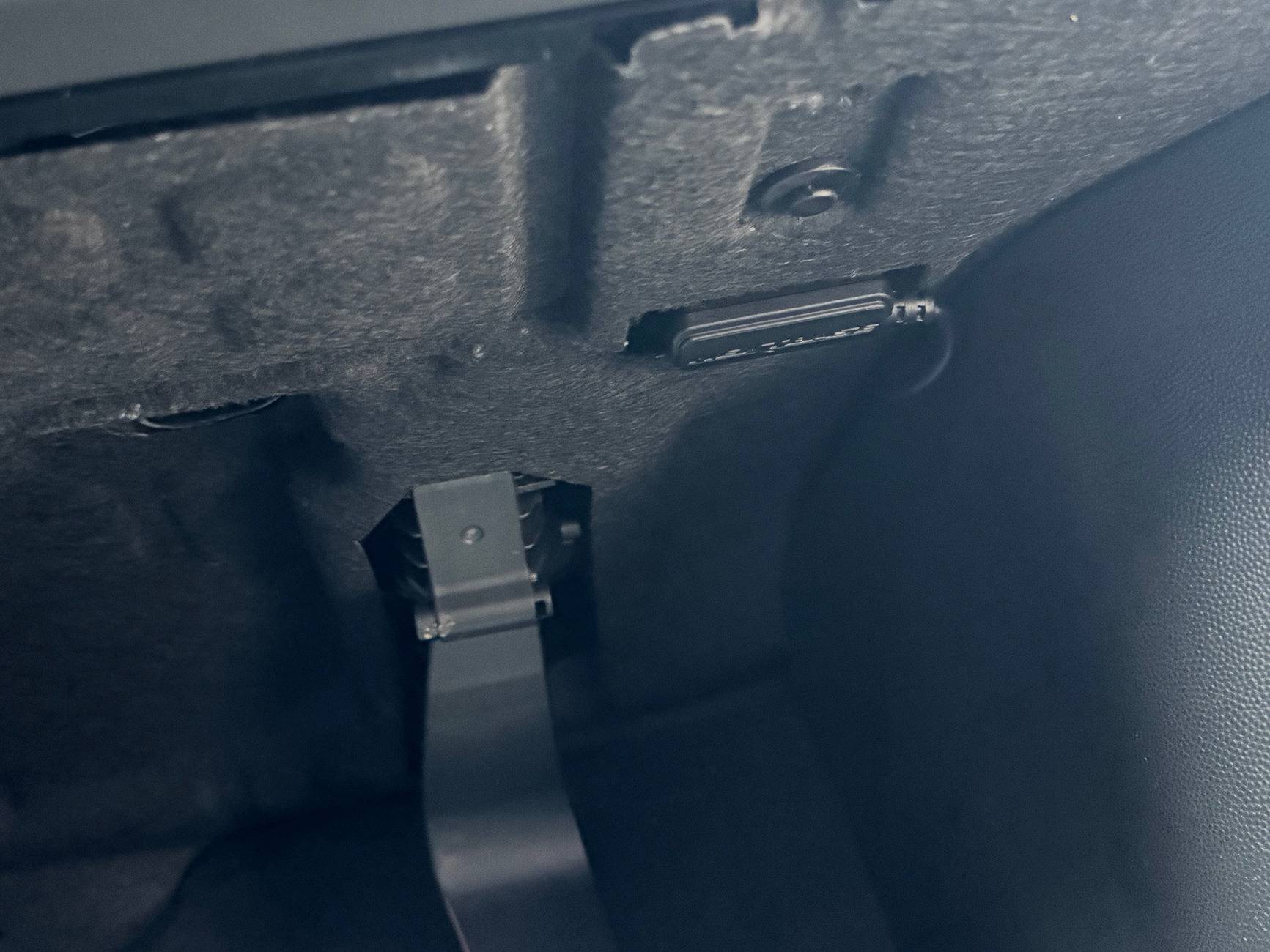

Here is my BlackVue install. 3ch front back and interior. Also with remote LTE and additional battery to take less of a strain on the interior. It also shuts off if needed when the voltage goes below 12V. To make sure the car will still operate just in case the dashcam depletes the interior.

Wow clean install! Any more pics of the front? Just curious to see how much of the cord is able to be hidden vs say the fitcamx
