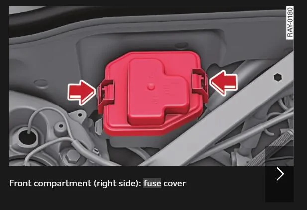

Bump. Has anyone been able to locate the "fuse holder A (front end)"?
Yes, the one in question is in the front, behind the passenger side removable cowl panel. I didn’t take a picture because I was only there looking to see if I could access the 12v battery.

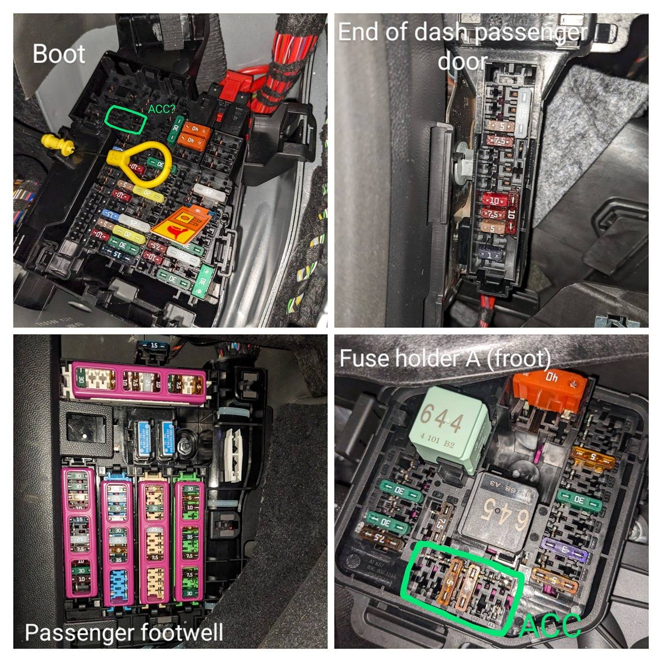

Thanks for the above fuse panel location! I managed to find it although its sadly not useful for fuse taps due to being in a sealed box and I cant see how you would run a wire from the front compartment to the interior?
As I see it a quick summary of the available fuse boxes below, note I have a RHD car:
  • Front passenger footwell: No switched fuses, except the single 15A fuse at the top which is always dead, not shown on Q6 fuse layout.
  • End of dash/passenger door: No switched fuses, entire fusebox is not shown in Q6 manual.
  • Froot: The bottom row fuses 1-6 highlighted green all show 0V when the car is not in the 'ready' state, so are switched, the dash cam wiring instructions from Porsche also state to add a fuse to slot 1 to complete the circuit here, and are therefore definitely ACC slots.
  • Boot: No switched fuses except for the two empty slots 50 & 51 highlighted green read 0V when the car is not in the 'ready' state, however when inserting a fuse tap I've found these remained live when the car turns off. So its switched to some extent but not like a conventional ACC slot - a bit more investigation needed maybe.
What I would like is to hardwire my A229 Pro with conventional fuse taps - its the easy way out but I want to avoid using wire taps on the 12V outlet in the boot or the dash cam pre-wire outlet in the roof (Note the Macan manual states the 12V outlets are switched off after 30 minutes to avoid draining the battery, and fuse 31 in the boot is still live when the 12V outlet is switched off).
Electric Macan EV Dashcam installation issues -- fuse box location? 20250117_121349-COLLAGE~3

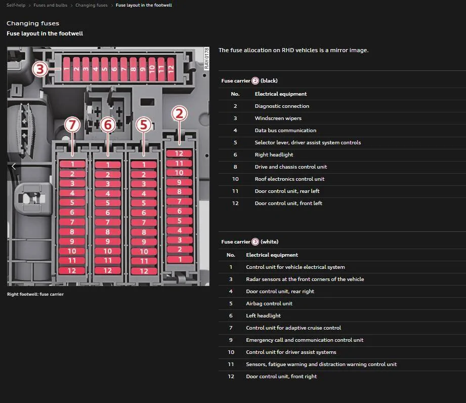

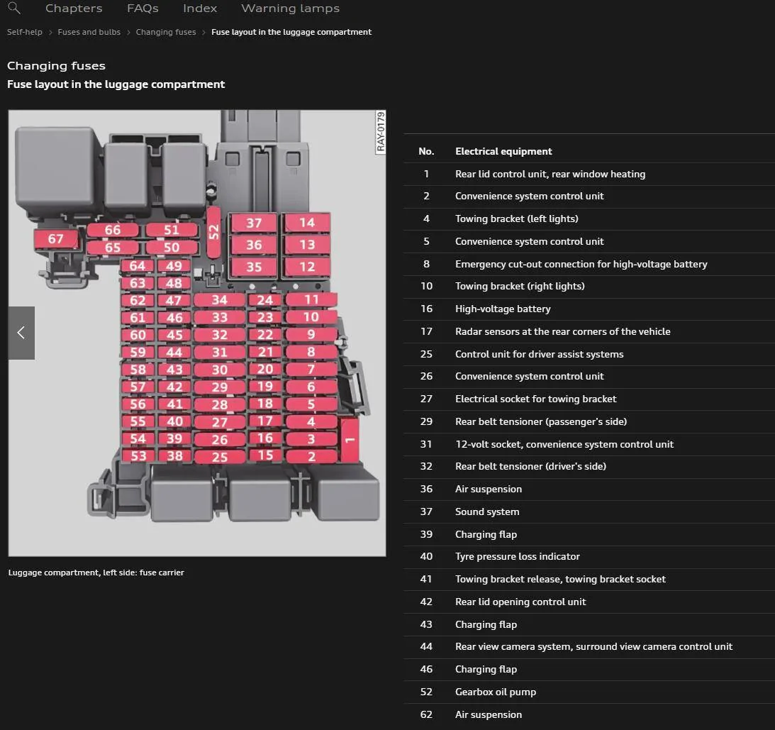

Fuse definitions from the Q6 manual attached below which matches the Macan mostly (Macan has the additional end of dash/door panel and in the footwell fusebox the additional 15A fuse seen at the top - so we dont know what those fuses are protecting)
