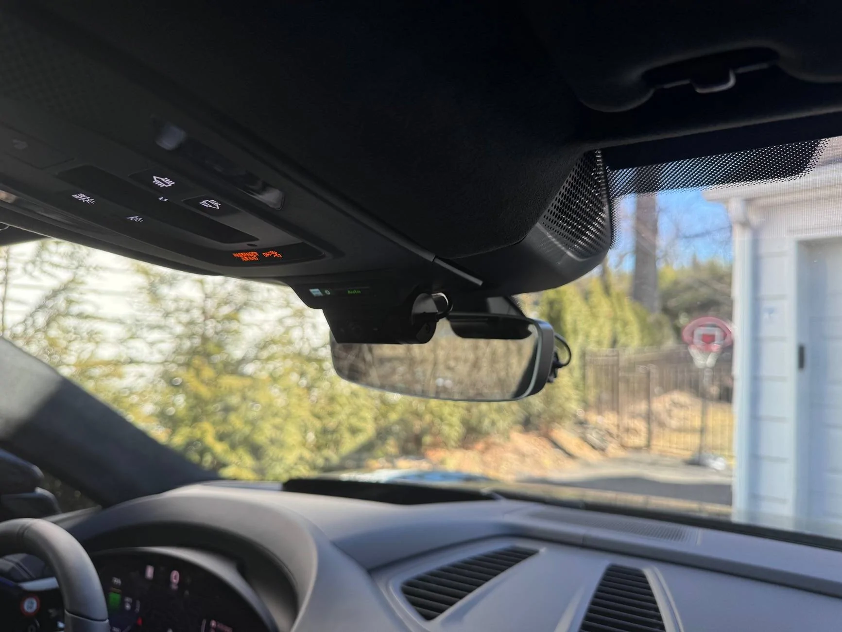

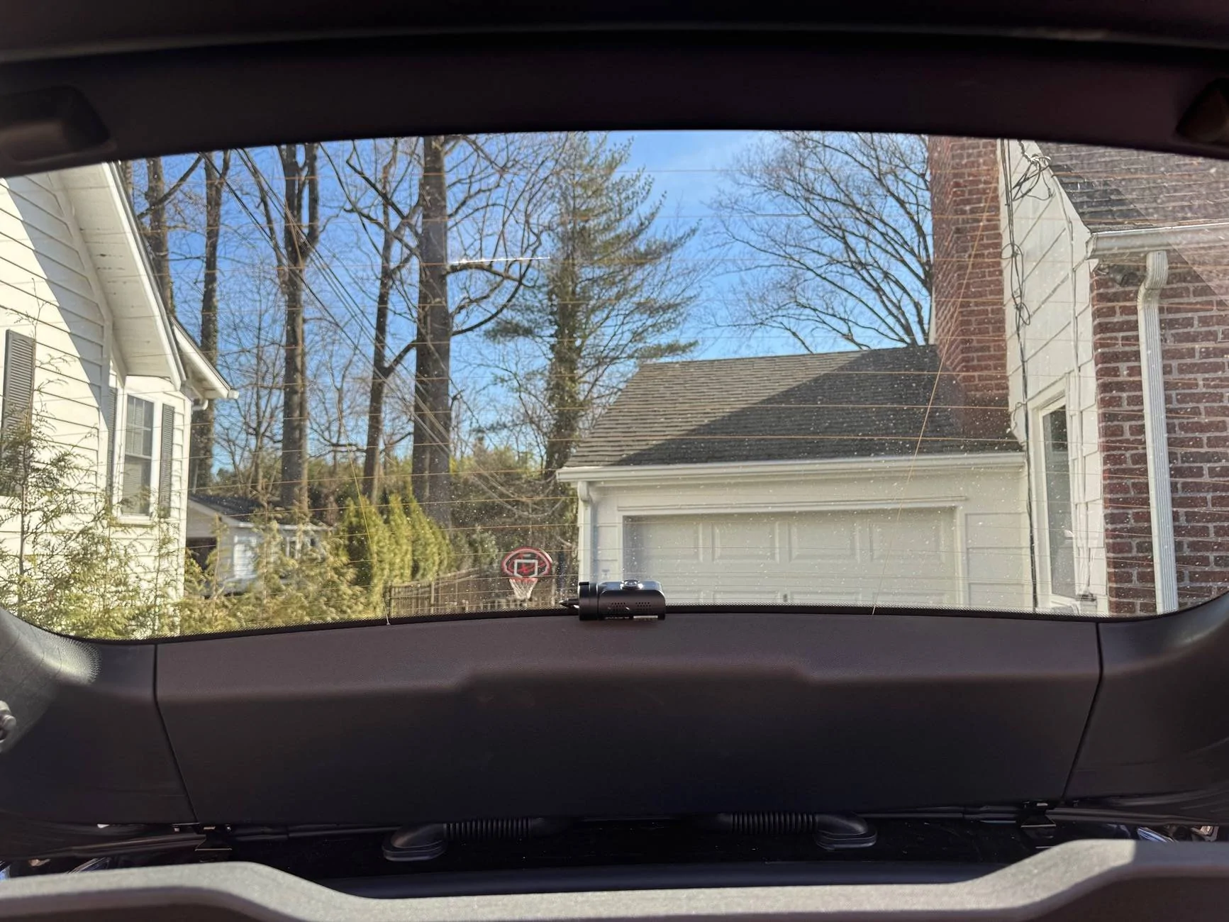

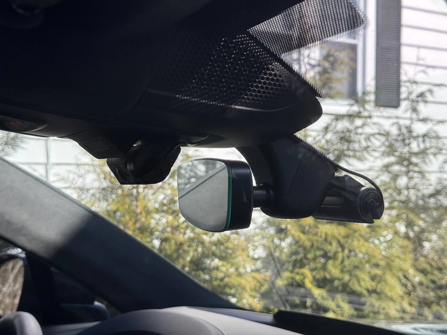

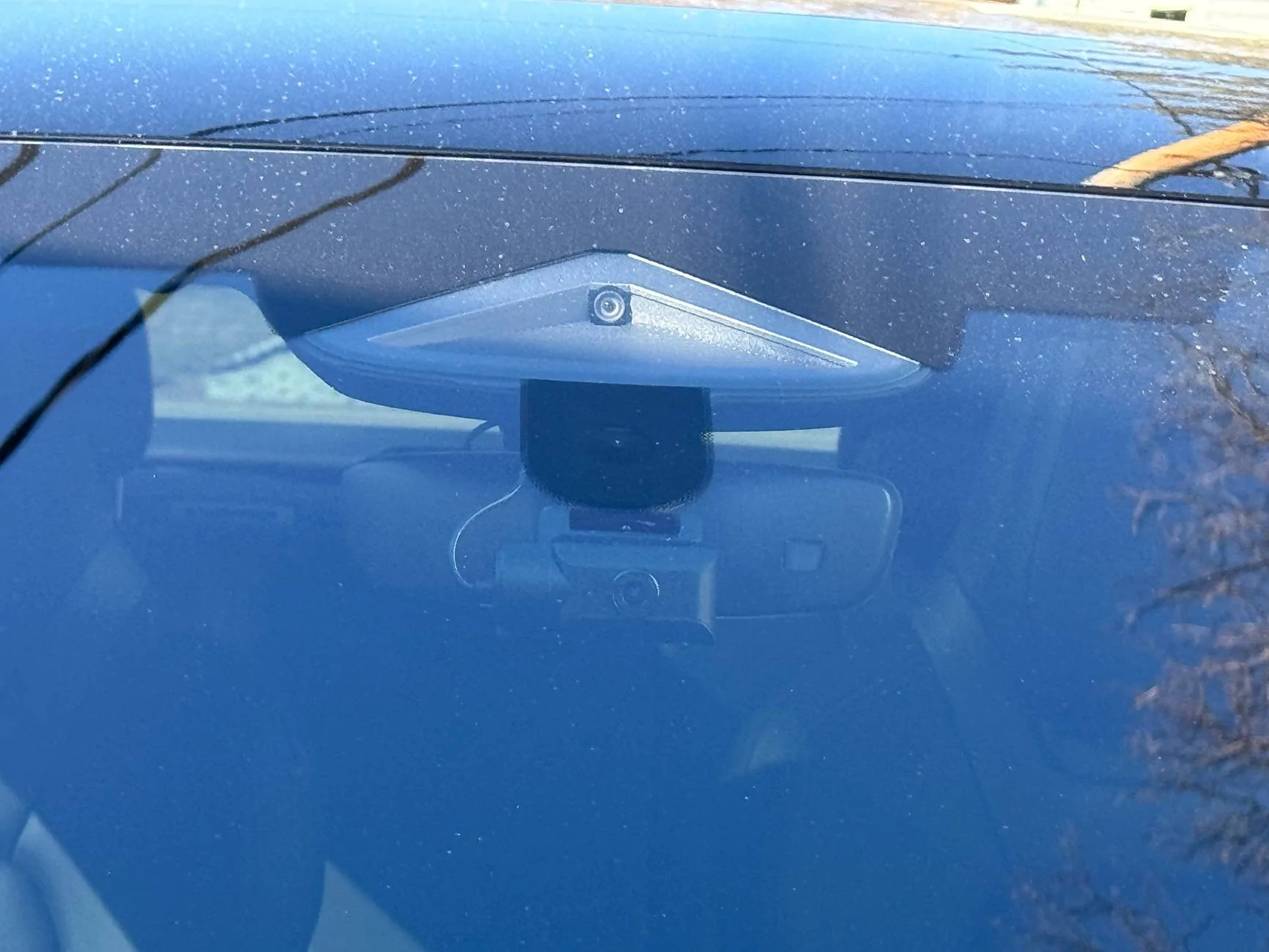

Wow clean install! Any more pics of the front? Just curious to see how much of the cord is able to be hidden vs say the fitcamx
Thanks
Here are a few more from other angles. It is not fully concealed. But my main concern was that is out of my view. And not drawing much attention in the first place and I think that is achieved.

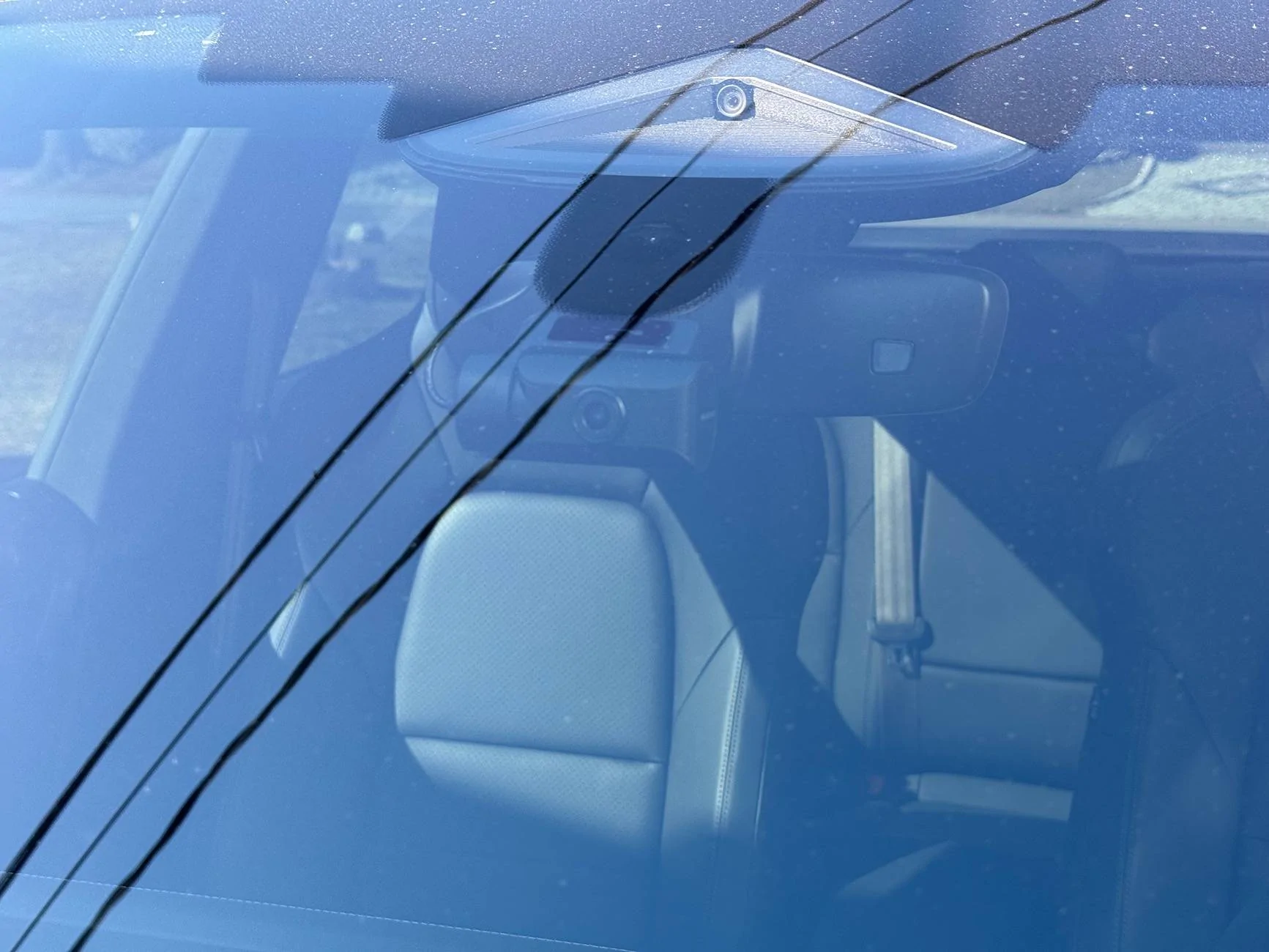

Here is my BlackVue install. 3ch front back and interior. Also with remote LTE and additional battery to take less of a strain on the interior. It also shuts off if needed when the voltage goes below 12V. To make sure the car will still operate just in case the dashcam depletes the interior.

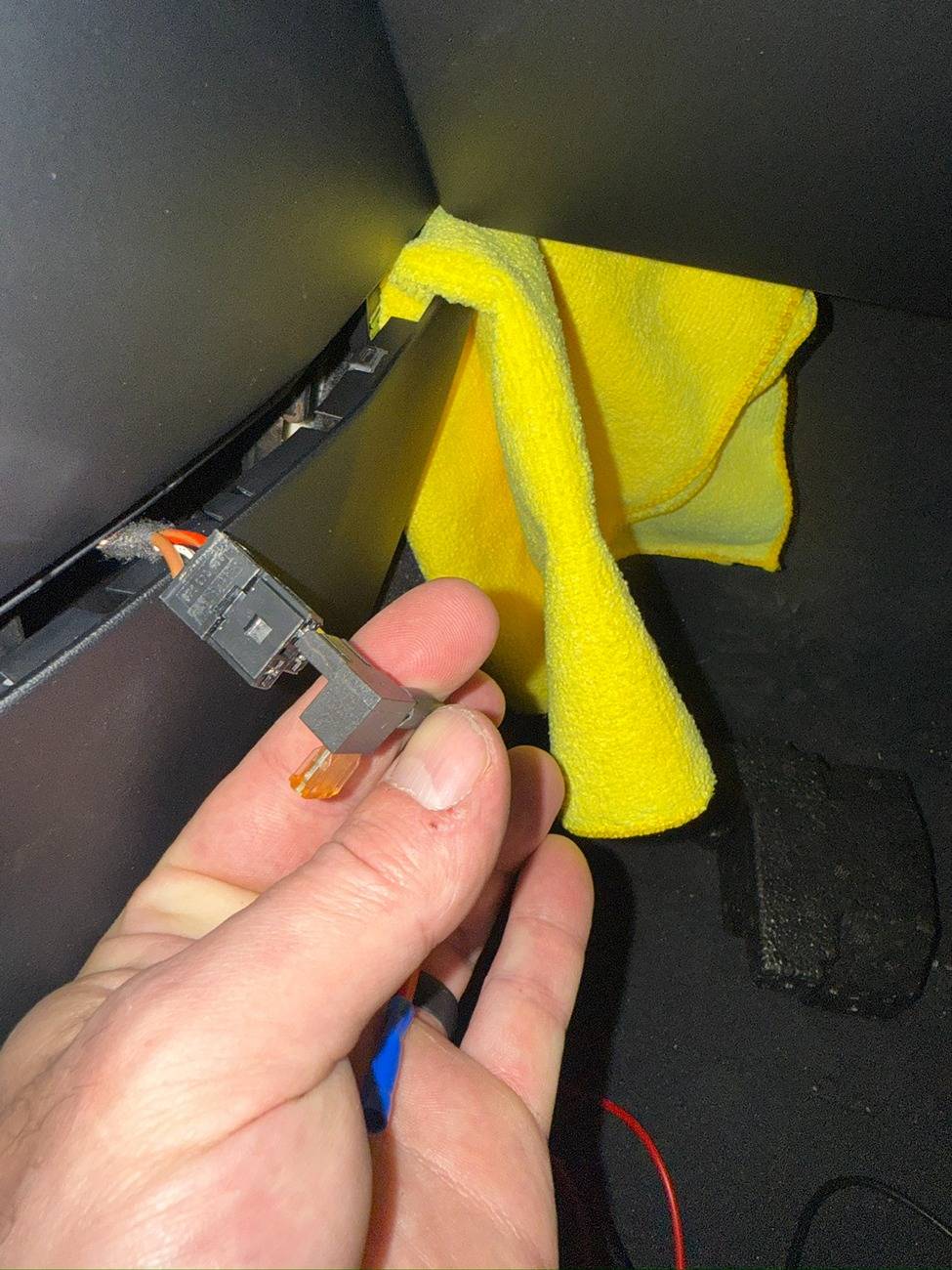

Posting my results so far. I found this thread when searching, so I want to post on the info I have discovered. I read too many posts about this and taycan forums for install of dashcams.
I am installing a Viofo A329 2 channel. I have no pre installed Porsche dash cam wiring, so I was on my own. My solution was to put the ACC wire on the cigrette lighter from the center console. I pulled it completely and hooked up the smallest fuse into the socket. I can post pictures if folks want it. I am testing the parking mode now, but I will be evaluating the behavior and will report back.

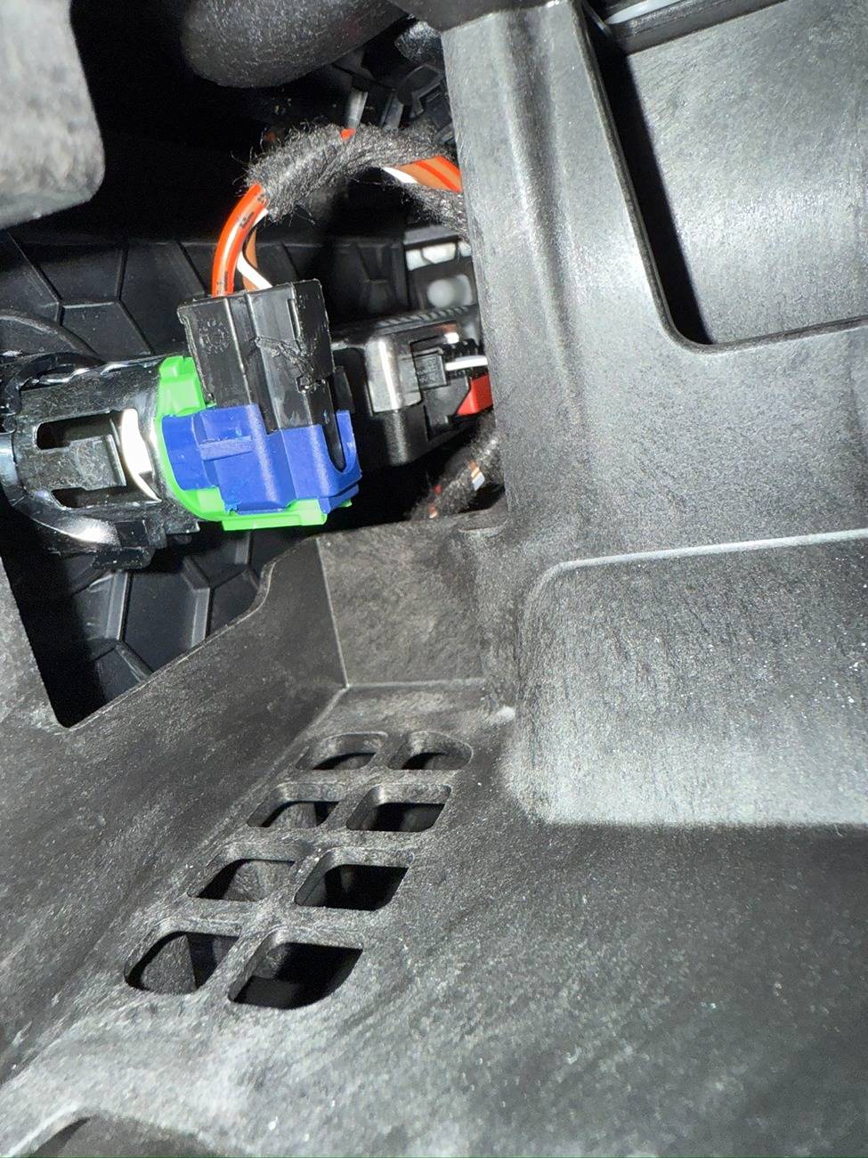

Some pictures of the wiring I did. I ran a long run over to the center console from the passenger fusebox through the loose fitting panels in the passenger footwell. Center console side plate just pops off and after removing a foam piece the plug for the cigarette lighter is accessible. It took some coaxing to get it to unplug (squeeze the black part and pull up). I used a smaller fuse that fit into the socket and zip tied them together. I don't plan on using the cigarette lighter ever, so I won't miss it. I may still go back later and splice in instead though.

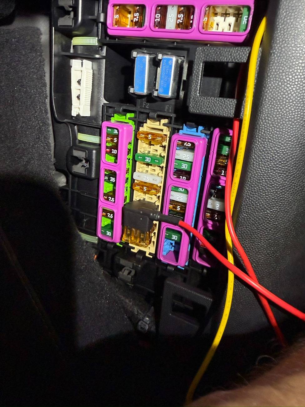

also here is how I wired my power in the fuse box:
Electric Macan EV Dashcam installation issues -- fuse box location? 2976F74B-DAA7-40E7-9767-5CD74B1B0D26_1_102_o
If the info we have on previous vehicles is correct, this slot is carrier 6 number 8 which may be the rear AC controls.

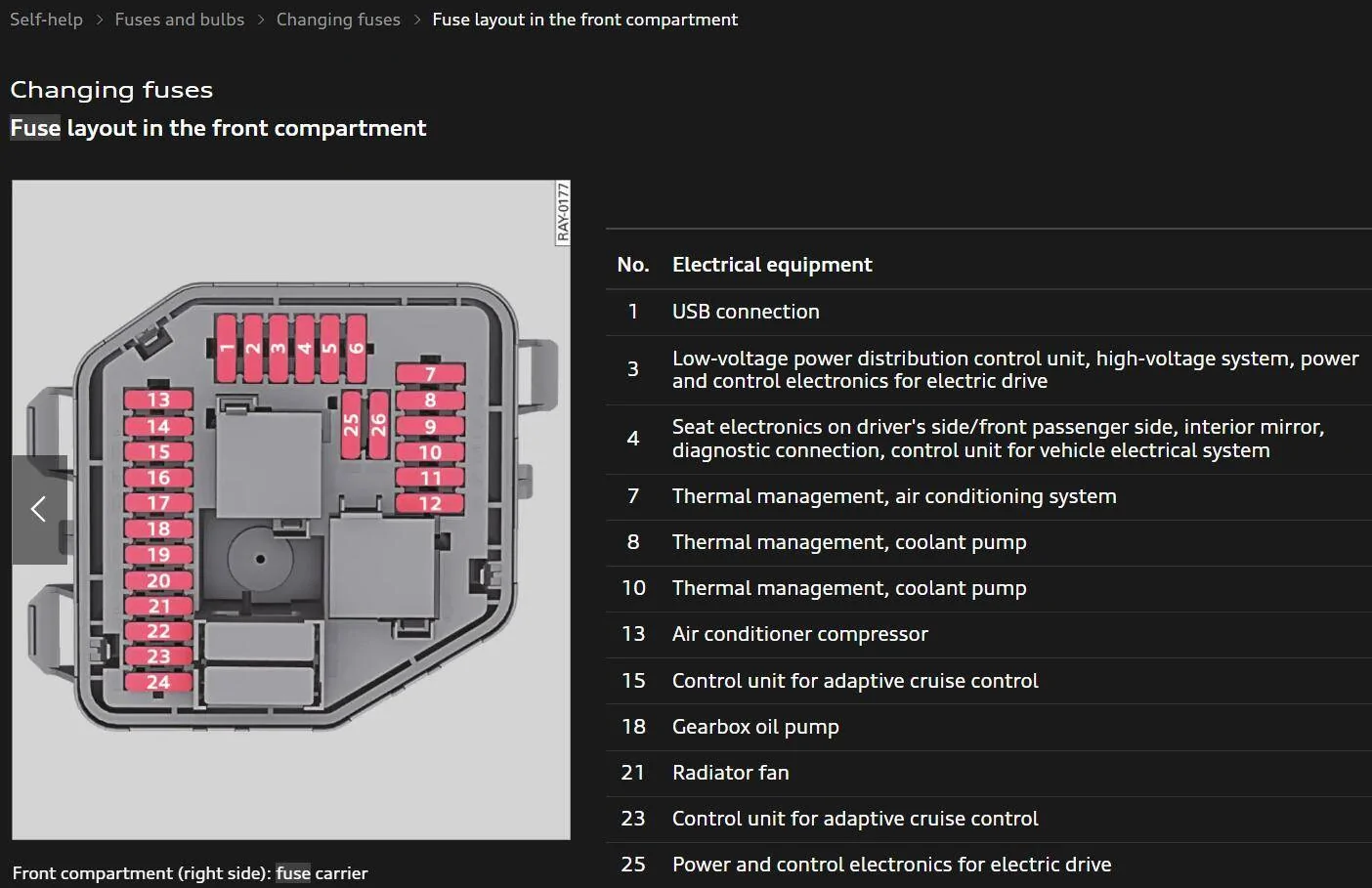

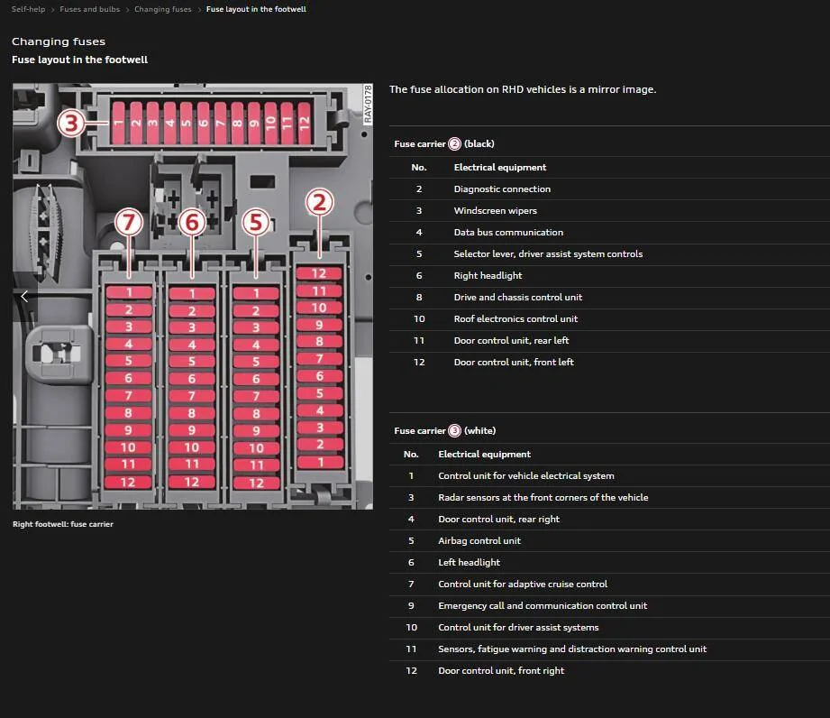

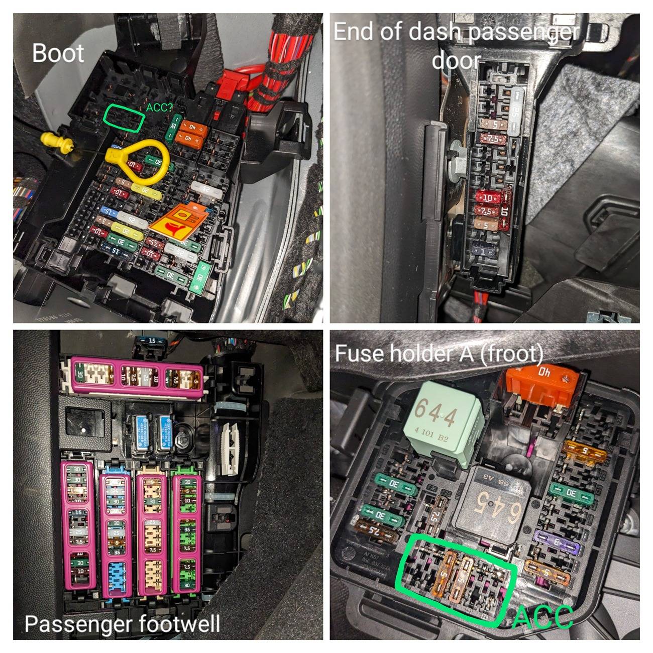

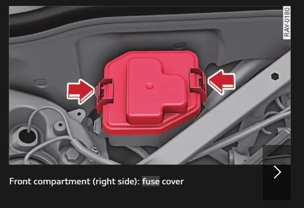

Thanks for the above fuse panel location! I managed to find it although its sadly not useful for fuse taps due to being in a sealed box and I cant see how you would run a wire from the front compartment to the interior?
As I see it a quick summary of the available fuse boxes below, note I have a RHD car:
  • Front passenger footwell: No switched fuses, except the single 15A fuse at the top which is always dead, not shown on Q6 fuse layout.
  • End of dash/passenger door: No switched fuses, entire fusebox is not shown in Q6 manual.
  • Froot: The bottom row fuses 1-6 highlighted green all show 0V when the car is not in the 'ready' state, so are switched, the dash cam wiring instructions from Porsche also state to add a fuse to slot 1 to complete the circuit here, and are therefore definitely ACC slots.
  • Boot: No switched fuses except for the two empty slots 50 & 51 highlighted green read 0V when the car is not in the 'ready' state, however when inserting a fuse tap I've found these remained live when the car turns off. So its switched to some extent but not like a conventional ACC slot - a bit more investigation needed maybe.
What I would like is to hardwire my A229 Pro with conventional fuse taps - its the easy way out but I want to avoid using wire taps on the 12V outlet in the boot or the dash cam pre-wire outlet in the roof (Note the Macan manual states the 12V outlets are switched off after 30 minutes to avoid draining the battery, and fuse 31 in the boot is still live when the 12V outlet is switched off).
Fuse definitions from the Q6 manual attached below which matches the Macan mostly (Macan has the additional end of dash/door panel and in the footwell fusebox the additional 15A fuse seen at the top - so we dont know what those fuses are protecting)
so you took the panels around the front center console off? would you happen to have a pic of that?
