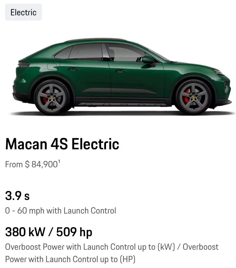

hmmm Macan 4S @ 509 HP is about the same as a 911 GT3 in terms of HP
Electric Macan EV How long would our batteries last on a track day? IMG_2597
380 kW "max demand" vs. 95 kWh fuel capacity
95 kWh / 380 kW = .25 hours - or 15 min of capacity at "full" power
now 380 kW is launch control - and we know you're not tracking in launch control mode - so the question is how much of the 380 kW capacity are you allowed at full throttle but not launch control -I'm going to SWAG 320 kW for "sports plus mode" - 95 kWh / 320 kW = .29xxx or 17.8 min of capacity at full throttle…and we can work backward from there knowing we're not at full throttle the entire time on track - but alternating between full throttle and full brake …
with out more data i can't estimate how long you can actually stay on track - but you have less than 3 gallons of gasoline for a 500 HP vehicle - it's not very long :p

Don’t forget to include the efficiency - only about 40-50% of your energy from gas goes into moving your car, the EV is going to be 90% or more.
If you multiply 115kwh burned for 9 laps by 40-50%, it used 46-57kwh to actually move that distance. The rest of that energy is just heat, hot gasses, etc.
Of course this is all back of napkin because that number will change a lot with vehicle weight and other things.

yeah it all gets muddy really really quick - but at full power you still need to feed 320 kW to achieve 500 HP - so at 90% efficiency you need 355 kW to get a raw 500 out of the EV motors.
so I think the math actually works the other way - the ICE is 25% efficient so to get a raw 500 HP you need 1280 kW worth of gasoline power…
but the main point is - if you're taking an EV on track - you've got less than 3 gallons of gasoline equivalent power to work with - I wouldn't expect my GT3 to run more than about 6-7 laps with 3 gallons of gas @ Laguna seca maybe even only 4-5 laps.
