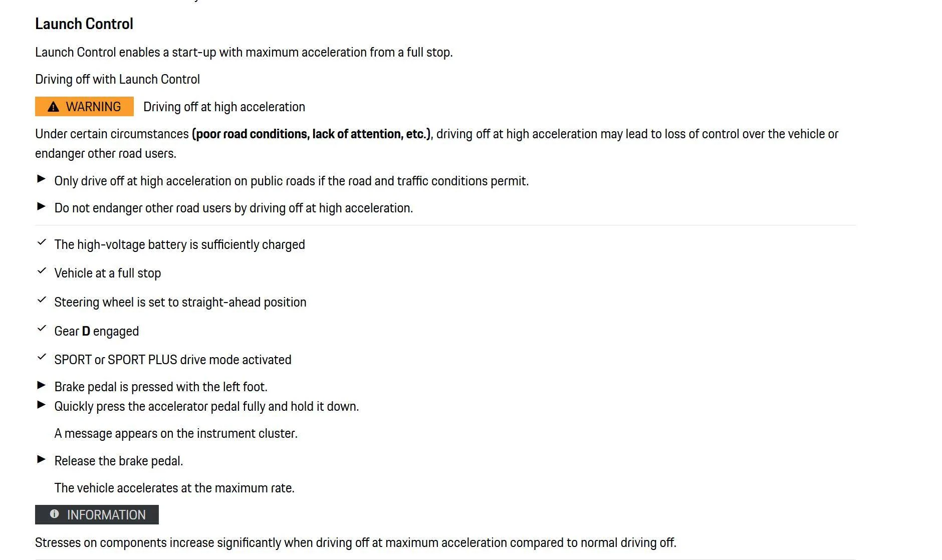

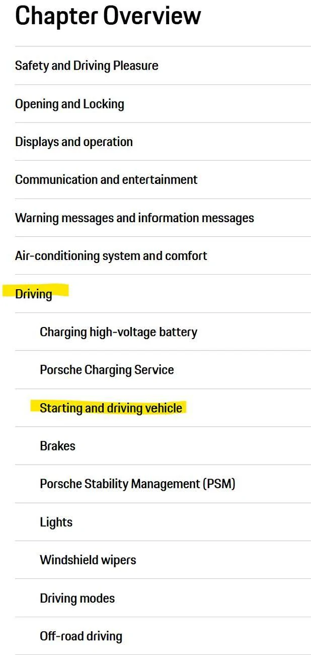

I understand the basic questions will come up, but have you considered reading the manual first before posting. Where did you search how to launch Macan EV and did not find how?
Starting and Driving vehicle section in the printed or online manual:
