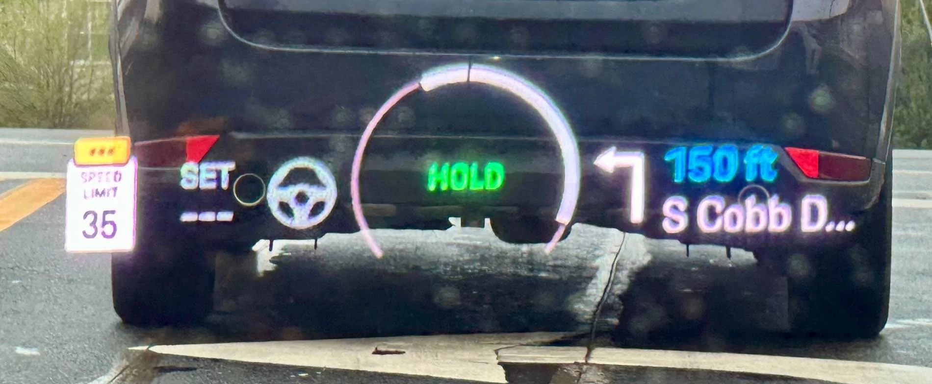

Does anybody know what the white outline on the center circle is? The light blue measures consumption during acceleration. The green regeneration. The white outline seems to “expand” to the left as you drive allowing for more regeneration when braking. But what does it represent?
regen capacity - max regeneration - when close to full or battery is cold less regen - by the time I'm below 70% SOC on the main battery I have way past 9 o'clock position on the regen bar (green/white) in the HUD - the “power” bar (blue/white) will also shrink as you get closer to battery empty representing less max power
